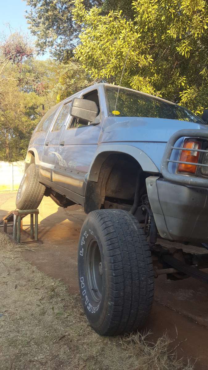

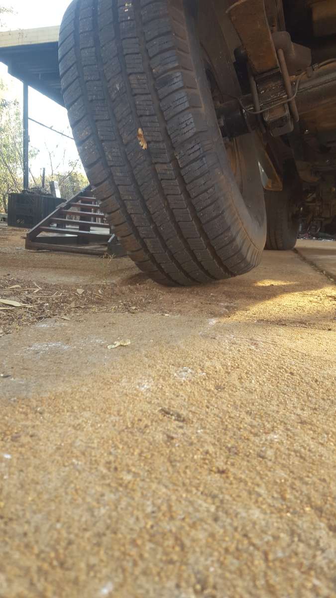

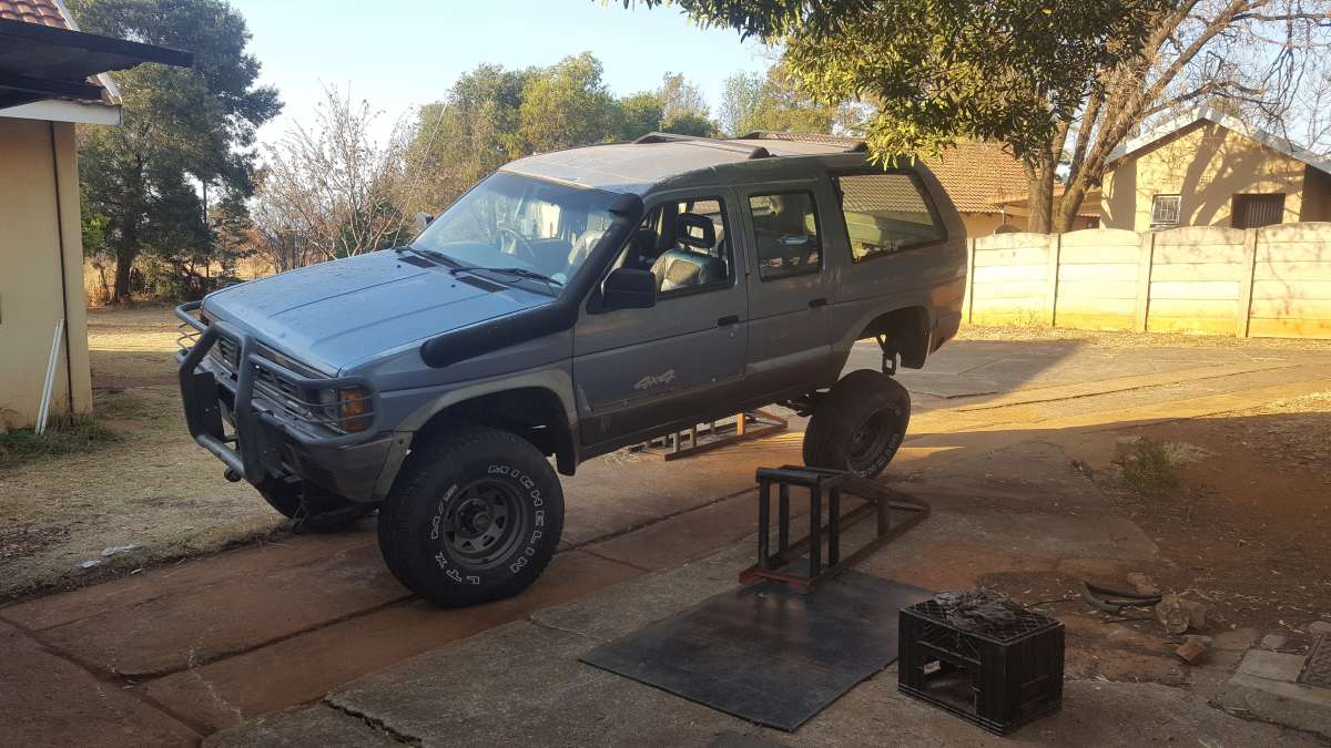

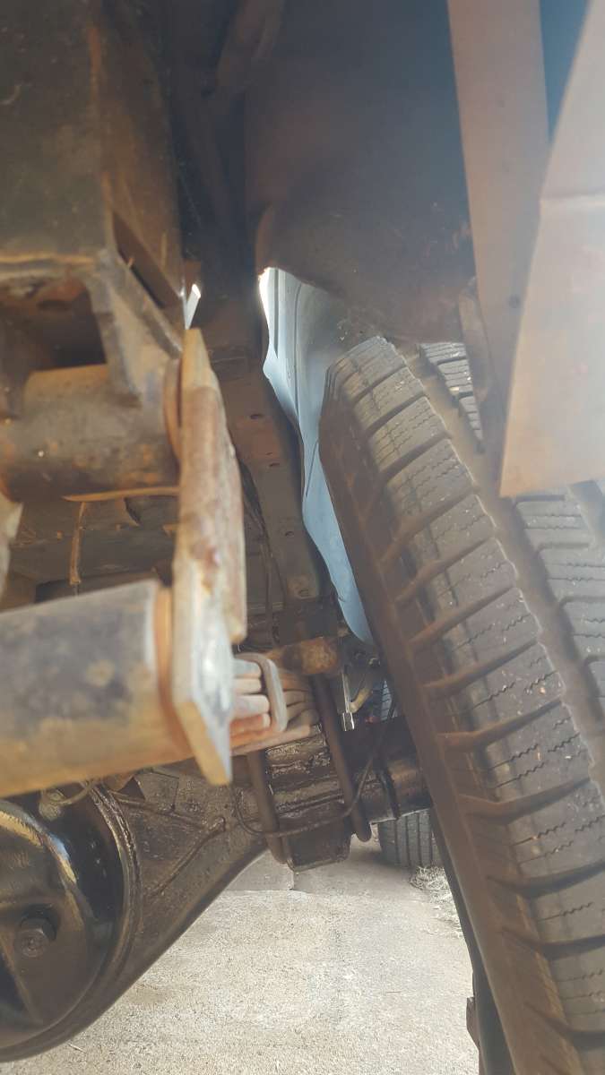

Update long coming I suppose. Sani I on the go again. Ran yesterday on it's own steam for the first time in over 18 months.
First thing I had to test, was the dual TC's in low range, and here is my crawler..

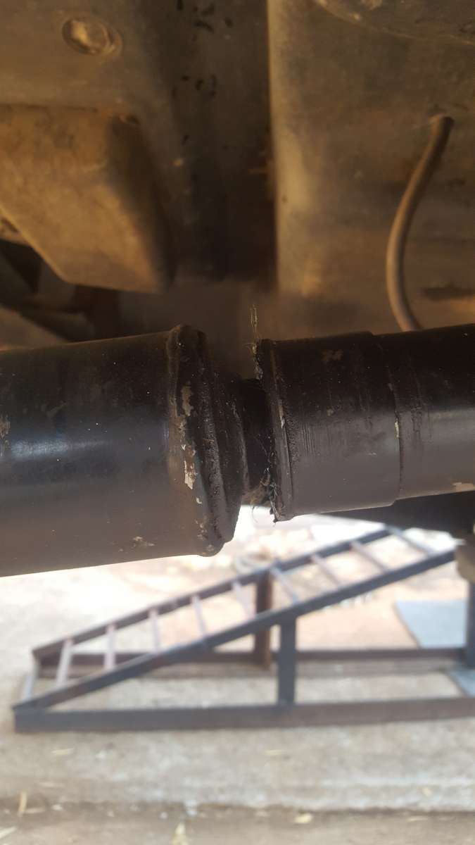

Checked some clearances on the ramp. Made sure I had enough left in the slip joint on the rear propshaft.
That old Safari LSD seems to be working great. It scuffs the tires on sharp low speed turns, and even feels like I am getting wind up on the rear (front propshaft not in yet). Cruised straight up my 500 high ramps in 2wd, which I could never do before, even though my articulation is rubbish at the moment, and my front sway bar is connected. Still not to bad flex, but the front end is very tight.
