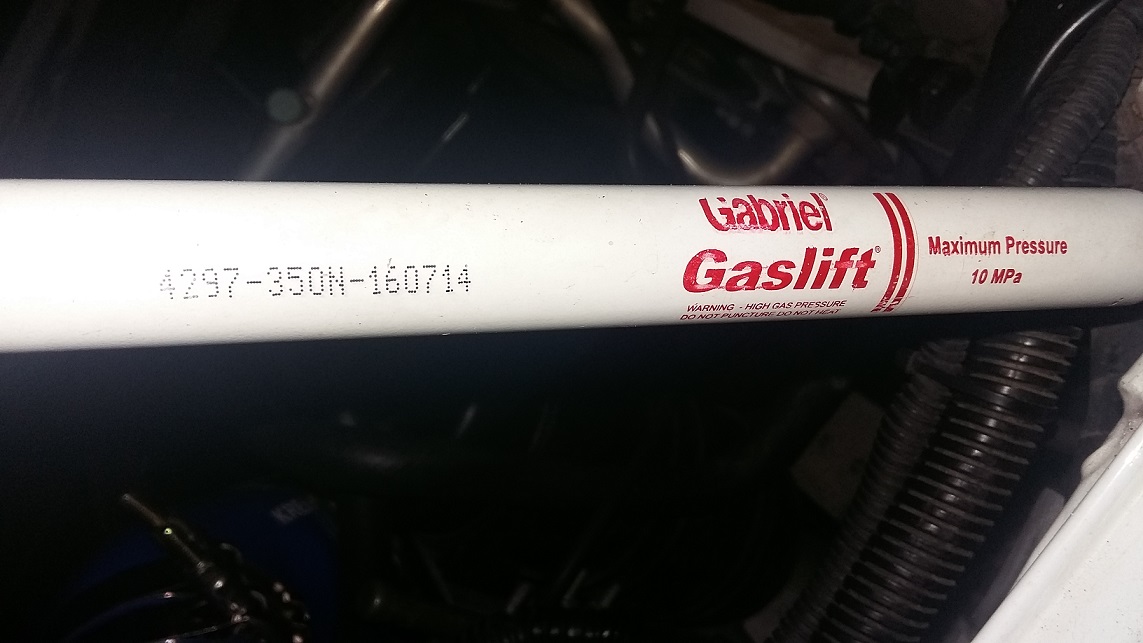

The gas lift are super easy to install.
The Patrol had Gabriel 4297's on, which have a M6 thread on the ends.
I went for Gabriel 4141's like Michael and had them pumped to 400Nm.
The thread on the 4141's is M8, so you'll have to buy the end fittings too.

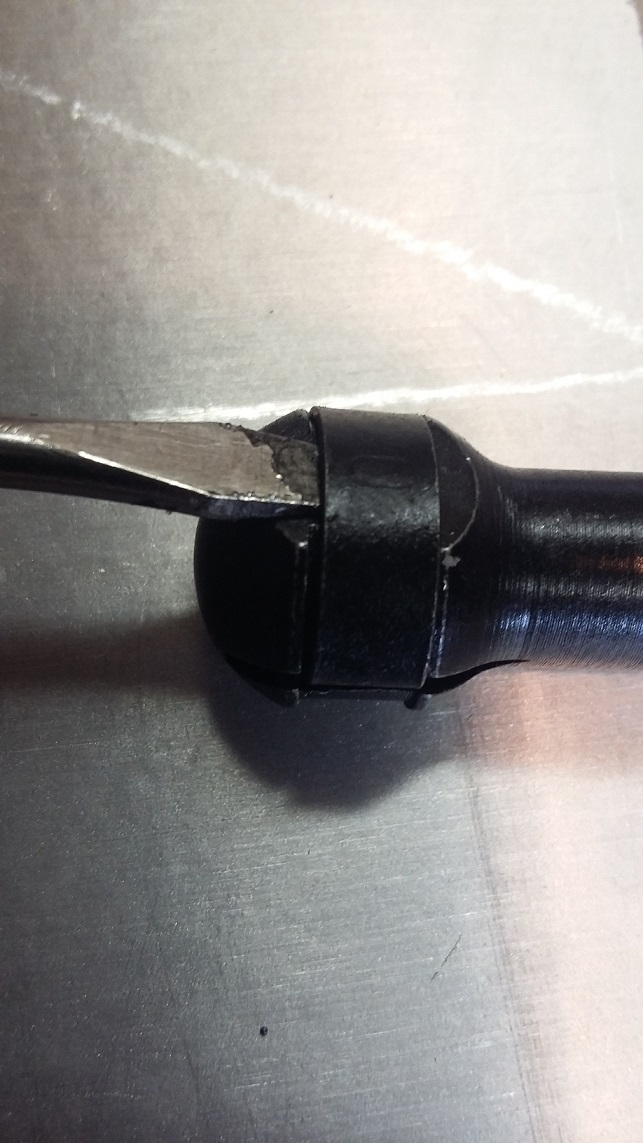

The process is take a small flat screwdriver and put it under the spring steel retainer clip and lift it up.
It will allow the ball joint to separate easily.

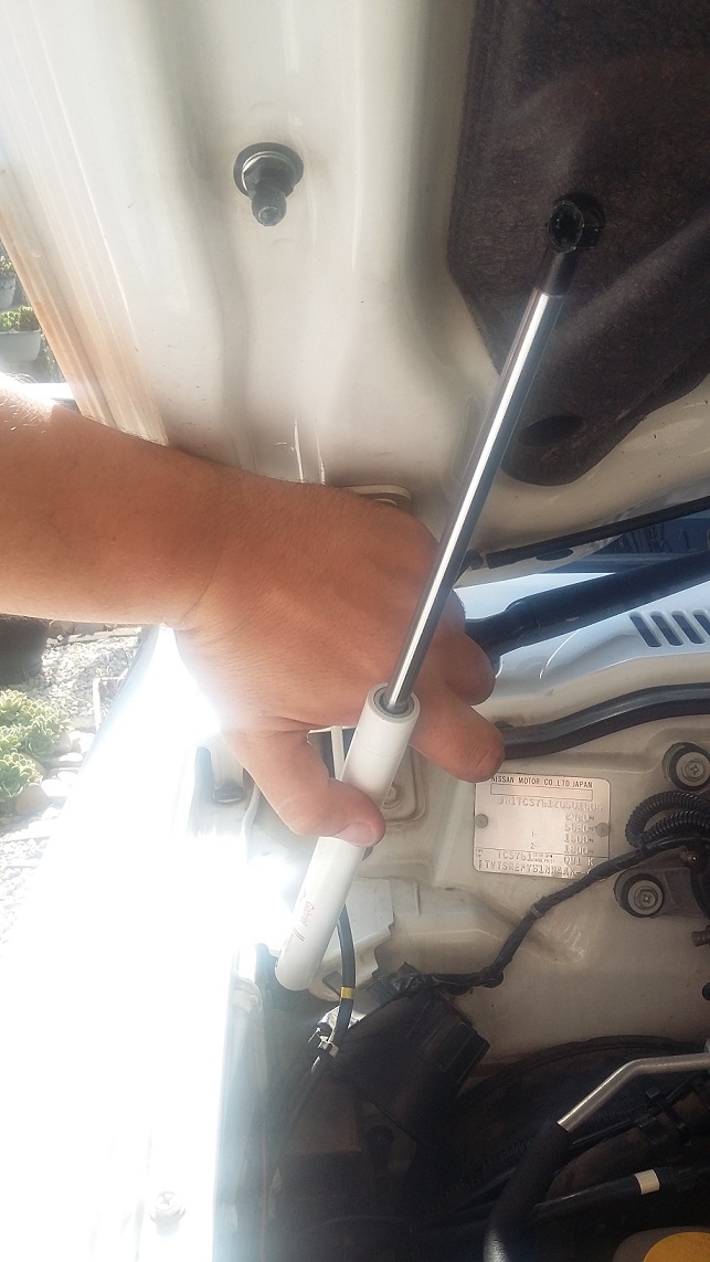

The ball ends on the car screw out and screw in the new ball ends for the 4141's.
Then it's just a case of clipping the new gas strut in onto the ball ends, just place them on top and give a quick press for them to clip in.

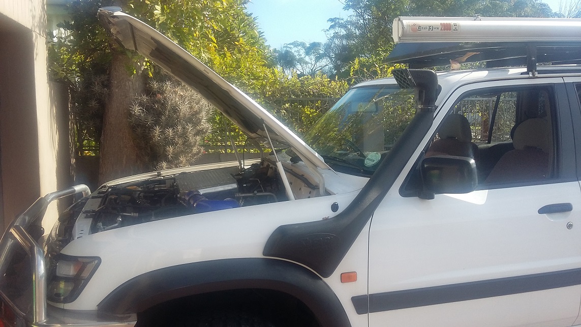

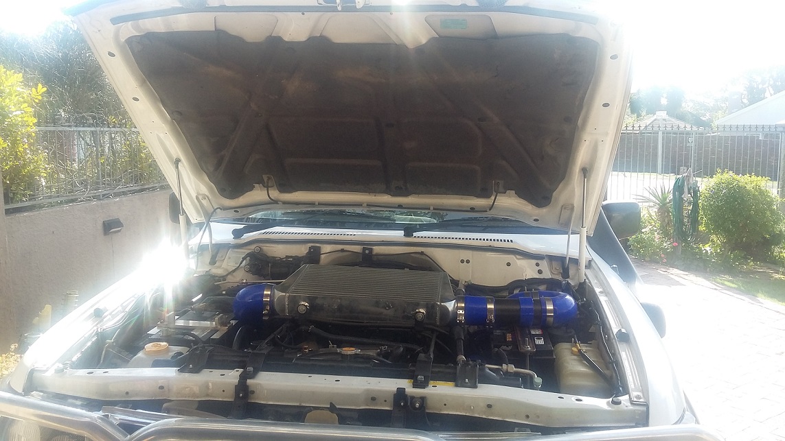

Now the bonnet opens much further than the old 4297's

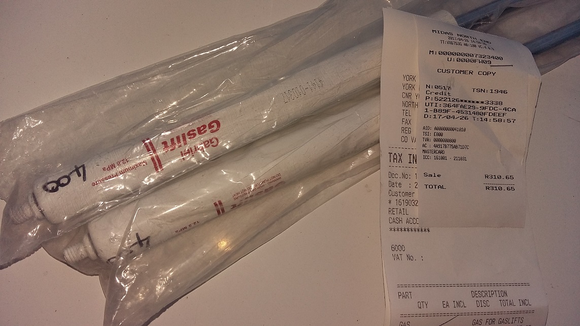

Costs :
2X Gabriel 4141 gas lifts pumped to 400Nm - R310.65
4X End fittings for 4141 gas lifts - R140.00
Total - R 450.65 all from Midas
