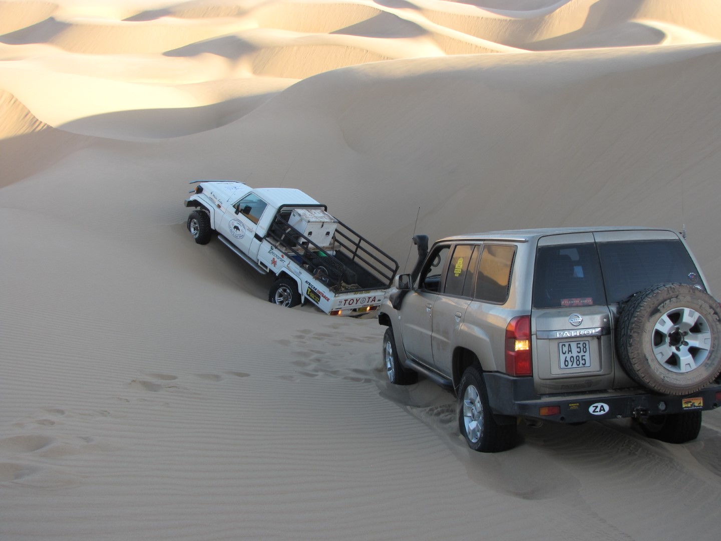

Came across this pic to explain the setting I was talking about. Actually only needed a light pull/snatch...
