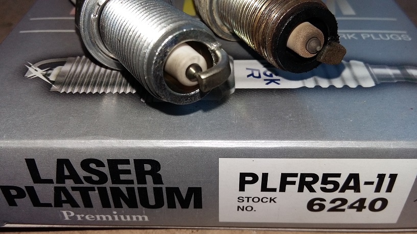

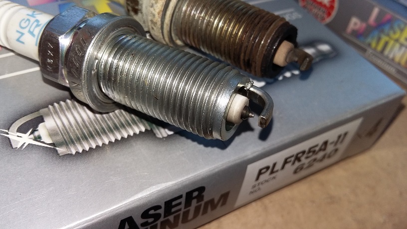

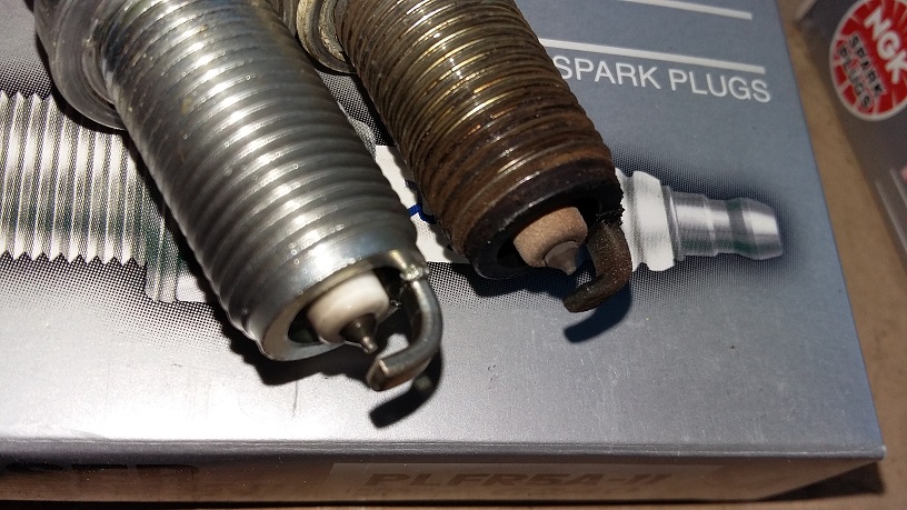

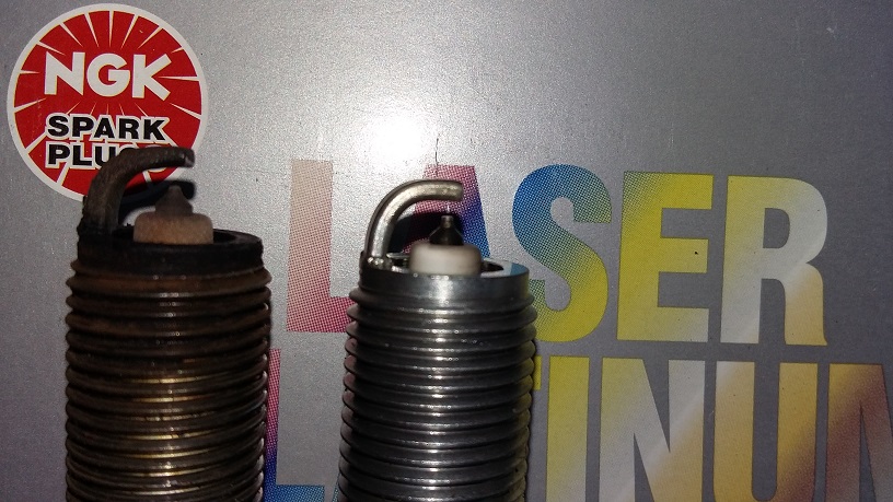

100k Km later...4.8 still purring like a kitten I decided to pull the plugs again
Here are the results:
PLFR-5A-11 (1).jpg (161.26 KiB) Viewed 4613 times
PLFR-5A-11 (2).jpg (164.36 KiB) Viewed 4613 times
PLFR-5A-11 (3).jpg (143.79 KiB) Viewed 4613 times
PLFR-5A-11 (4).jpg (160.79 KiB) Viewed 4613 times
Gap grew by only 0.03 mm over this distance. I didn't replace any gaskets - just reused the old ones
