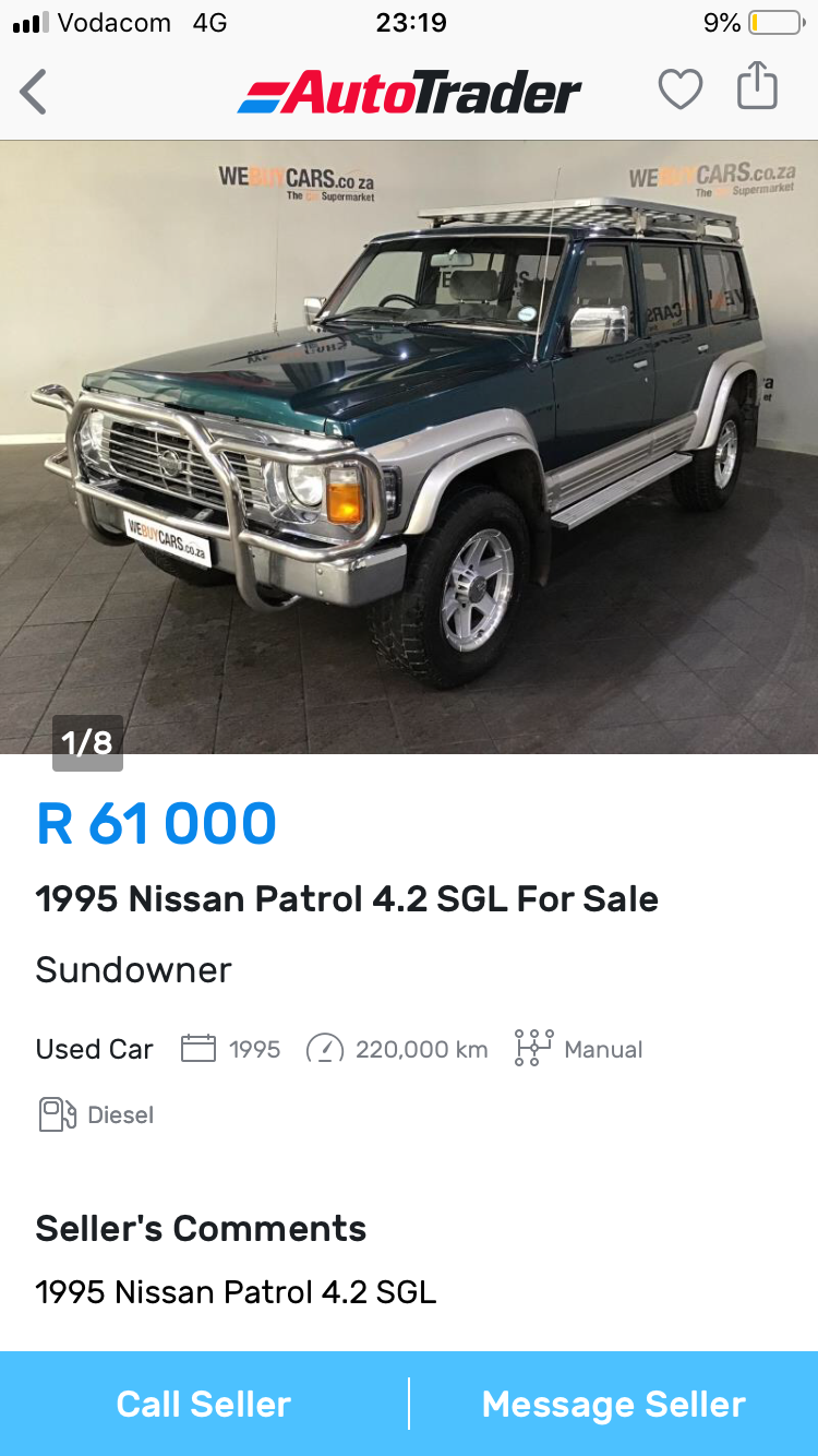

If someone is aware, or becomes aware of that shape Patrol, please be as kind as to let me know. I am very keen to buy one of those, preferably a stock standard TD42 with reasonable milage. I attach a picture of the one I was considering now. I thought it was looking quite good and I love the color schemes.

Depending on the use you want to put the vehicle to, my advice may be exactly the opposite. For the following reasons:
1) It is now almost impossible to find carb kits.
2) I doubt there are more than a handful of guys left who can re-build a carb properly once worn.
3) The same applies to the distributor.
Fuel injection specialists are a dime a dozen, and some of them really know what they are doing. A well set-up fuel injection system is superior to a carburettor in every way.
If you want it do do trails and the odd longer trip in SA, I would consider the fuel injected car. However, before buying this I would want to test it extensively. I would do things like an oil analysis (costs less than R500 and tells a lot about engine health), get it on a sophisticated exhaust gas analyser on a dynamometer to check air-fuel ratio under no load, light load and heavy load conditions, and make sure it doesn't over-heat, and that the water system doesn't have any signs of rust. Oh, and if possible, take it through a deep ford.
On the other hand, if it is to be used as an overland vehicle, I would look for something else, or at the very least make sure the electronics are very well sealed and I would also carry a spare ECU, already programmed.
Once again, just my opinion.
