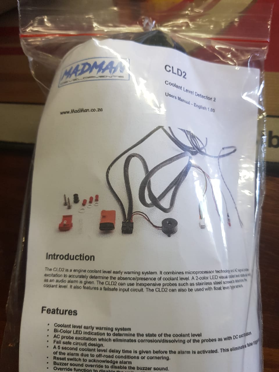

Decided I'd order the Mad Man coolant level sensor kit. I originally contacted Mad Man directly, but they referred me to Performance Products (www.performanceproducts.co.za).
The cost was R770 with R138 delivery. I placed my order on 4th January, and received a notification that Performance Products would only be open for business again on 7th January. However, my package arrived yesterday. Sort of happy with that.
I'll post on installation when I get around to installing it over the weekend.
