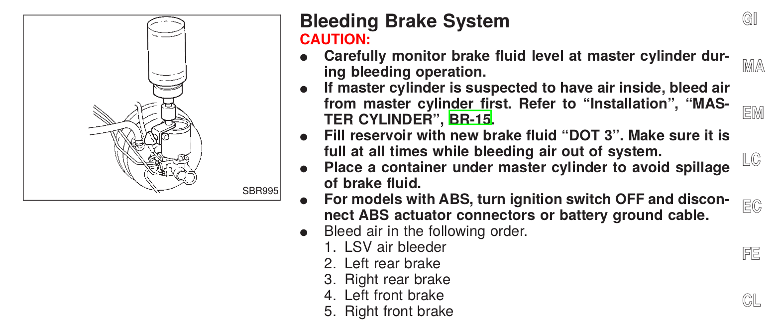

Re: Brake pedal feel different on first brake application
mvcoller wrote: 14 Nov 2018 10:47 Start bleeding at the furtherest point from the reservoir and work your way to the closest. That is the correct order. Much easier way to remember the bleeding order!
I checked the manual, and it is as I outlined in my earlier post.
1: Load sensing valve (LSV).
2: Back left.
3: Back right.
4: Front left.
5: Front right.
The LSV is not the furthest point from the reservoir.
