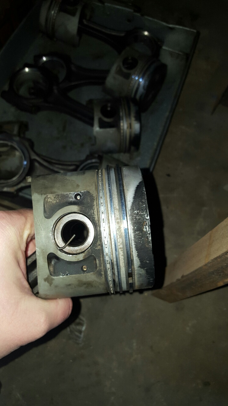

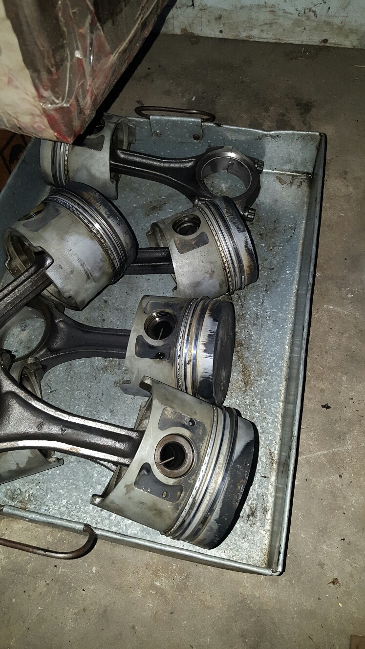

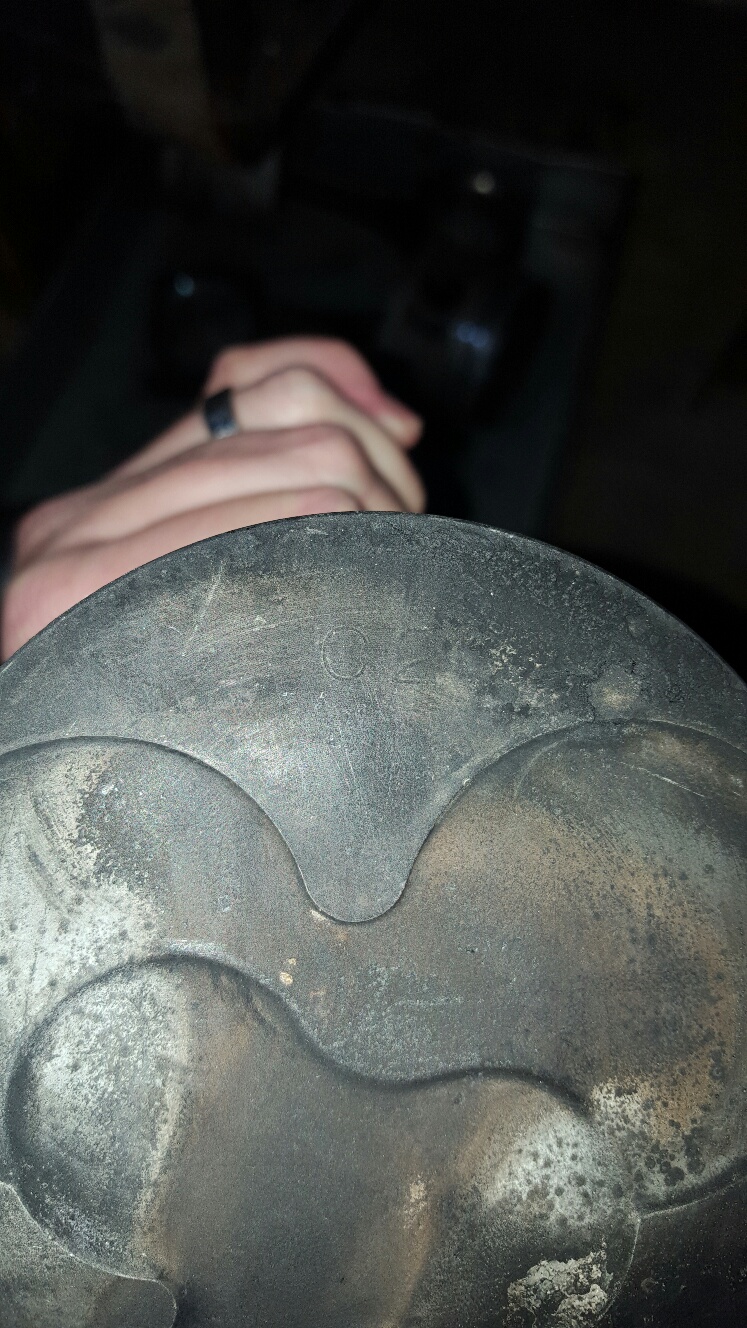

Here is pictures of the pistons that I took out of my TD42. Looks the same as the piston second from right on Michael's post.
- 20170721_103326_resized.jpg (259.42 KiB) Viewed 7652 times
- 20170721_103315_resized.jpg (419.04 KiB) Viewed 7652 times
- 20170721_103217_resized.jpg (480.12 KiB) Viewed 7652 times
- Been thanked: 432 times
Re: Td42 Silvertop engines
I fit the pistons on the right hand. These are the strongest pistons available and have the cooling ports in the piston head to ensure the piston does not over heat.offroadbiker wrote:So..... if you now re-build an engine what is it that you are going to fit to ensure it is the best/strongest?
The pistons second from left I also use as they are also turbo pistons with alfin incerts, but obviously first prize are the ones on the right
Rudolph, ja daai kyk net soos die silvertop pistons wat ek hier het
