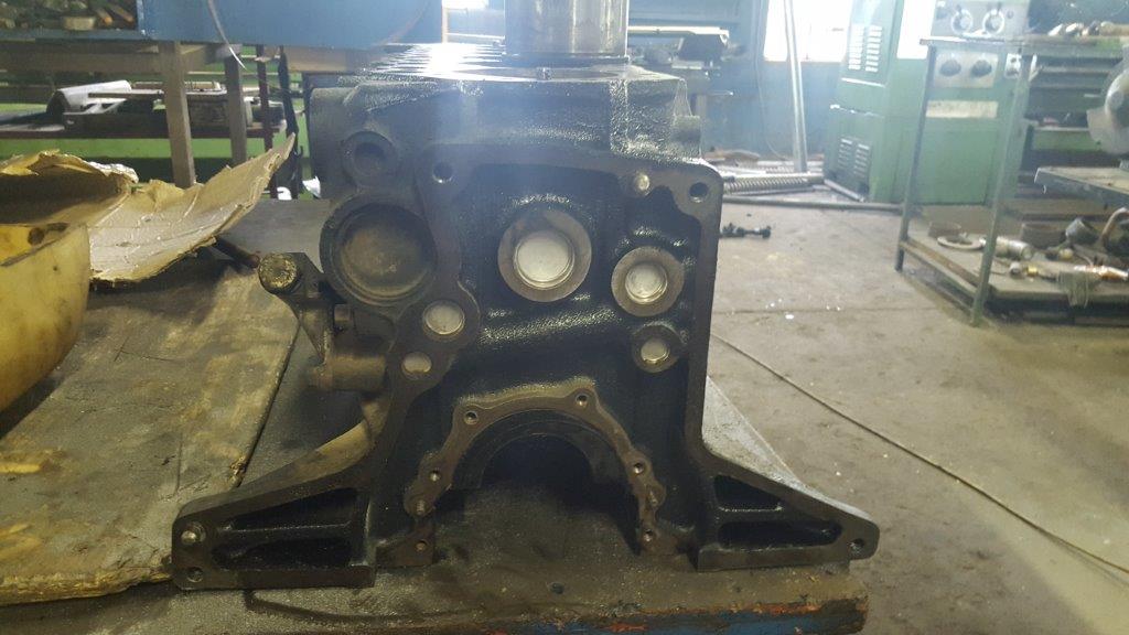

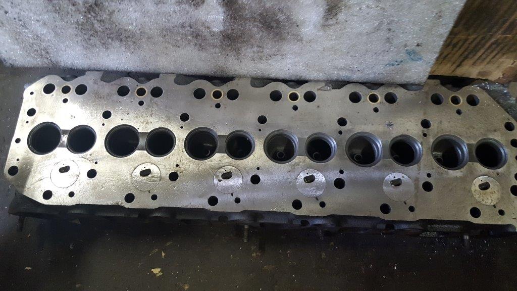

- Head coming on nicely
- 20170825_102105.jpg (100.82 KiB) Viewed 10361 times
- Stainless steel welch plugs, still looking great!
- 20170825_102033.jpg (83.28 KiB) Viewed 10361 times

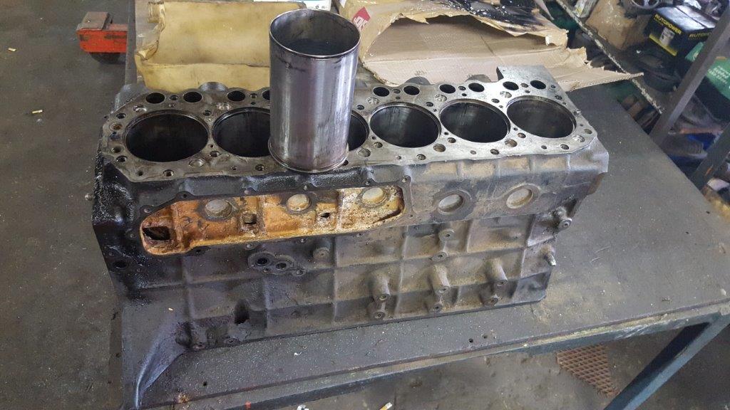

- Old sleeves out, time for new ones
- 20170825_102012.jpg (105.15 KiB) Viewed 10361 times
