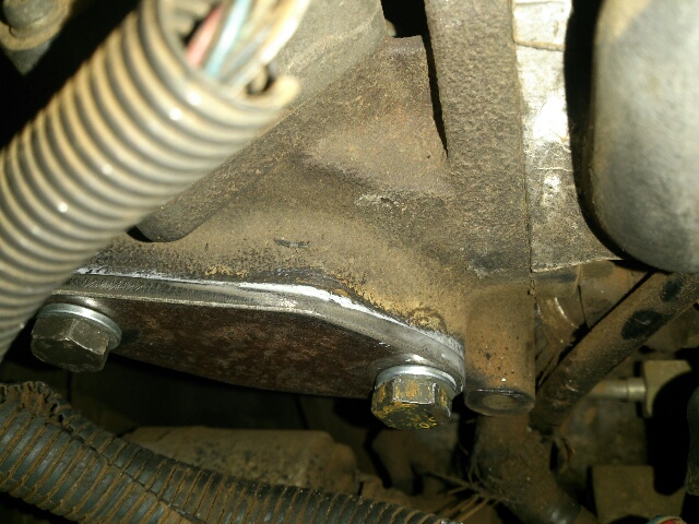

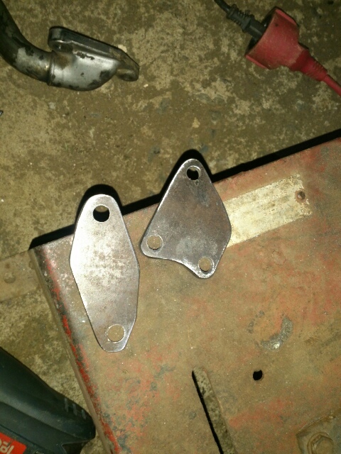

- Egr valve afgeblok.
- tmp-cam--379047277.jpg (147.34 KiB) Viewed 4891 times
- Die afblok plaaitjies.
- tmp-cam--638973047.jpg (148.41 KiB) Viewed 4891 times

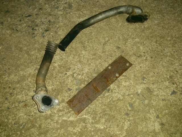

- Die egr pyp
- tmp-cam-1999545022.jpg (180.6 KiB) Viewed 4891 times

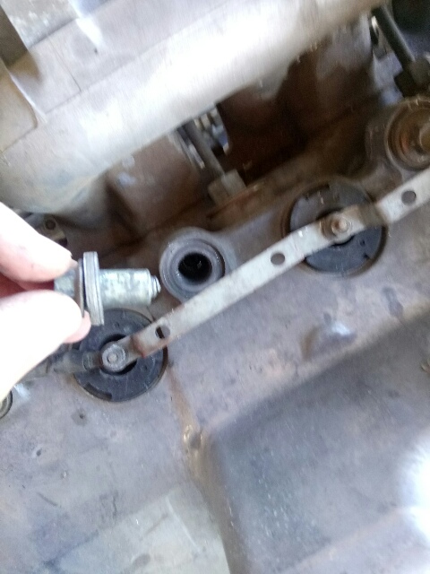

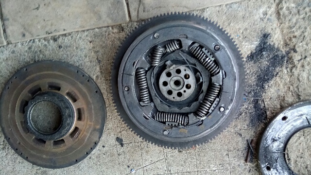

- Die vere het hom erg geskuur so hy was lank al stukkend.
- tmp-cam-598891879.jpg (156.47 KiB) Viewed 4891 times

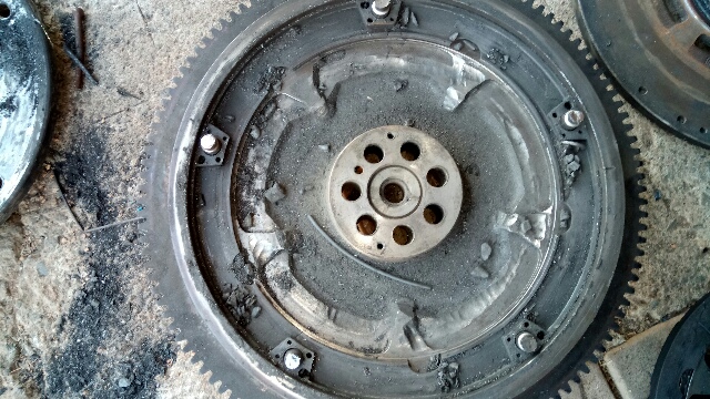

- Flywheel se binnekant.
- tmp-cam--774457167.jpg (149.66 KiB) Viewed 4891 times

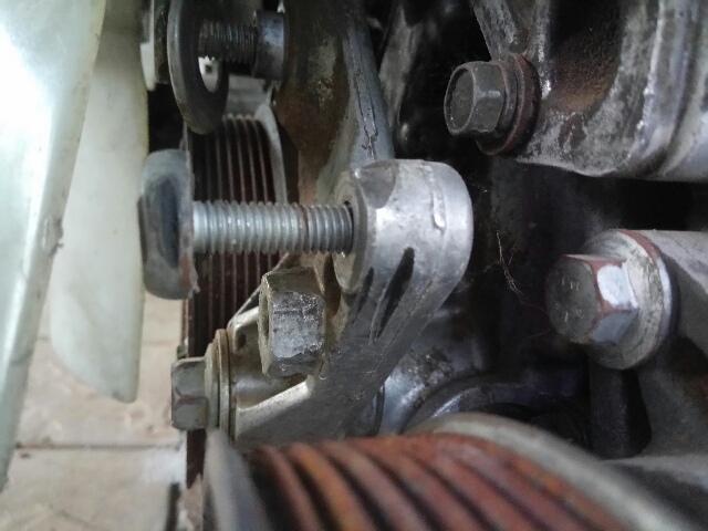

- Tensioner bracket wat teen aircon pully geskuur het op n stadium.
- tmp-cam--1606322361.jpg (114.4 KiB) Viewed 4891 times

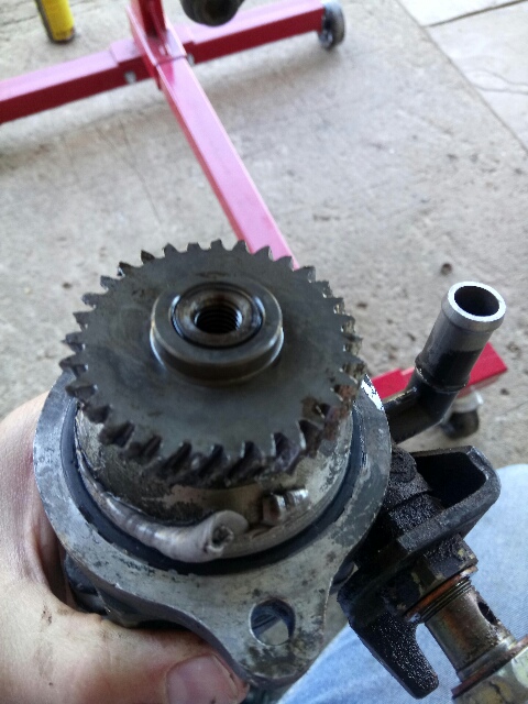

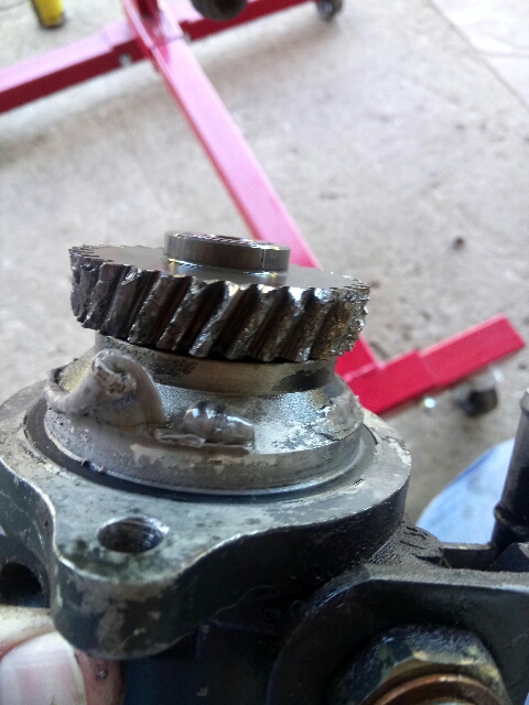

- Kragstuur pomp.
- tmp-cam--2039177316.jpg (130.95 KiB) Viewed 4889 times
- Kragstuur pomp.
- tmp-cam--317902957.jpg (122.22 KiB) Viewed 4889 times

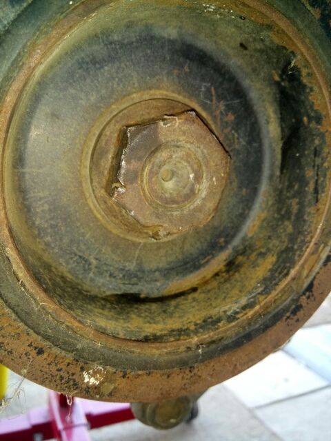

- Crank pully moer.
- tmp-cam-1348847800.jpg (144.37 KiB) Viewed 4889 times

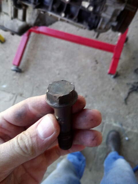

- Flywheel bout.
- tmp-cam--2106477930.jpg (101.25 KiB) Viewed 4889 times

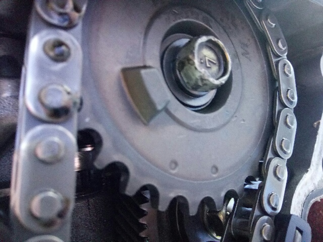

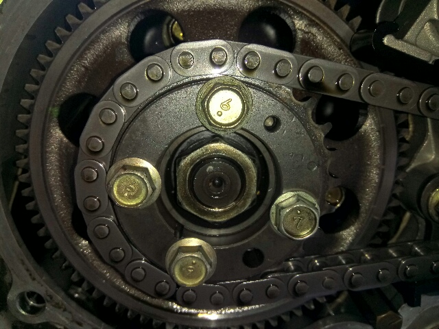

- Cam sprocket.
- tmp-cam-1365499122.jpg (142.28 KiB) Viewed 4889 times

wow that really is bad, those crank and cam bolts are really well rounded and would need to be replaced with OEM ones if possible. Cant believe someone would mess up an engine like this with such bad workmanship, it looks like they tried to use a hammer and chisel to loosen the crank bolt?
