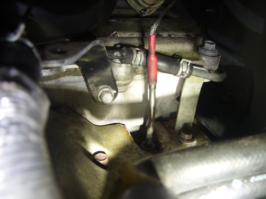

Many thanks for all the replies. I checked the temp this am and it reads 23C before starting. I will try a few things Tinus before I reset the unit. I dis check the set up and its set for a K probe. David, thats a very interesting point. I measured the probe sticking out and from the feral to the first lip at top of the probe, just before the red stuff, is 6.5 cm. See attachment. It does feel very secure though and I could not move it at all not that means everything. I did check the integrity of the joints, ie probe to madman wires and they also seem secure. I spoke to the guy in Durban who fitted it and he agrees with Michael that the probe could be faulty. He said to check other functions and they all seem to be ok although I have yet to install the water level (which I got from Brian) and turbo boost sender that was not available from madman when I was last up in Joeys.

To me it looks like that probe has started coming out. You can see where the original old burn mark is, that marks the original center position of the airflow in the manifold port. I think you got two lengths, 90mm and 120mm (speaking under correction). Either way, that would leave less probe inside the port than outside. Problem now is to get it back into the ferrule. Once you take to it with a spanner, you never seem to get it tightened up again to hold the probe. Actually, once it has let go once, it will do it again and again. I used to bash mine back with a shifting set to just fit over the top, but would let the wire come through the gap between the jaw. then take to it with a small hammer and bash it till it hits the bottom of the manifold.
Don't take my advise on this method, I just had to do my first fix when the probe came out all the way on the road, and left a place for a lot of noise and flame to come out at full boot. Hence the hillbilly fix.

Thanks David. I must admit when I looked at it I wondered if the darkened part of it used to reside lower down. The guy who installed in Durban said he was extremely busy at the moment, so I might just try out your '' Hillbilly method''. When you say it will always pop out again, can it not braced in some way? I am planning a trip after the hols and dont want the probe to pop out.

Barry, I agree with David. It does seem like the probe has pulled out a bit.
The top nut on the probe can be loosened and you should be able to wiggle the probe out without damage. It has a farrel that shrinks atound the probe when tightend and you can order a replacement one from Madman.
The probe should be pushed in all the way untill it touches the other side of the manifold and then you just pull it back about 3mm so it just doesnt touch it.
Hope that helpes
Hope that helpes
Re: EGT
The censor part is about 15mm from the front of the probe def look like that part is above your manifold ....good luck
