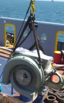

Allbilt wrote:The first few measurements done...
And this is the turbo ordered to give it a bit of extra oemf
