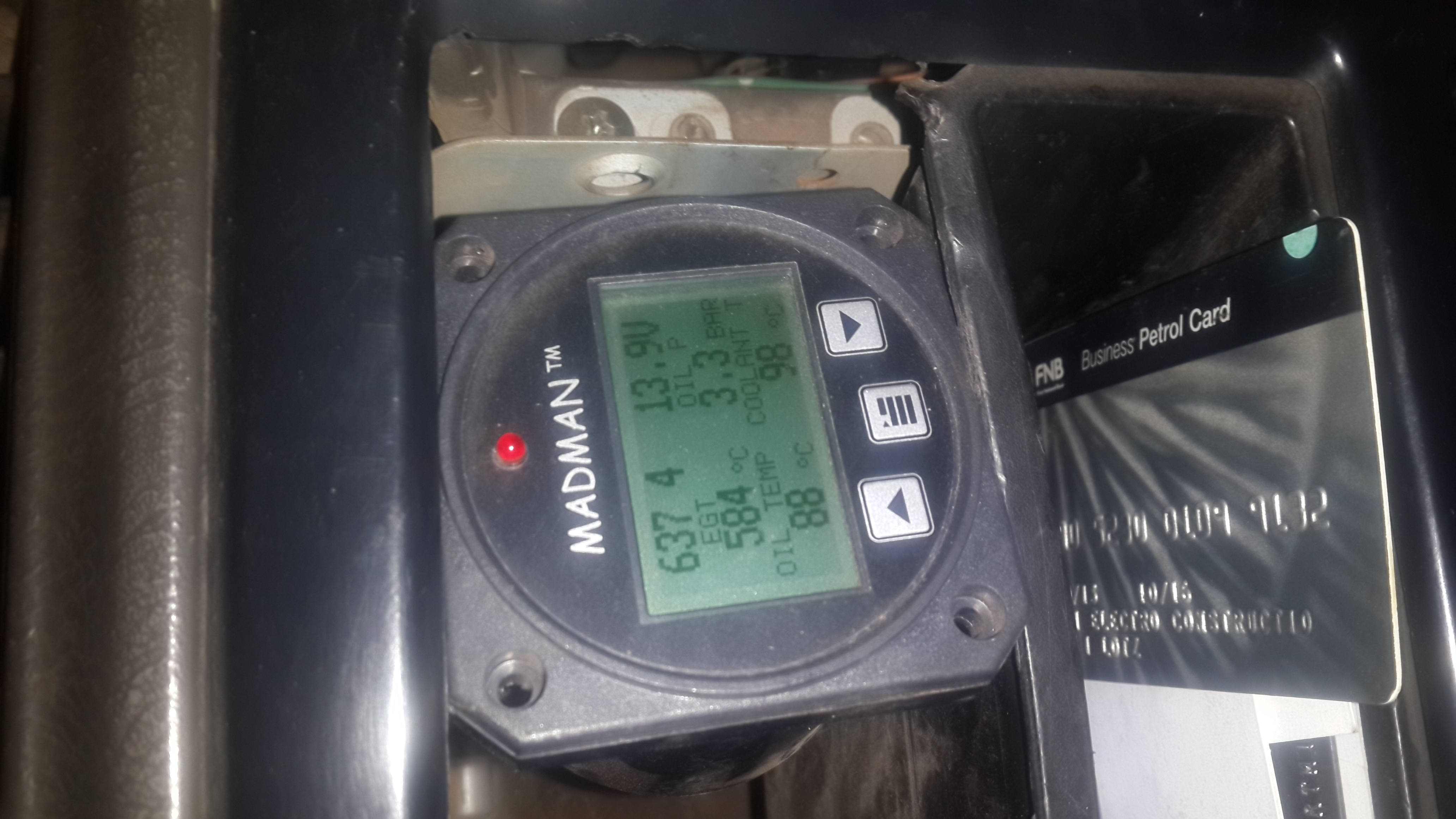

Yeehaa - the radiator is in! And also the new RF wheel bearings and seal that I've been meaning to fit for the past year or so...
The aluminium radiator probably weighs only a third of the old, fat copper monstrosity. If nothing else, I'll save a lot of weight.
I'll reset my Madman stats and take it for a spin tmoorrow. We've got a nice 37 deg C forecast for Pta, so it's going to be a good day for testing :thumbup:

The boost is an area which Im not 100% sure on.....specially on a standard originally N/A engine. The pump should be able to deliver enough fuel to boost 1.2 bar, but the pistons are my concern. I actually dont know how much punishment they can take as they were not designed for a turbo.
Im have another td42 (original NA) engine here that I have stripped where every piston has cracked on exactly the same place which indicates that they could just not tollerate the extra heat and preasure from the turbo.
In the engine's defense there was no madman fitted so its hard to tell if it was heat, preasure or both that killed the engine.
Been thanked: 432 times
Re: Radiators... Copper vs Aluminium
Having said that Christo, I think the main killer of a td42 is high EGT's. Personally I dont want to take a N/A engine over 600 EGT's and a rebuilt engine with turbo pistons over 670.
So its a hard choice on your side to get to the ideal EGT's, turn the boost up or turn the fuel down. Turning the fuel down is never a happy moment for me as you loose quite a bit of ponies
