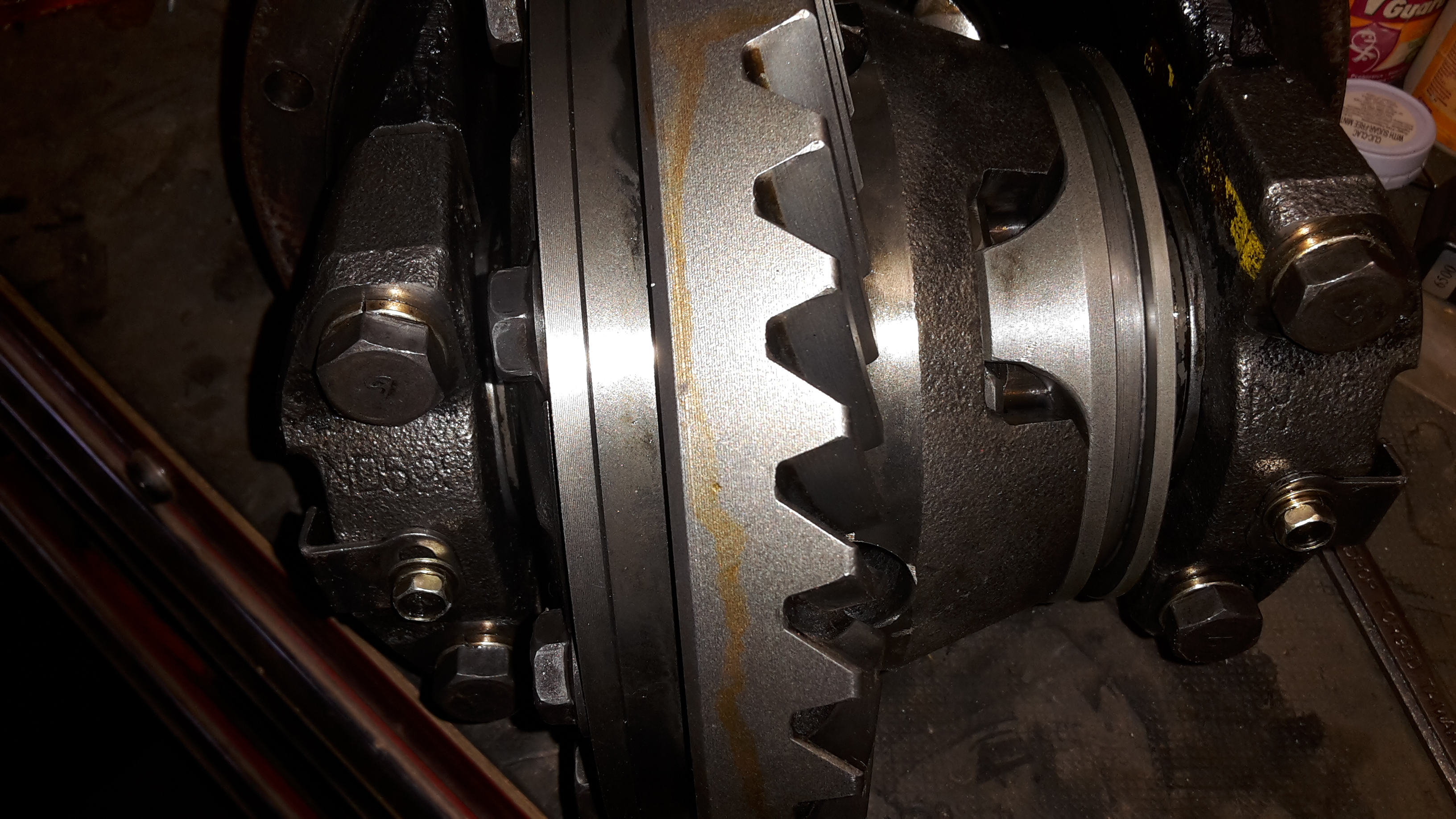

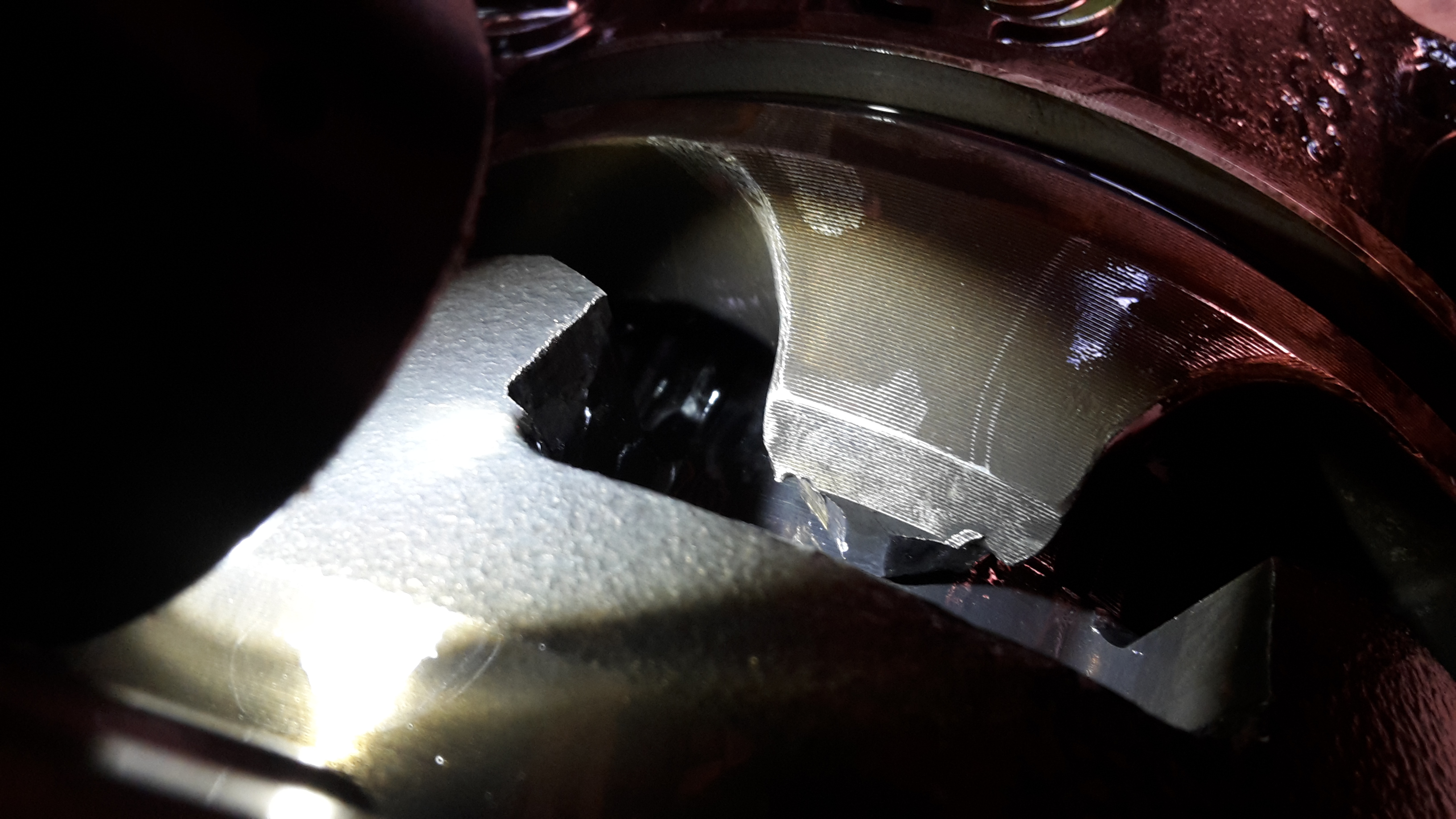

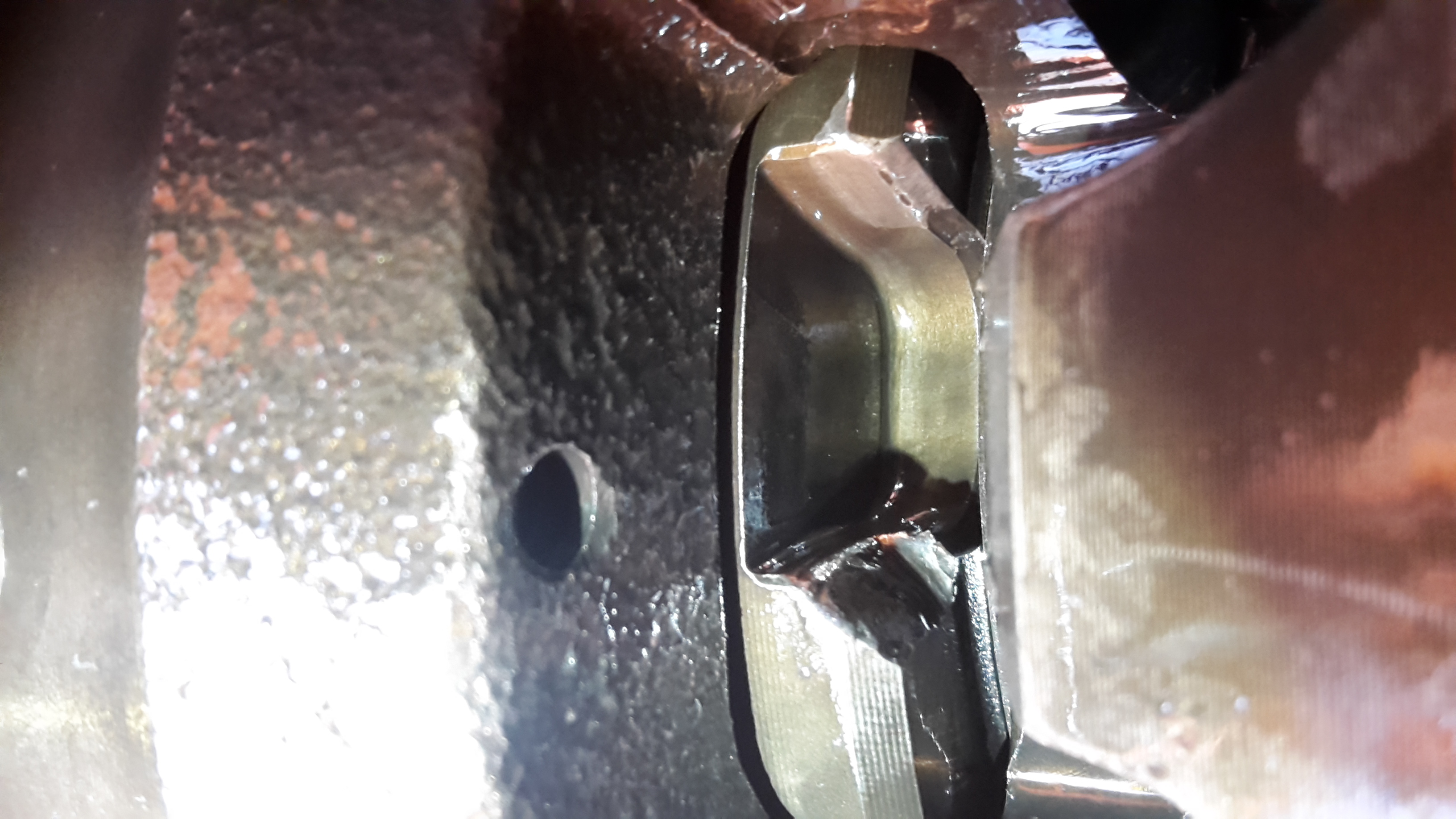

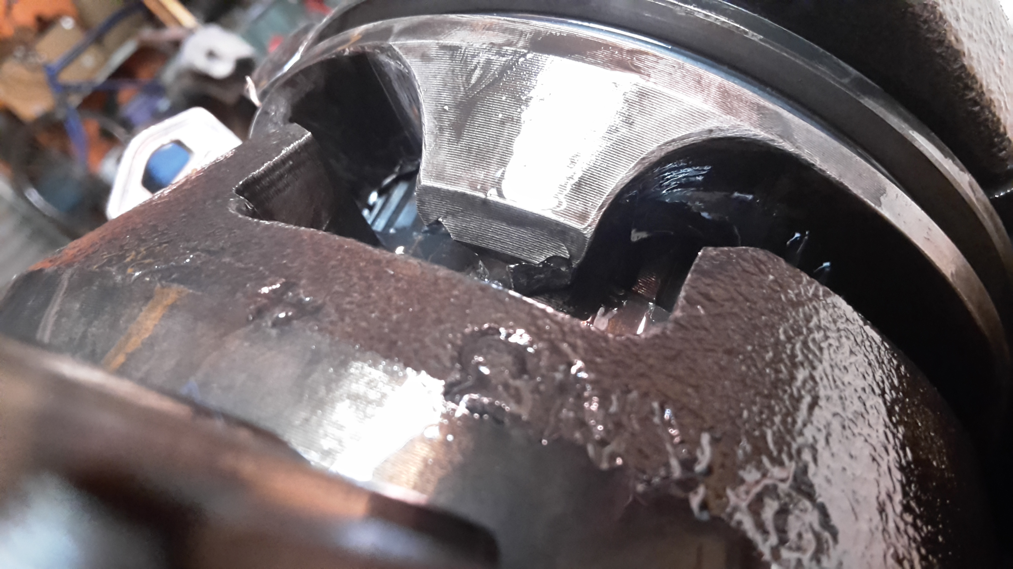

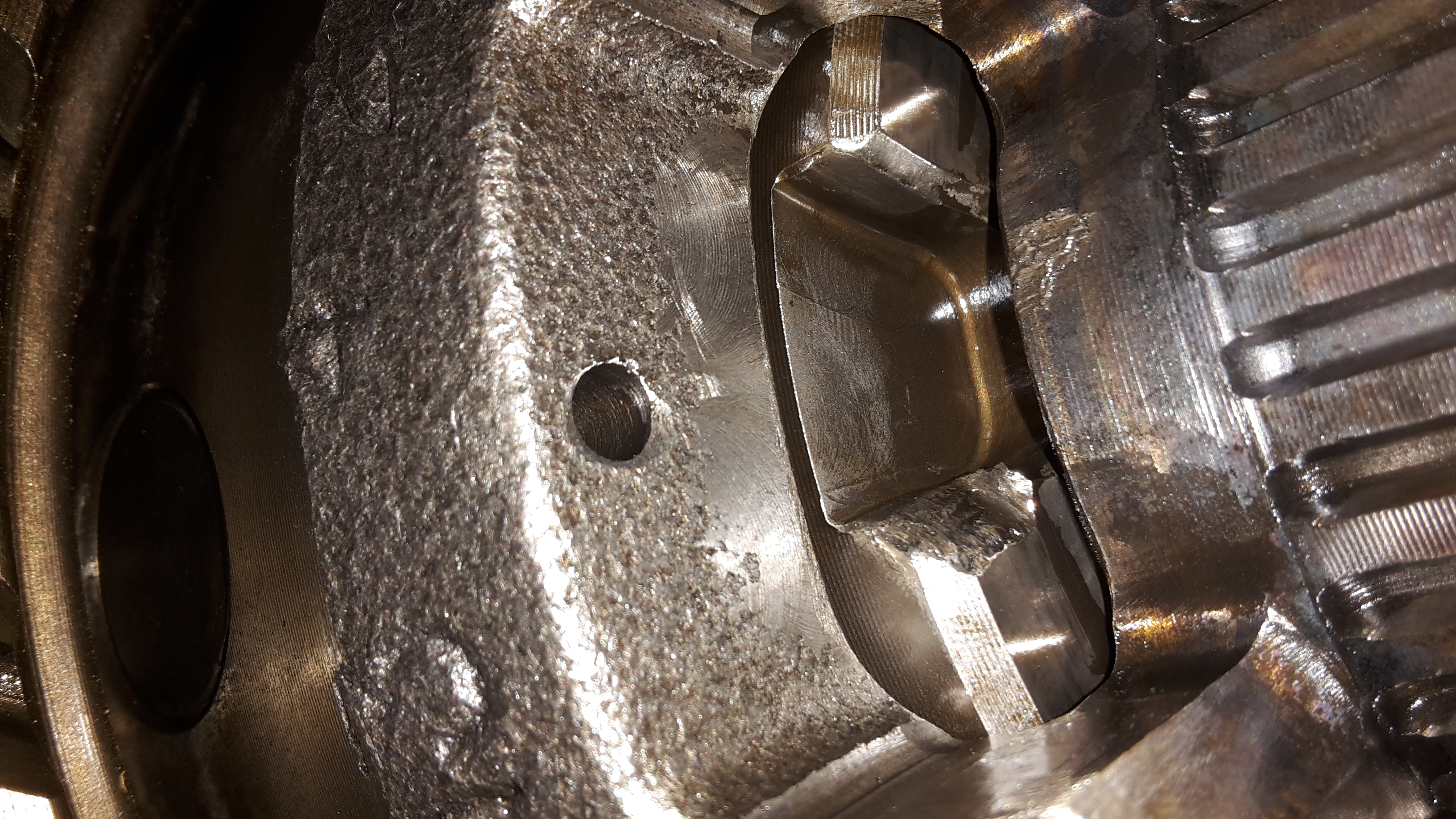

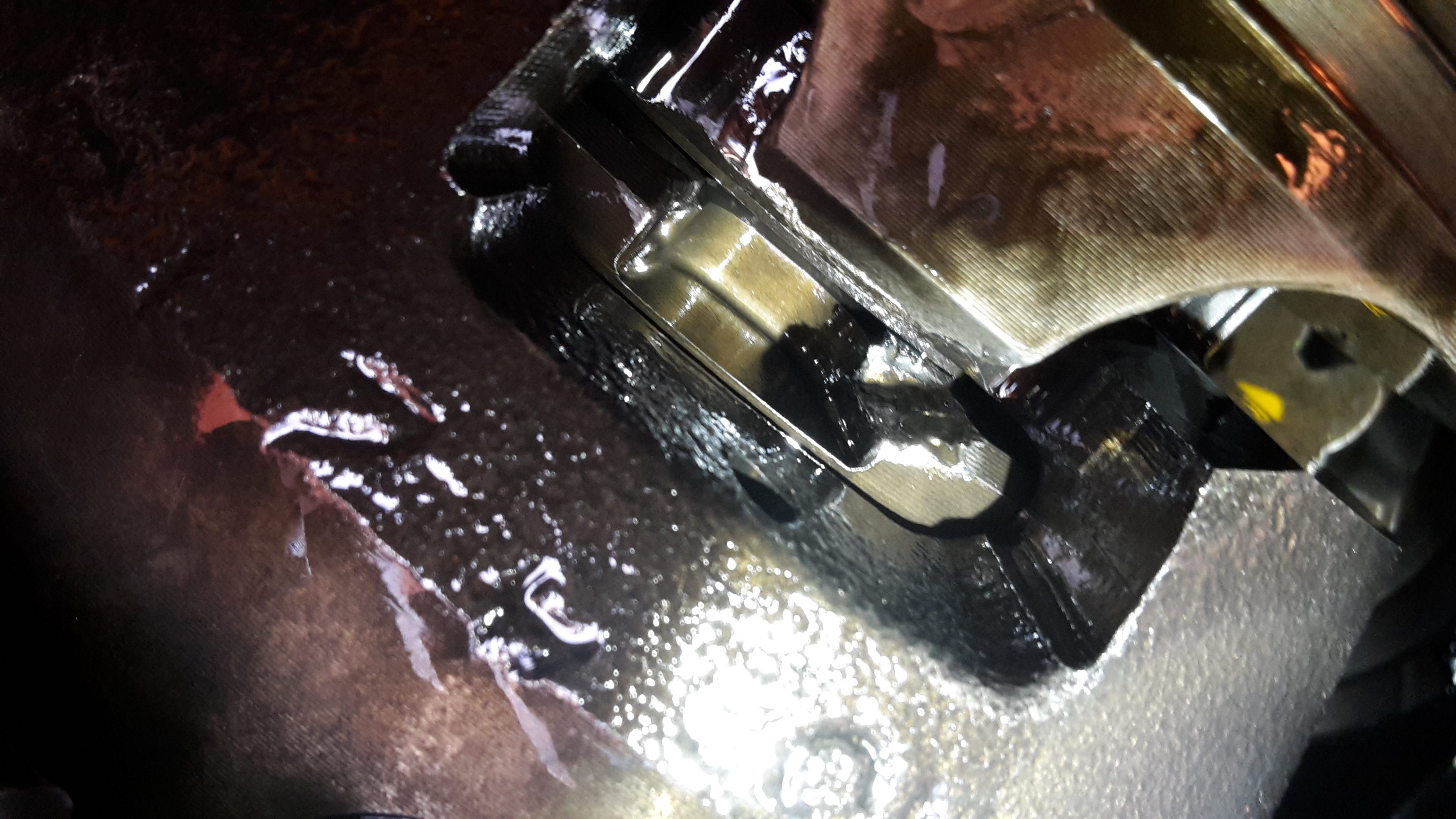

Hi Everyone,
Sorry for the late response.
I have attached some photo's of my broken difflock.
Re: Difflock not working
Looks like that took a major pounding !!!
Post by Mamba »
Some more pics
Locker disengaged
Locker disengaged
Lock engaged
Lock engaged
Damage
Damage
Damage
Damage
