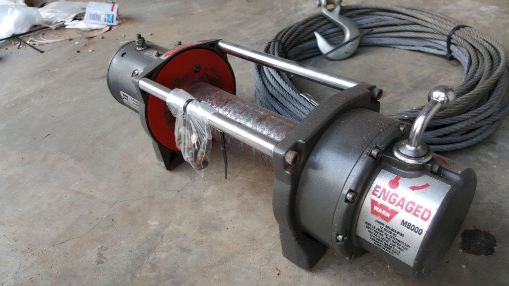

One good winch option - buy a second hand M8000 and do the motor change I suggested earlier... actually I have a complete M8000 willing to sell, but motor has been rewired before by a guy on this forum (but I didn't trust re-wiring completely), so buying the 9500 6hp motor and upgrading it is right way to go!

This is the motor for upgrade M8000 - on ebay for R4000
