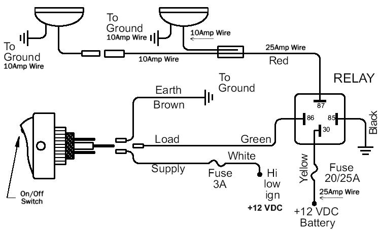

Hi
The diagram looks something like this:
Your High beam and the switch must be on for the spotlights to work. You can work the high beam without the spots, but the high beam must be on for the spots to work. Hope it makes sense. :think:

Re: Driving - & Spotlights
Main beams and brights must be on to have the spots working. Only then can I use the aftermarket switch to either switch the spots on or off.
And the advantage of this is that you can dim all lights with just one movement.
Post by SCUBA Patrol »
Stefan, Gebruik dieselfde circuit as hierbo, net die "trigger" sal die ingnition wees sodat die ligte aan is as die motor loop, dus sal dit nie op die "dim-bright" circuit werk nie maar heeltemal apart van die res van die ligte. Dit is altyd 'n goeie idee om die ligte op 'n eie skakelaar te he indien dit afgesit moet word vir een of ander rede.
The down side is you cannot use the lights as working lights without switching on the main beams?
Post by David M »
Marino4x4 wrote:Hi
Of course you can fit a second switch on the line coming in from the hi/lo beam which takes it's power directly from the battery. Then you have the option of using the spots with the high beam or by themselves or even as worklights with the ignition off. You would connect it in parallel and not inline and after the hi/lo switch.
Cannot find a diagram on the internet.
As far as I know, and stand corrected, the way mine are connected is the "legal" way ( other than the wattage of the globes ) to have spots fitted and connected.
Not quite sure what you mean about " And the driving lights, are they just on a switch? "
Just thinking here, but I wouldn't use the spots as working lights due to the power draw from 130 watt globes times 2.... 260watts also gets quite hot after a period of time, and my brain is saying that unless you are moving allowing airflow over the spots and wiring for that matter too, there could be some damage over time that may occur, as well as draining your battery. If you are using a light bar or LED spots... well that's a different story then. I have a fairly large Zartek rechargeable torch permanently in my car that I can use for a worklight if needed.
