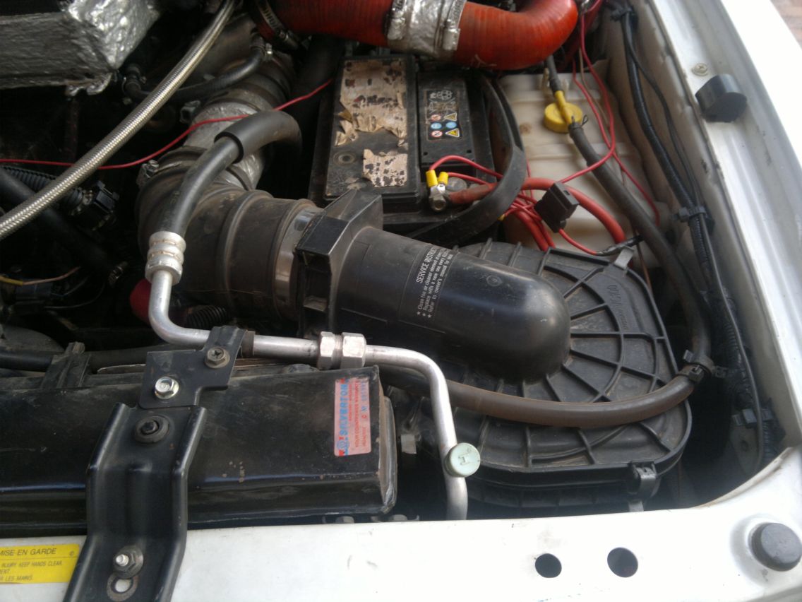

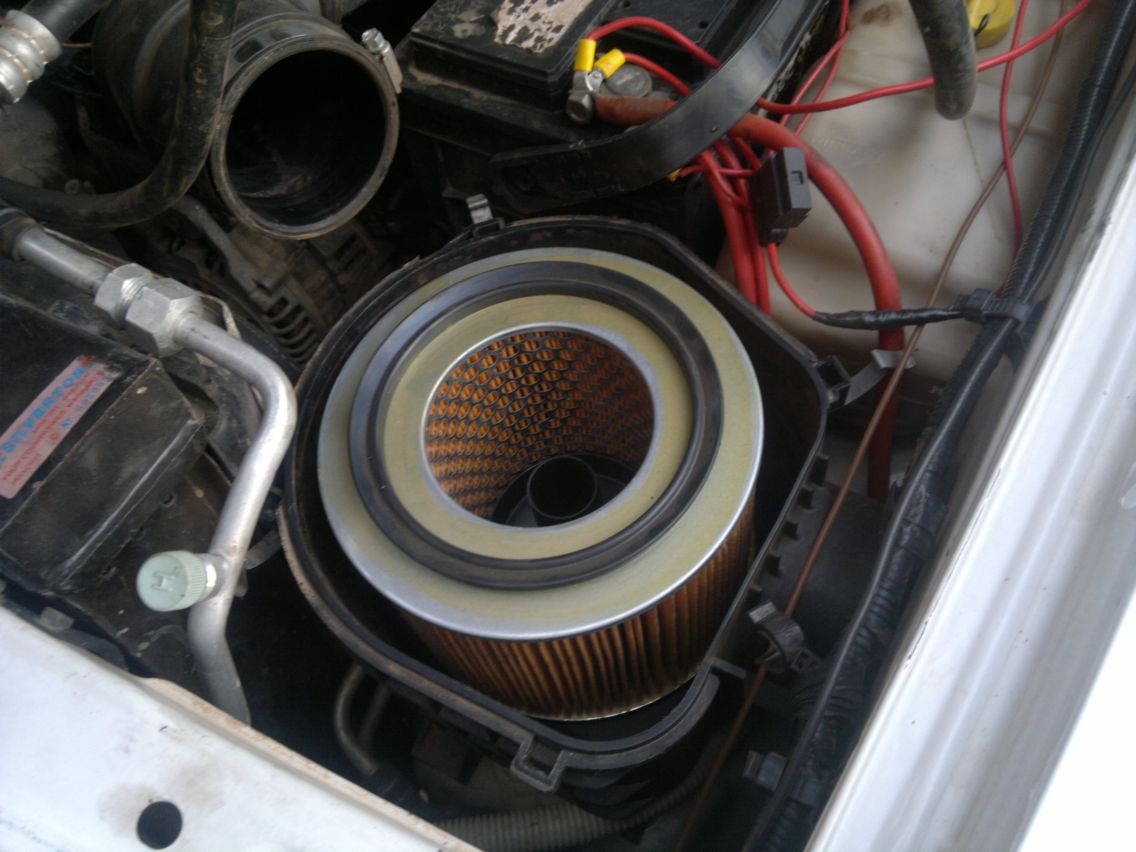

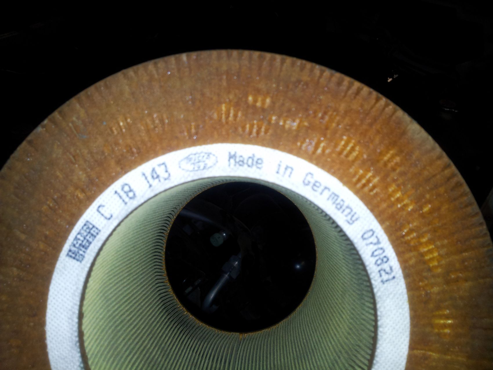

Here's some pics of my setup
This is the Nissan Filter This is the Mann & Hummel filter supplied by GUD
Unfortunately I don't have a pic of the Renault Scenic filter, but it works !!
