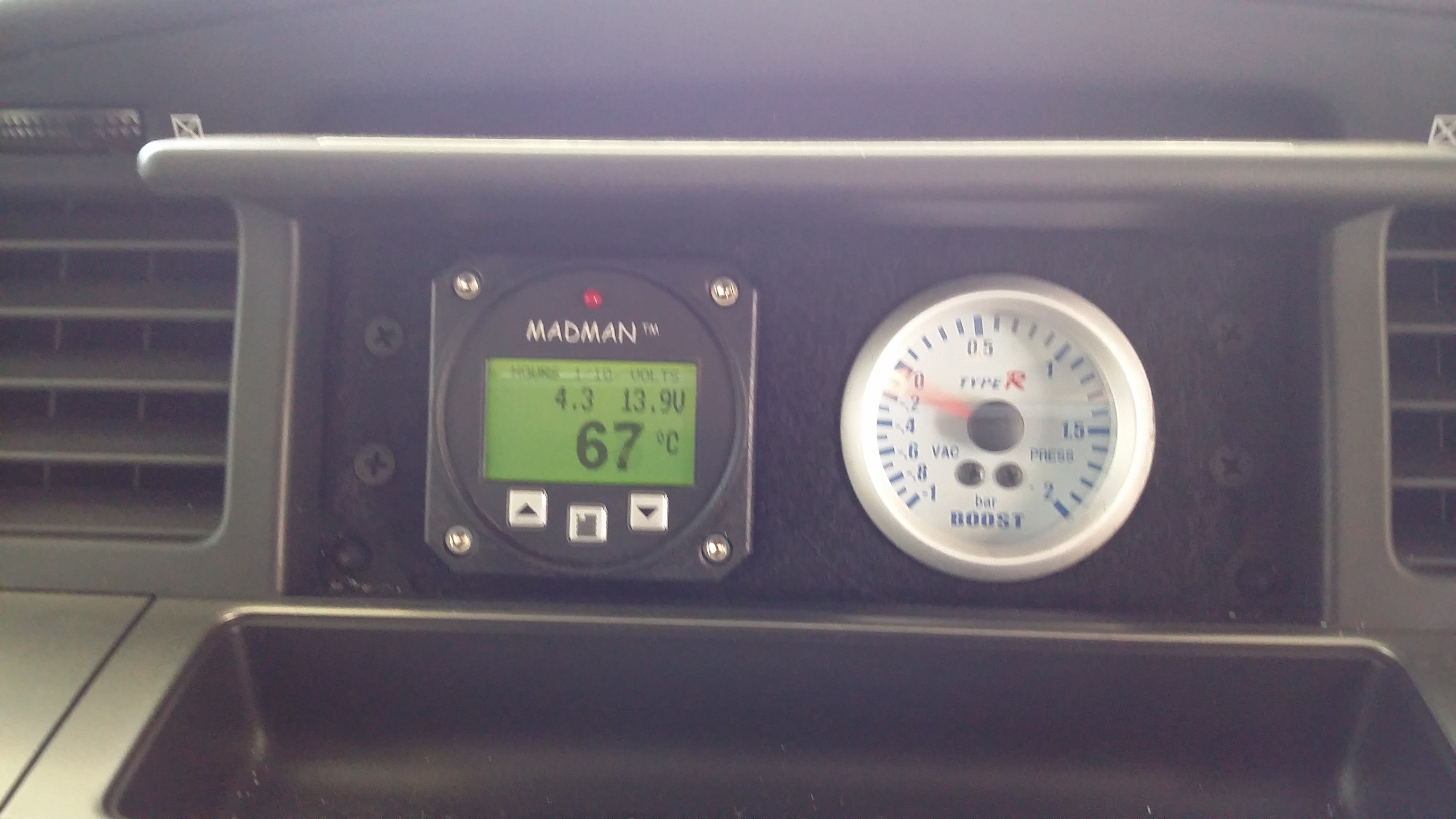

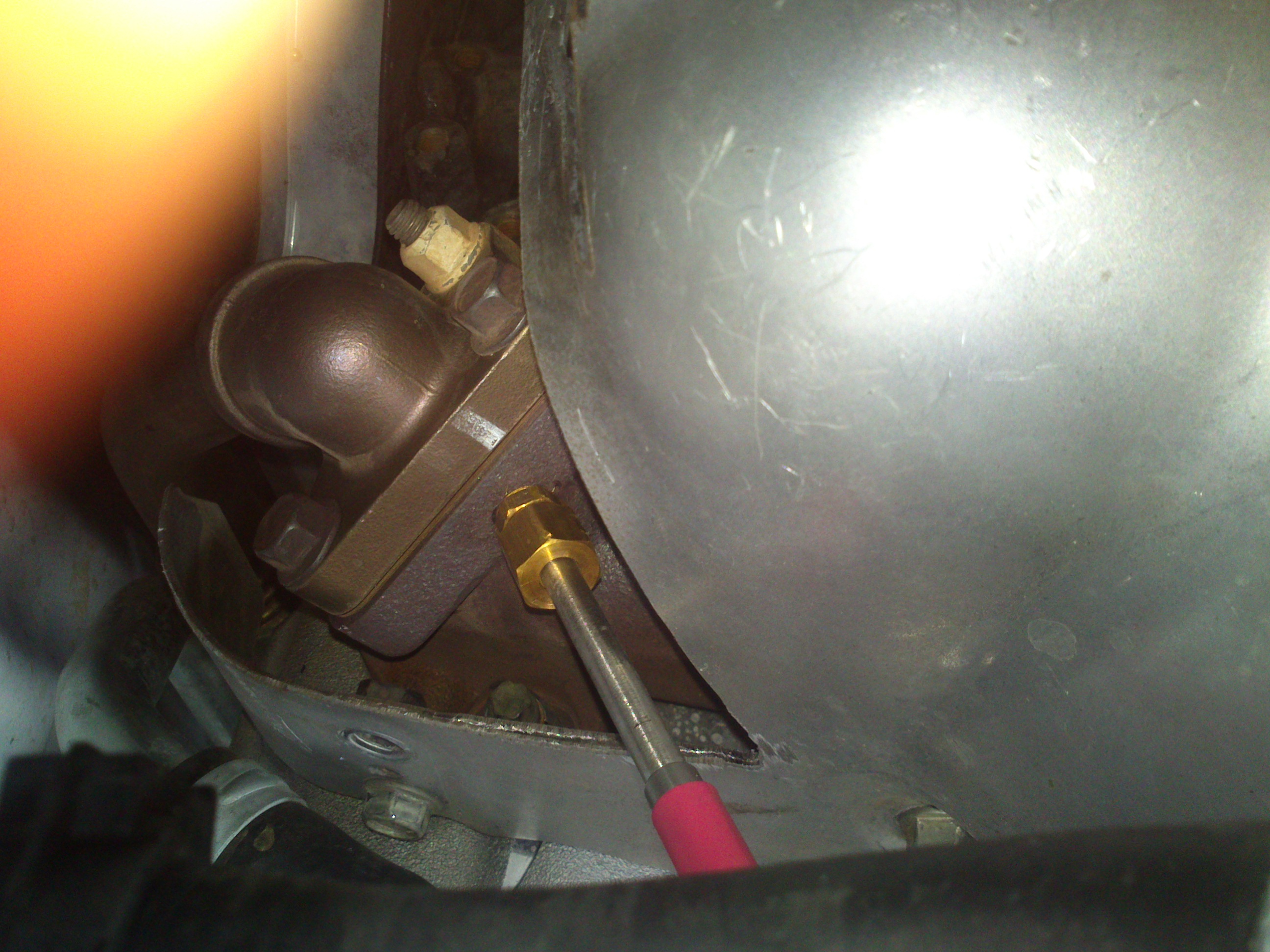

I installed the EGT gauge over the weekend. Thanx for everyones help :thumbup: my nurves was shot. :lol: with frequent prayer and loads of GRACE i installed it successfully :biggrin:

Well done JoshJ
For what its worh, those probes can be bent if needed

Thanx Frans, apreciate it. :thumbup:
I installed the guages here for now. See there is alot of comotion on guage holders. So I'll wait and see what the guys come up with :lol:
