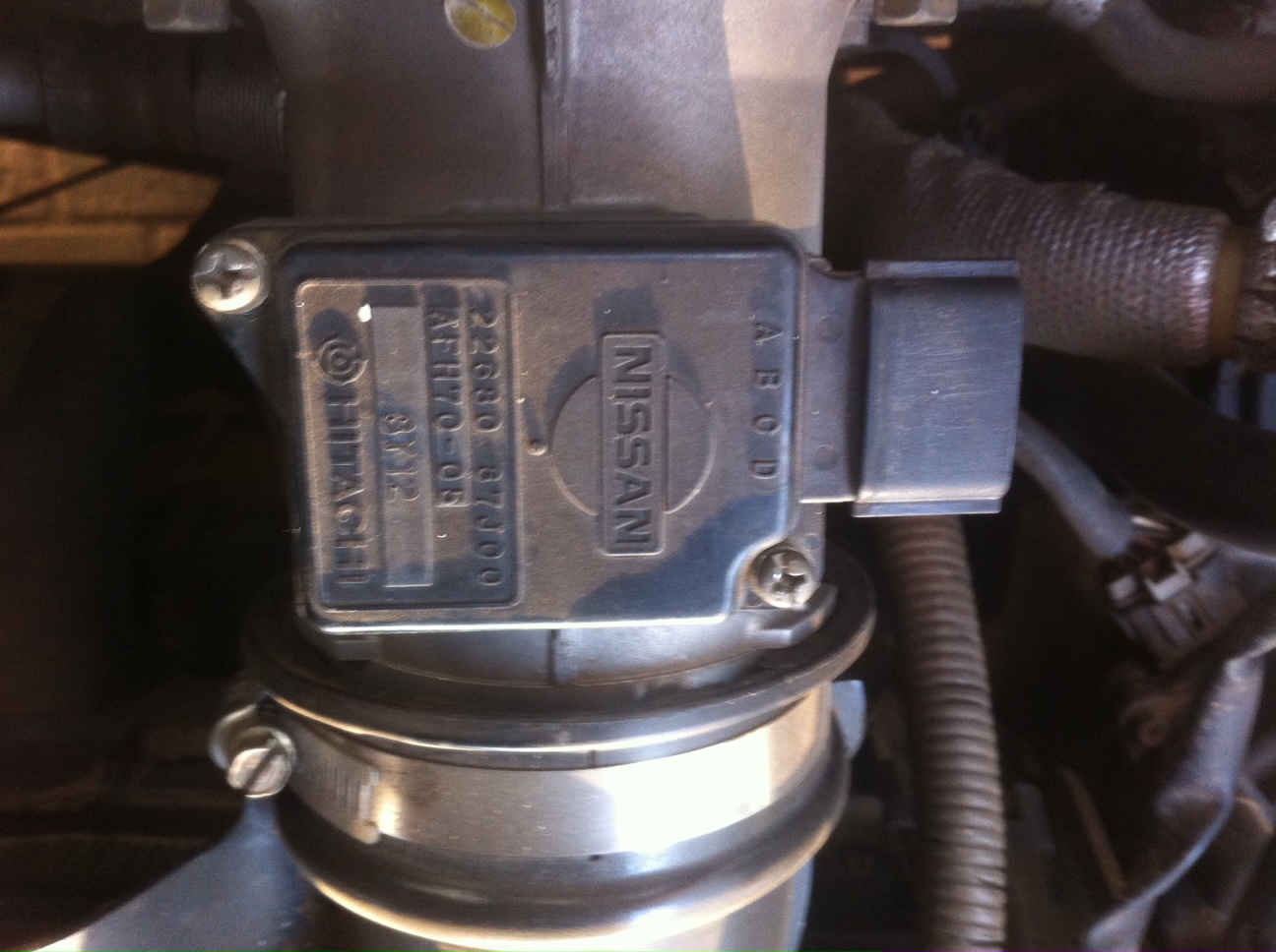

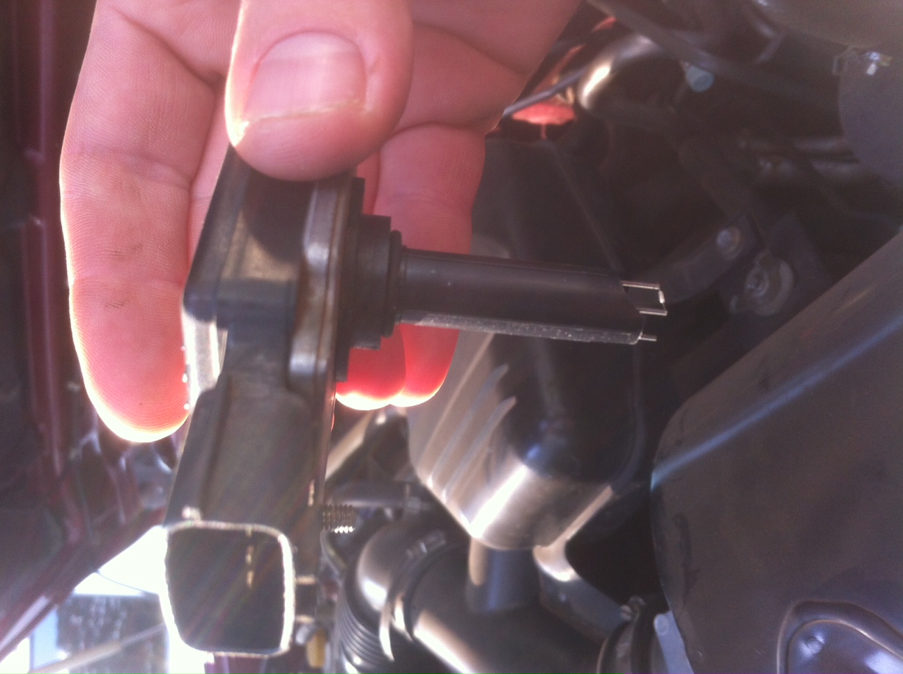

Is this the 4.5's MAF sensor?

The Mass Airflow Sensor yipp
whatever you do don't short those wires out you can pop the ECU very easy
