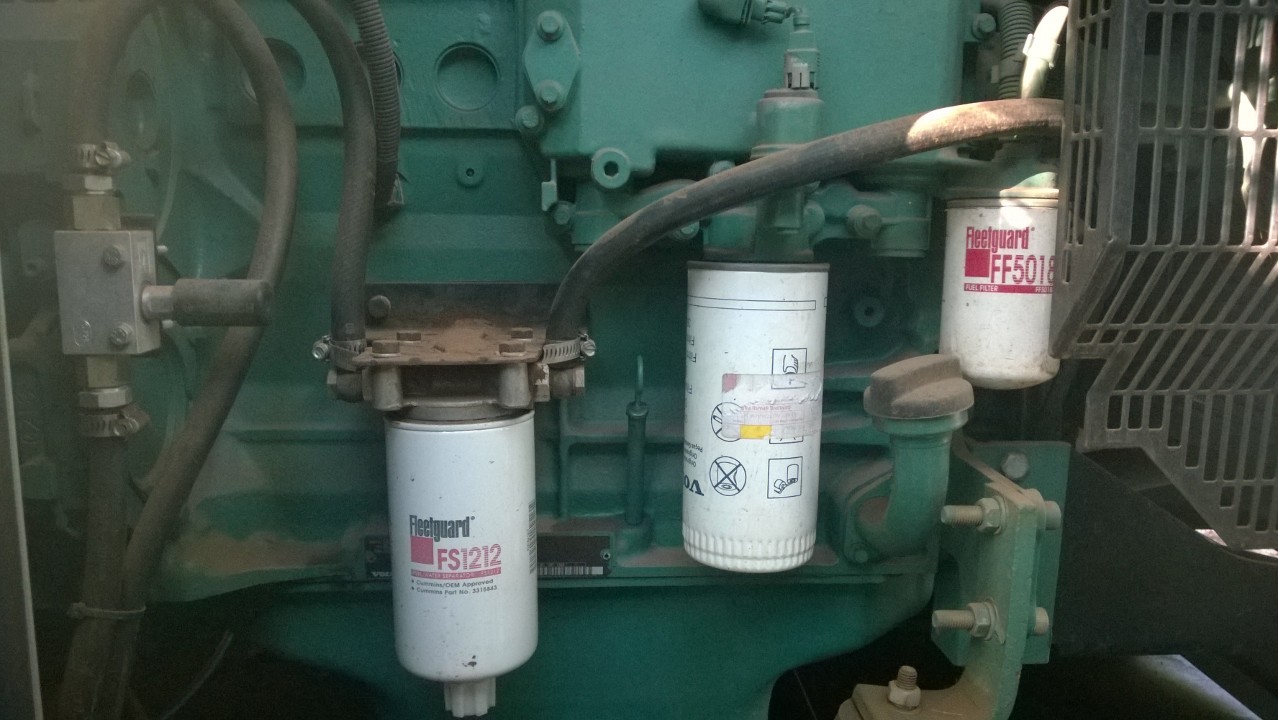

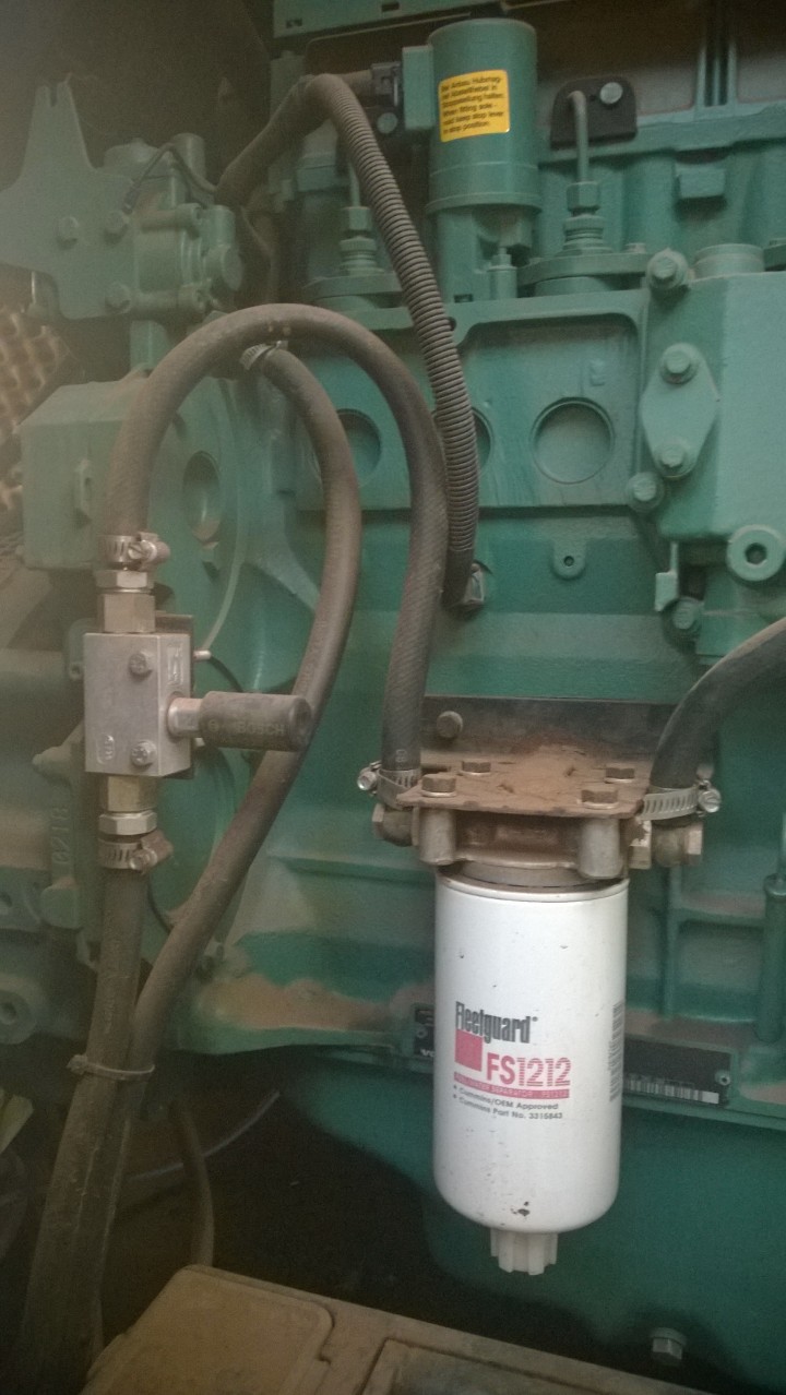

Re: Fuel supply failure
These pictures show them the best. Here it is fitted to a 80kva Volvo Penta generator set.
This engine runs very clean and conforms to European emission standards. This engine has done about 500 hours with this setup fitted. (obviously I change the cartridge at each service - 200 hours)
It would be best to consult the sales people at cummins to get the best filter option that will be compatible with the application.
With petrol vehicles , water removal is a problem as the properties of petrol and water are similar and the filter will let some water through and these filters are primarily designed for diesel.
Chris.
