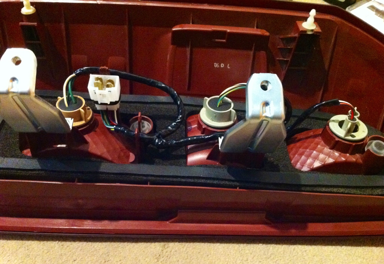

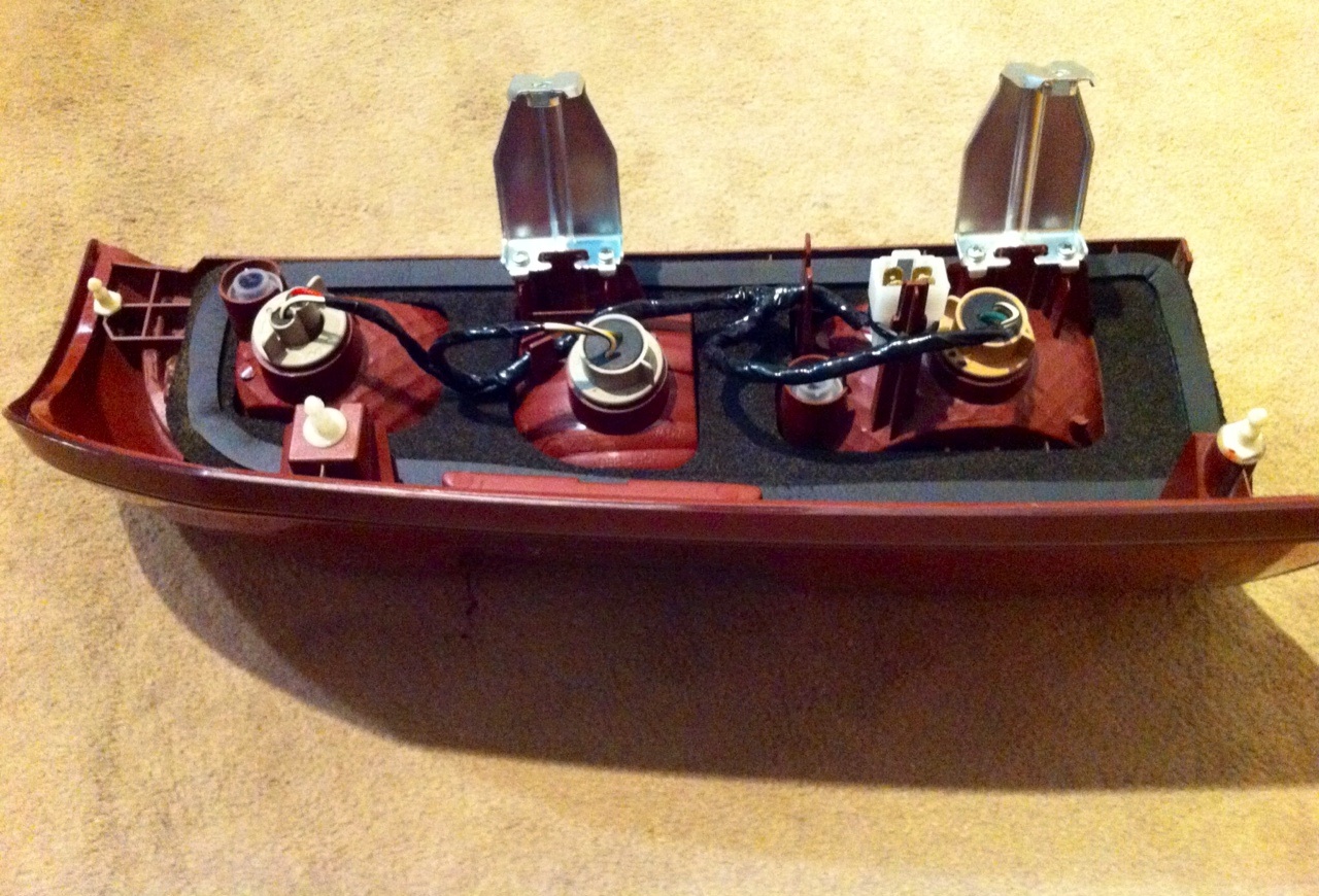

I used second hand Subara tail light harnesses, filed slots in the holes I drilled in the back of the light cluster which enables the globe fittings to latch tightly and the rubber seals against water ingress. I also fitted 4 pin male/ female push on connectors enabling easy removal of the light cluster and globe removal as well. My choice was tail light top, middle reverse light and stop light/ tail light combination for bottom fitting. I will try and attach pics!! Ps.

Re: Mutter, mutter...dummy tail lights
Mine work on both bottom and on top. There is a plug lying loose on both sides, just waiting to be plugged in..... but... you may want to check the wiring. My new lights ( from UAE ) has indicator ( orange lenses ) on top, clear reverse on BOTH sides, and red on the bottom. The harness, if I recall is a plug and play and works the correct globes for the colour lens ( basically for the light cluster I now have fitted, not the std SA light cluster). If you keep your original light cluster, you can't have the indicators working, as there are no orange lenses, so a different wiring setup is needed.
That said, when I added globes to my original light cluster, I made the top brake and tail light, the bottom only brake, and then the middle clear lense was reverse, and the middle red one on the other side, I ran new wiring through a switch and relay to serve as a fog light. This was fantastic when traveling to Moz through Ermelo and similar areas when the fog was thick.
