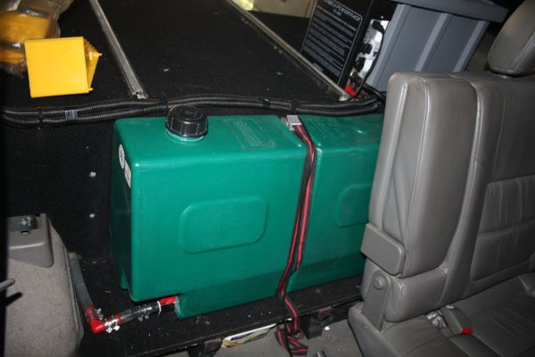

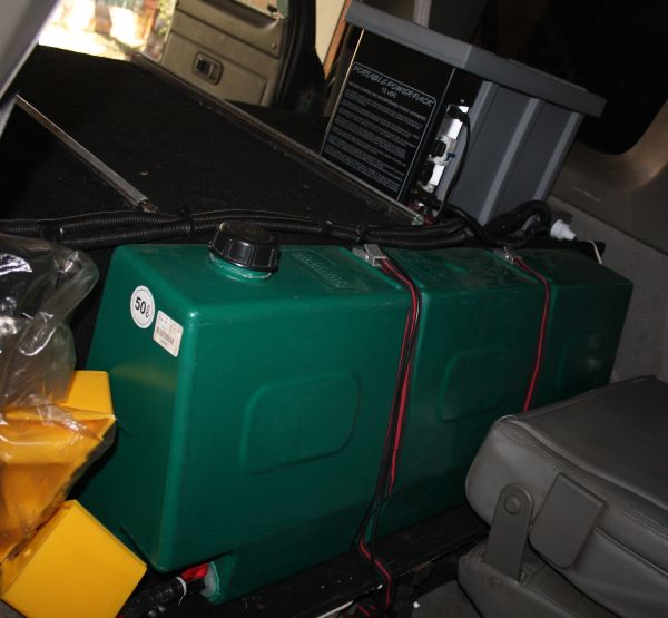

Hier is 'n paar fotos. :salute:
2 Drawers. Various 12 V supplies and 220V outlet on the left. Fire Ext above. Battery Bolted in. Inverter left of battery. Fridge slide above right drawer. Water outlet right of RH drawer. Whole system bolted down on third seat position.
50 lt Pioneer Plastics water tank behind middel row seats. Front of tank slopes backwards to allow reclining of seats
Water tank and fittings
