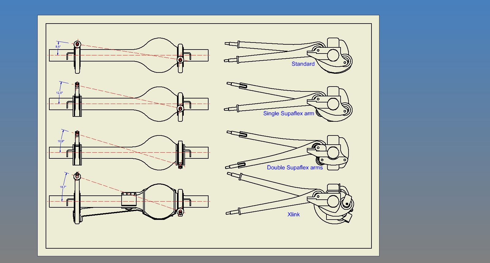

Here is a comparison of the basic systems:
As can be sen, the x-link and double-supaflex layouts give comparable maximum flex. However, I believe the x-link will give better traction. Firstly because the supaflex layout still relies on bushing deflection for suspension flex, and this means that the bushes are fighting you every step of the way, and this reduces the traction on the extended wheel (at the indicated maximum deflection of about 17 degrees, the bushes are fully-flexed (10mm of off-centre on all four bushes), while the x-link's bushing flex at the same articulation is on average 2mm), and also because of axle-wrap and axle-tramp. This is when the axle tries to wrap around it's axis, because the controlling bushes are now much closer together and this motion is undamped. This axle wrap is the reason powerful leaf-spring cars are often fitted with "power bars".

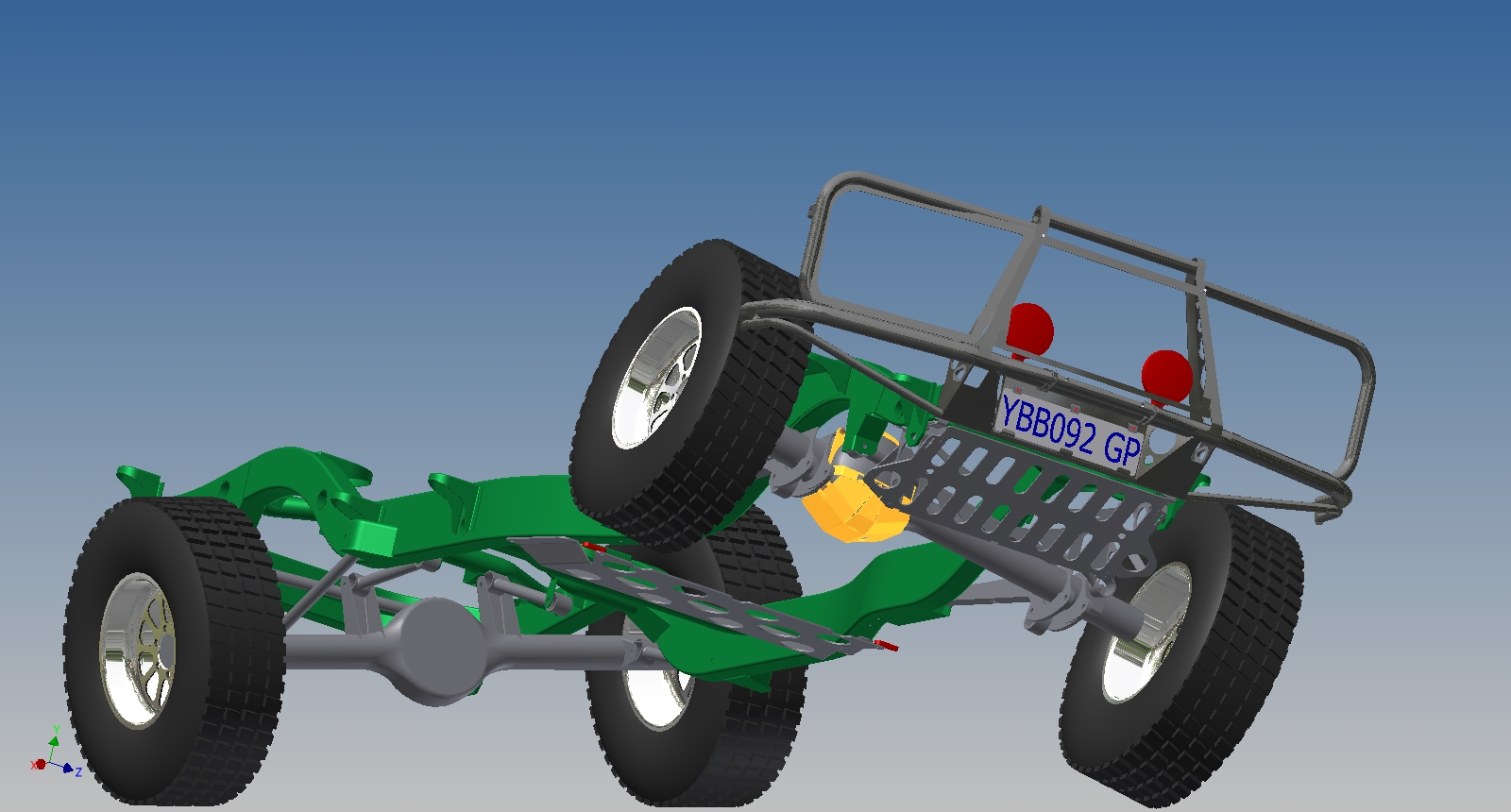

This is maximum flex of my current setup:

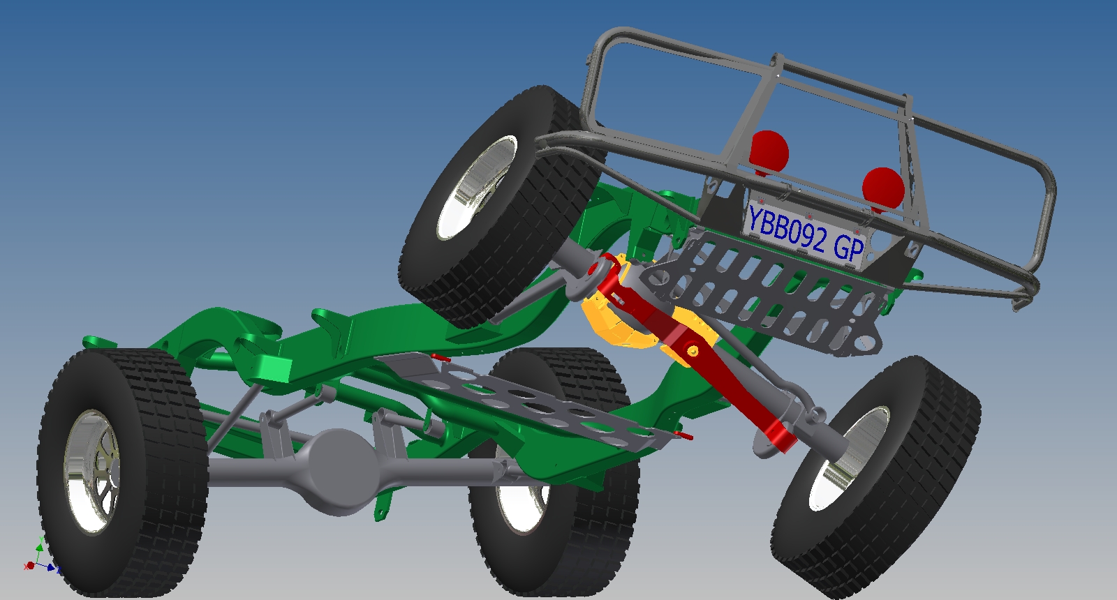

And this is with an X-link added:

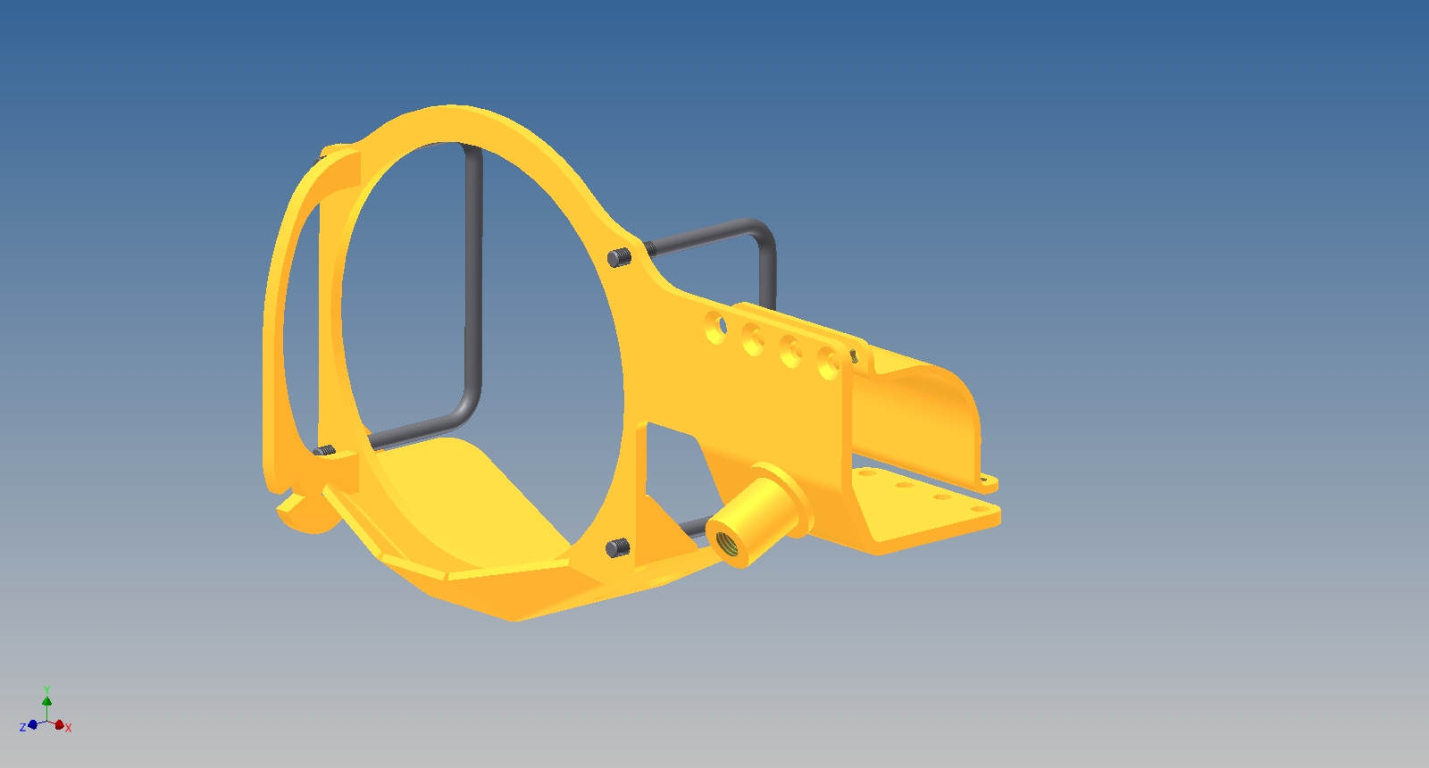

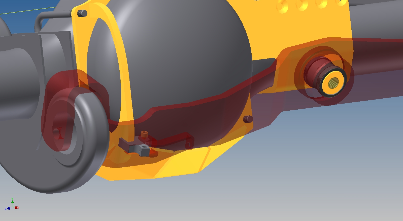

The major concern I still had about the x-link is the process of welding the swivel pin onto the diff. I don't like the idea of this. However I think this might be a suitable altternative: a re-designed diff guard incorporating this swivel pin mounted on a very robust clamp, and also incorporating the lockout hardware.
This is what my proposed lockout looks like. It is designed to be cable-operated, so that it could even be operated from the driver's seat.

Thanks for this so far. My biggest concern is the overall robustness of the set-up, such as the swivel, and if it proves not ideal, if one can revert back.
I see that you have now opted for the yellow diff guard. Nice!

I do believe the X-link as I have drawn it up is at least as robust as the standard setup. Remember that although it is obviously not a straight comparison, the standard bush mounting points are a mere 3mm thick, while the X-link is 10 or 12mm thick. The mount for the swivel is 8mm thick and clamps with 8off M10 bolts...
