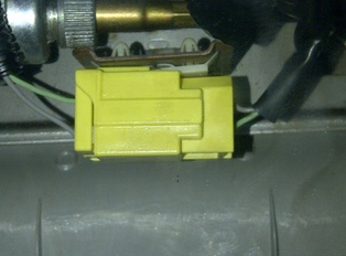

The very first time ( end of last year) that the airbag light came on, I cleaned it with fast dry contact cleaner and it lasted about 8 months before it came back.
This time it lasted 3 days.
I then sprayed it with Q20 and it lasted a week and the light was back.
I then noticed that I can reset the light when I stand outside the Patrol but as soon as I get in and sit, the light would start flashing.
I then cut the wires and soldered in new wires from the first to the third connector, bypassing the second connector.
If you do this, you must be aware that the the colours of the wires change at the second connector. The green connects with the purple and vica versa.
It is now more than a month later and the flashing light hasn't come back.
Attached is a picture of the second connector which is situated at the front of the seat.

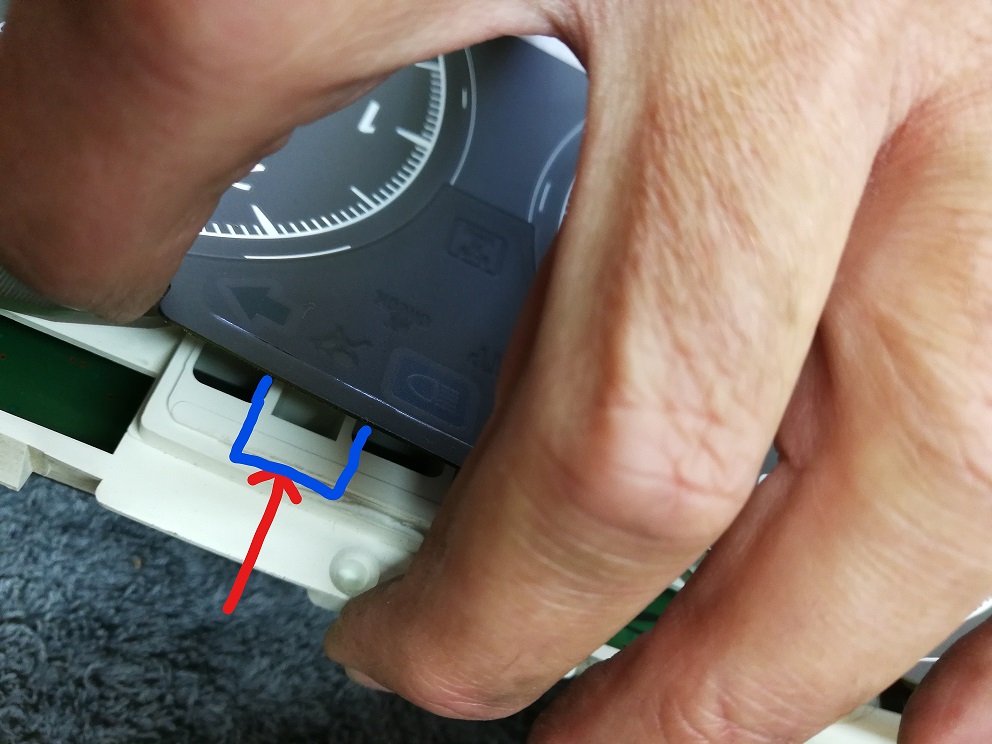

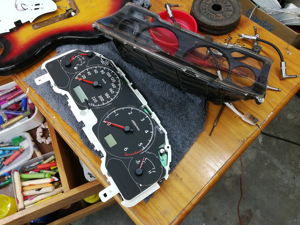

Feedback:
On my 2008 4.8 the light is incorporated into the circuit board. I didn't have time to mess around inspecting the circuit board so didn't look at soldering in a jumper wire to fit an override switch. Maybe another day. For now I just fitted a 12mmx18mm piece of insulation tape between the face and the housing. It gets clamped between the face and the housing but just to make sure I made it longer on the top section in order to have more glued area to ensure it stays in place (see blue marking on the photo). Quick job. Twenty minutes all done. I think it's the first time in my life that a DIY job got done in 20 minutes without a calamity, everything usually turns into a three day job
