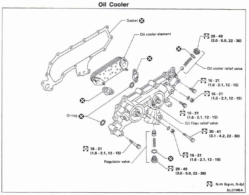

Gentlemen
Studying the manual, it would appear as though some TD42's came equiped with a built-in oil cooler. This unit is fitted into a recess in the side of the block and transfers heat from the oil to the water in the cooling system.
The biggest advantage of this is that the cooler is very well protected against damage from foreign objects. The disadvantages are that there is a bigger cooling load on the radiator, and that the cooling medium is at a higher temperature and therefore les efficient.
Now it is obvious that some of the guys with turbo'd 4.2D's are having cooling problems, while some others aren't.
My question is: Is this perhaps the reason? Do the guys with problems have this unit fitted?

Can you post a picture from the manual that shows where it's mounted?

Thanks Peter! So it sits just above the oil filter mounts? Interesting stuff...

Re: GU 4.2D - Engine Oil Cooler Options
Gents if I read it correctly, it sits behind the air filters.
I suspect the only way to tell from the outside will be to see if the oil cooler relief valve is present, and perhaps the shape of the housing on which the oil filters are mounted?

Ahhh....I see...it fits between the block and the filters. That's an interesting concept...Peter Connan wrote:Gents if I read it correctly, it sits behind the air filters.
Cheers
PC
