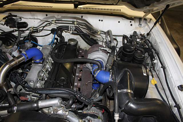

Ross / Cedric - please post pics of your set ups if you can, would be great to compare.

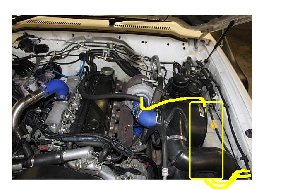

Andries - I've looked at donaldson and that would be first prize - but their filters are huge - would be interesting to see if i move the 2nd battery if there would be space.
Frans thanks for your advice.... i really didnt want to have to move the battery... more $$$ spent.... and I dont have a draw/packing system in the back.
So now I'm faced with the current 3 choices:
1. Use larger BMC freeflow filter, fit snorkel, fit pre-filter to snorkel when go offroad (interim solution)
2. Find suitable filter drum and get larger paper filter (Frans what filter were you running inside 4.5 drum... was it toyota 4500 efi or nissan), move battery, spend $$$ on start of packing system, also is this big wiring job?
3. do number 2 above but with a donaldson
With current open air filter set up.... egt's same if not better than before so is this not okay for now? Or is hot air intake a separate issue?
Eish..... feeling disheartened as i want everything now 100% correct

Hello Dave.
I used a Nissan 4.5 efi drum with bracket with the Nissan filter.The only bad thing about that filter,I only bought it from Nissan and payed R600 for the cartridge.But yes the filter in the pic are a nissan 4.5 efi.
I know to move the battery go with wireing and effort and $$$.But it wil be your first best option.
Or use the other filter housing and fit a paper filter and hook it up again to the fender and then to the snorkel.
For what it worth.Inside at the left back section of your Patrol,are plenty space for a battery without a drawer system.Pull off the pannel and you will find a hole to fit a battery/small water tank.You will only have to find a way to enter the battery when the cover is fitted.The GRX models have a little cover,I think to fit a std spanner set from nissan?You can use that to get to the bat if needed.You can pull the cover off to replace the batt when shot every how many years or so.Just an idea.
Good luck.
Frans
Good luck.
Frans

Dave, Oompie thinks that maybe the Donaldson of the VG 30 Hard Body will fit in that space ... maybe measure a VG 30 box?
I got one for LOBO for R300 [with pipes & new filter in] at One Tonner Spares [Pta West]
just a thought...
just a thought...
Re: Air Filter Service
I was thinking the same there Oom Mac, The VG 30 air box and filter is probably 2x the size of the one in our 4.2's. If I remember correctly the Isuzu KB 280 DT I had also had a huge air box and filter. I never got a chance to take any photos yesterday, was busy with clients, and again today but I'll show you my $#@$# small foam filter, which after reading this makes so much sense that I can't believe I never even thought about the size and air volume.
Dave, I know on Chuck Norris (Christo), he has moved his 2nd battery back towards the firewall, still on the same side. There are some vaccume pipes and canisters in the way if you move the battery there, but he swapped the positions, in other words her put the battery where the vaccume pipes are and shifted the vaccume goodies to where the battery was. Doing this should be a relatively cheap operation and then there should be huge amounts of space for the bigger airbox.
I will look at my setup too, and see if it can work on mine, as my intercooler sits on top of the tappet cover with a disaster setup for the air intake into the intercooler from the turbo. I need to move the intercooler around .... somehow... to make a plan to get rid of the pipe making first a sharp 110 deg bend and then again another sharp 90 deg bend into the I/C....
.... maybe tackle the whole thing in one go...

It would be very interesting to see Chisto's set up! I'm away this weekend so i'll have to start NEXT weekend to see what route i want to ultimately go.
Frans, what do you call the kind of filter I am currently running (the one that sits uncovered in the engine bay)? You say it's the worst option as its drawing hot air. If I compare to previous free-flow filter in housing my egts are the same, or is there another reason you dont want the hot air? At the end of the day the filter is still a performance one so not good for dusty offroad use?
Where can I get a paper filter that will match the size of my CDA housing? I will also look at the back for space.
Thanks all for the posts!
