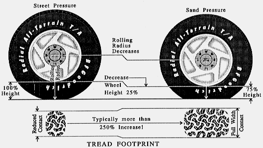

Cedric, here's a picture that shows nicely what happens when you deflate your tires.
Notice the decrease in ride height and gains in both length and width...
Sand pressures
Sand pressures
Sand pressures.gif (29.48 KiB) Viewed 2166 times

Nice illustration Christo! My opinion:
1. The difference between inflated and deflated tyres makes a bigger difference than the difference between spec tyres. No, I am not saying that the tyre spec does not make a difference at all, but when price difference comes into play though, I am not sure if the difference between spec tyres are worth the money. I think we place to much emphasys on difference between tyres.
2. It reminds me of 13 year old boys arguing which cricket bat is the best...when the technical ability to play a good cricket shot is much more important. Therefore, in my mind the role that the sole beneath the shoe where it hits the excellerator, is arguably as important than the tyre pressure. My weightings to be successful in sand would be: 40% tyre pressure, 40% driver ability and 10% tyre selection.
