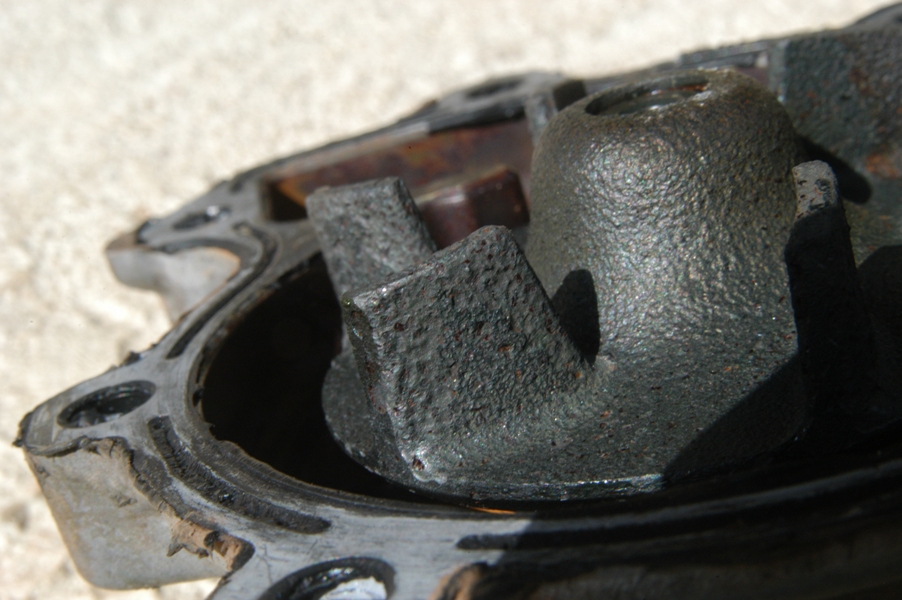

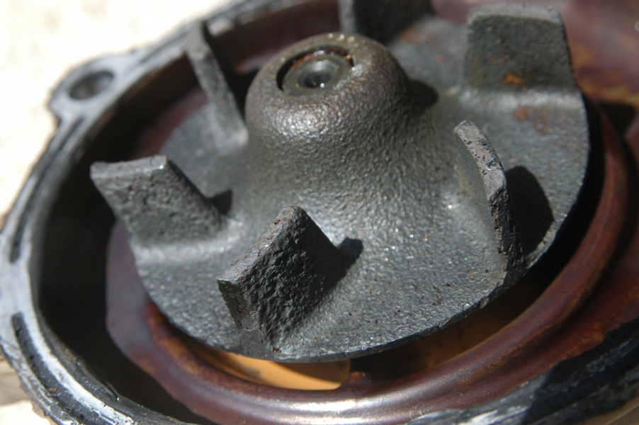

Re: Overheating Y60 4.2 petrol Patrol
Hello Guys
Attached are some pictures of my water pump, as I had to remove it in order to try and identify the correct replacement. I do not beleive the pump is the problem, am I wrong?
Thanks
Peter
Thanks
Peter
Doesn't look too bad to me either even though it is pitted. I assume the impeller didn't come loose from the shaft (Grabbing the impeller and pulley side and turning in opposite directions)?
Take it with when getting the new one and compare - maybe there is too much play?
This has actually got me thinking - Is this waterpump the original? (I'm looking at all the silicon sealer)
- How tight does the impeller fit in the space where it bolts in - If the impeller is too small it will have a major effect on the water flow?
Hi David
The impellor and pulley flange are both very tight on the shaft and I very much doubt there is any slippage. Wether the pump is the original there is no way of telling, but the bolt holes and casting edges all line up well and according to my manual silicon sealer is correct, there is no gasket. However as you have pointed out there seems to be a hell of a lot of space around the circumference of the impellor. Perhaps the casting/casing is correct but somebody has replaced the impellor with something else?
Unfortunately it is not as simple as taking the old one along to the spares shop, as that is in Cape Town and i am not.
Does anybody know what the diameter of the impellor should be, or does anybody possibly have a spare waterpump that he can measure?
Thanks
Peter
Thanks
Peter
Must agree with David, impeller looks ok but does look a bit small.
