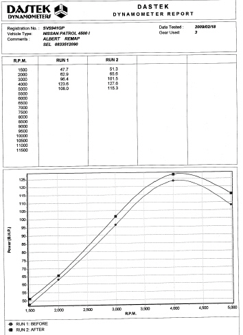

OT, but mine only gave 113 kW on the dino a while ago. It has a chip and freeflow on. Any ideas why and how to fix it?

Remember that there are significant losses in the drivetrain between the engine flywheel and the road: There are frictional losses in the transmission, transfer box, drive shafts, differential(s), axles and at the tyre-road interface. All of those losses stack up and can easily total 25% of engine power. Now if the 113 kW figure is an uncorrected figure, measured at the wheels and if the losses are assumed to be 25%, then this translates to an engine flywheel value of about 151 kW.

You're right with all the losses Gerrit,but 151kw @ the flywheel. :think:
If it is so,it will be the strongest one I have heard off.113KW are a bit low,but sound to fit the car more.Maybe Maniac can show us the graph?

Hier is Ungili se dyno grafiek.

25% on top of 113 = 141

Gerrit Loubser wrote:Remember that there are significant losses in the drivetrain between the engine flywheel and the road: There are frictional losses in the transmission, transfer box, drive shafts, differential(s), axles and at the tyre-road interface. All of those losses stack up and can easily total 25% of engine power. Now if the 113 kW figure is an uncorrected figure, measured at the wheels and if the losses are assumed to be 25%, then this translates to an engine flywheel value of about 151 kW.
Gerrit, ek weet nie of dit op die wiele is nie????? Ek sal grafiek soek en dit dan post.
Die grafiek hierbo, is dit op die wiele / flywheel, want myne het dieselfde gelyk, maar net 113 kW MAX
