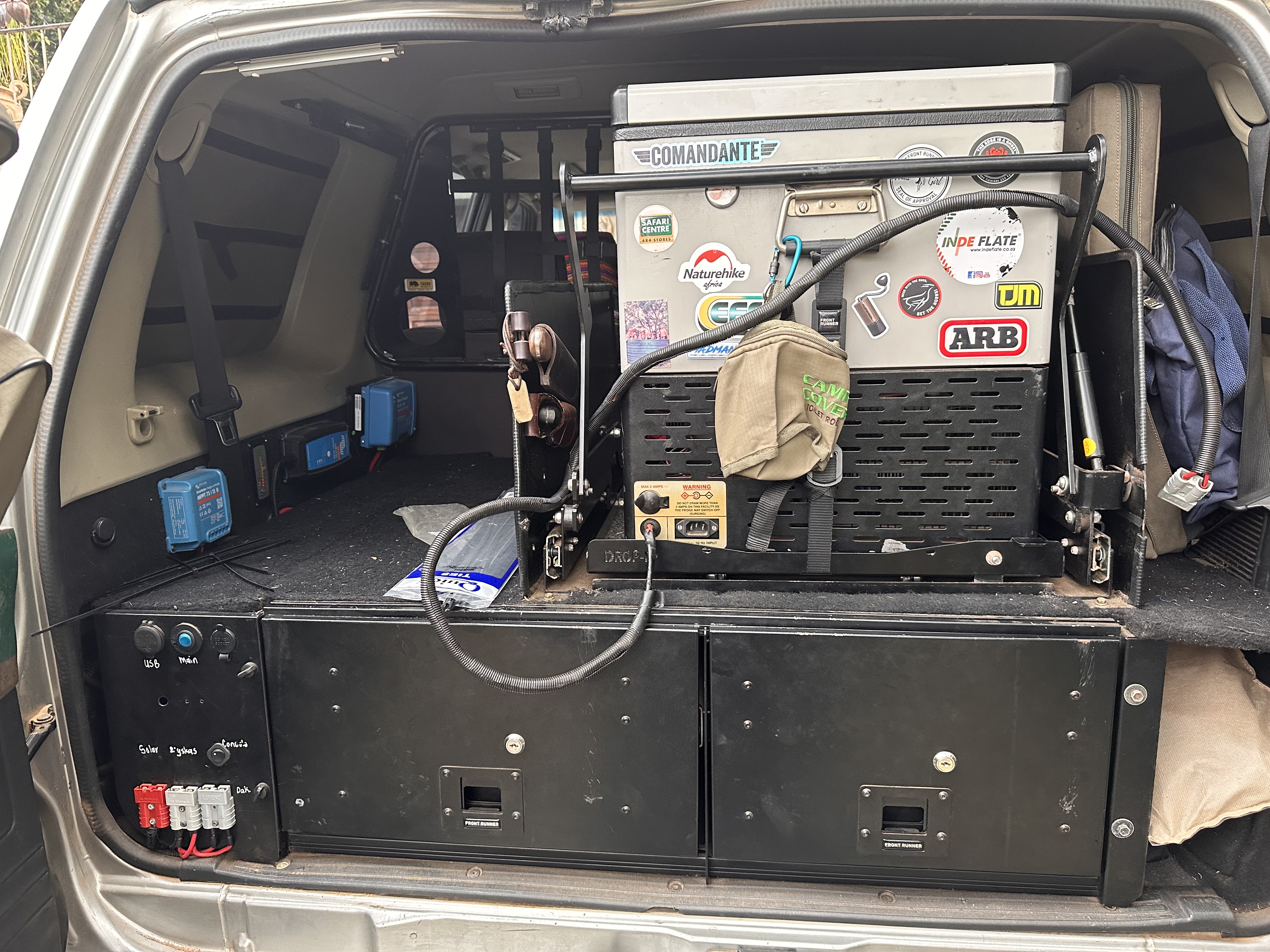

Hi.
I've got one of these. Just fits. Actually, had to shave the carpet on the wood top so that the barn doors close.
My battery box and chargers, etc are mounted onto it, on the right side. However, I put a battery together with those 100ah/3.2v lithium cells. So a ~12v pack ends up being quite slim.
The space left on the left side of the box is ample for wood, bags. And I like having the top low enough so I can still see out the rear and/or use it as a platform for stuff when we're camping.
It holds a 90L fridge.
Ivan

Yeah those ones are cool. But new they 16000. Else it would have been on the list lol. But yeah that would be a great solutionDouble Douglas wrote: ↑17 Aug 2023 13:40 Hi.
Ivan

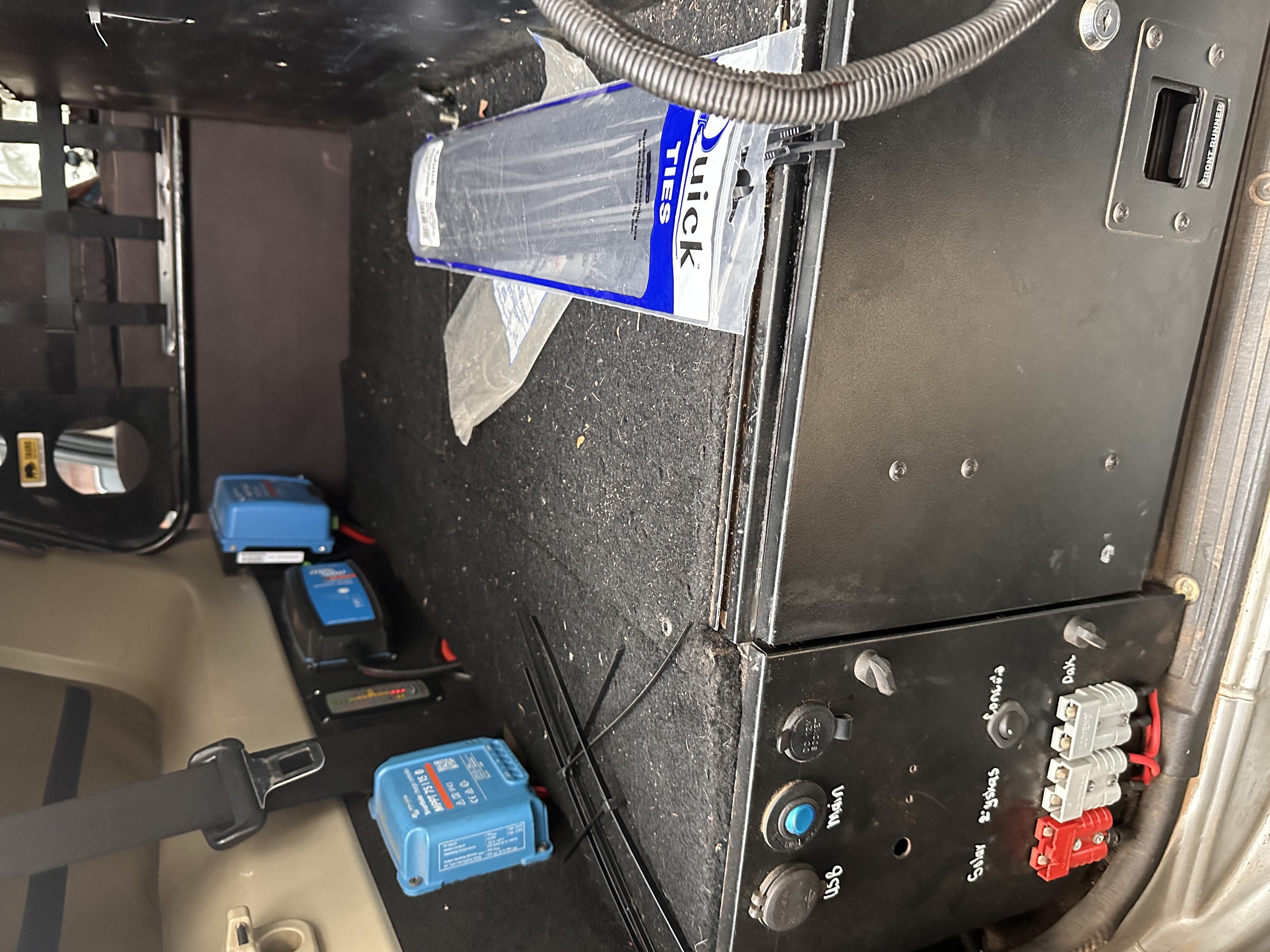

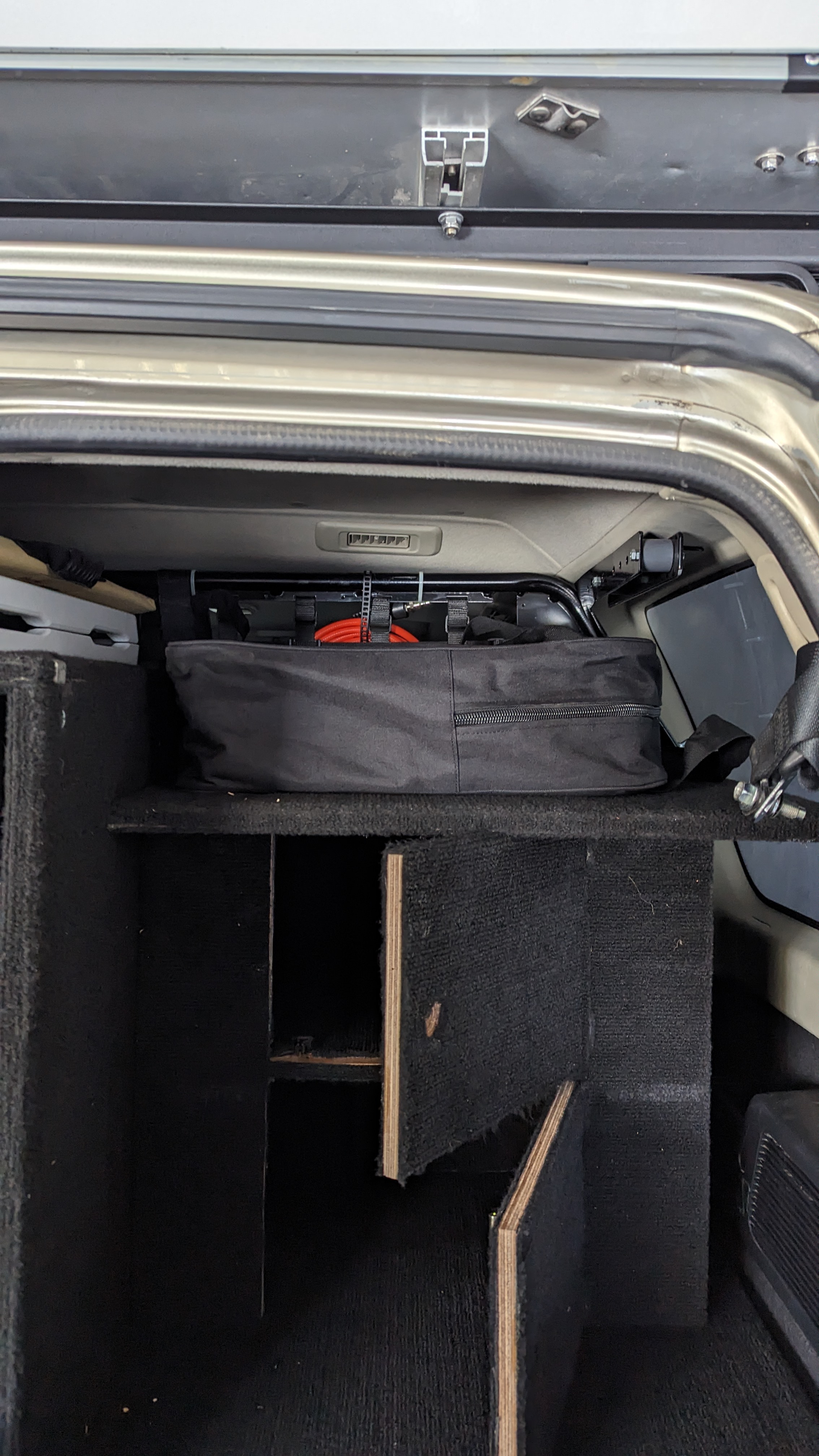

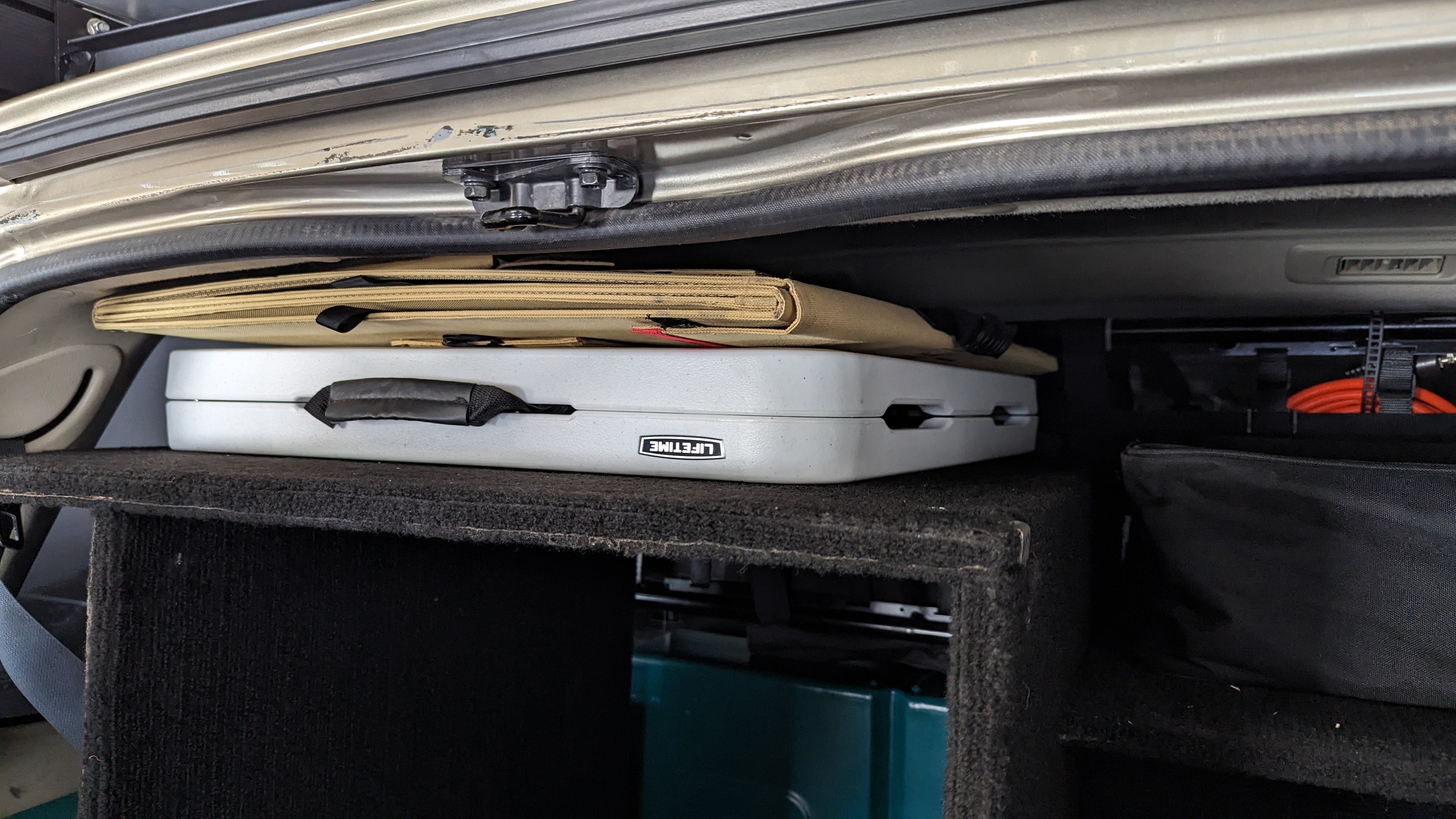

Here is some pics:

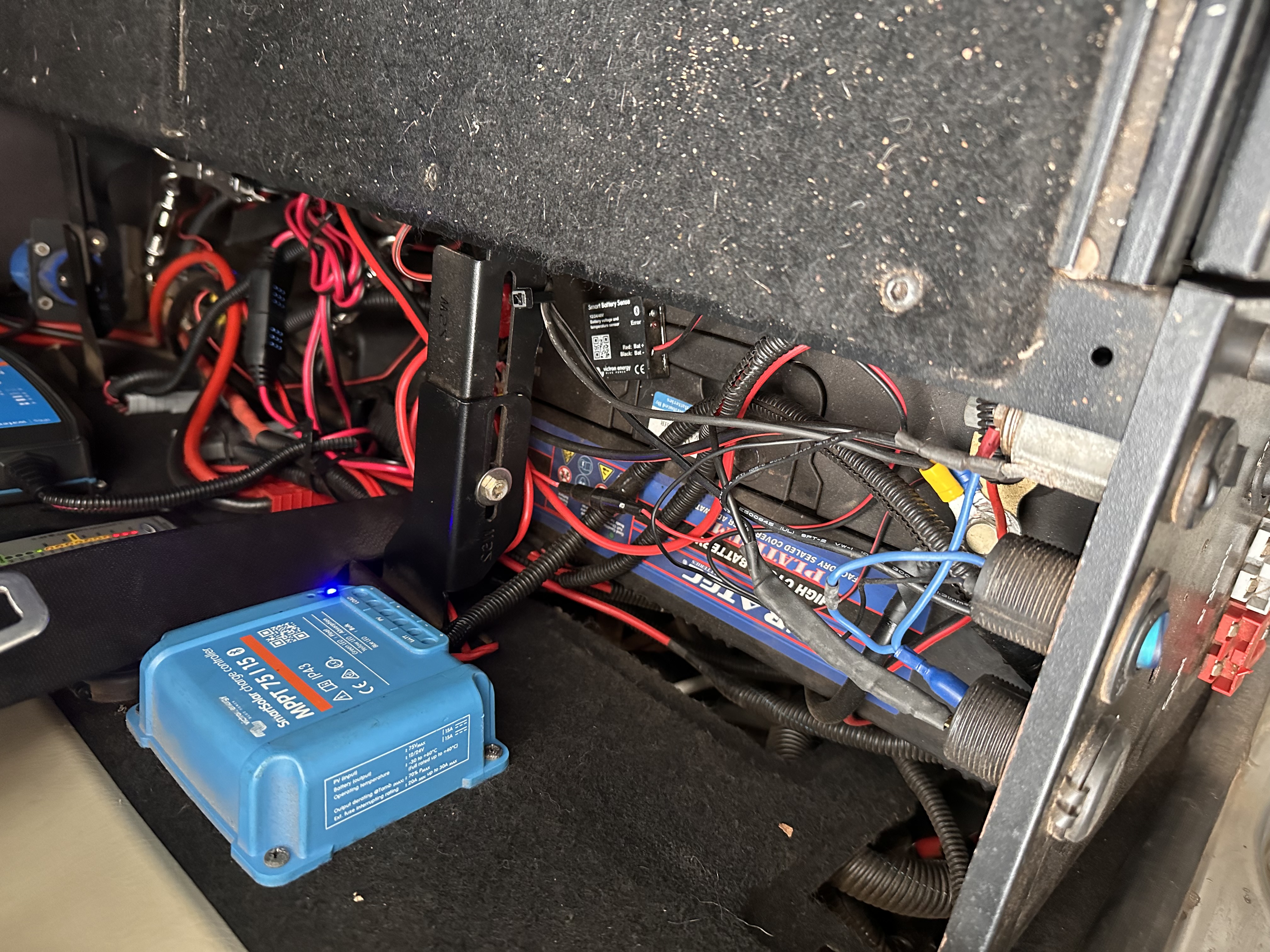

And here is the small space the battery currently sit in . 100ah is the biggest that fits in there

If the biggest problem is the battery moving, then I reckon that would be fairly easy to sort out.

Why not keep the drawers as they are but just fix the battery outside on top of the drawers, probably right up against the rear seats? Then put your compressor in the hole that the battery left and punch a hole in the front to feed the hose through.
However, like Peter says, if the problem is primarily a shifting battery then some bracketing to hold it in place better sounds the most straightforward.

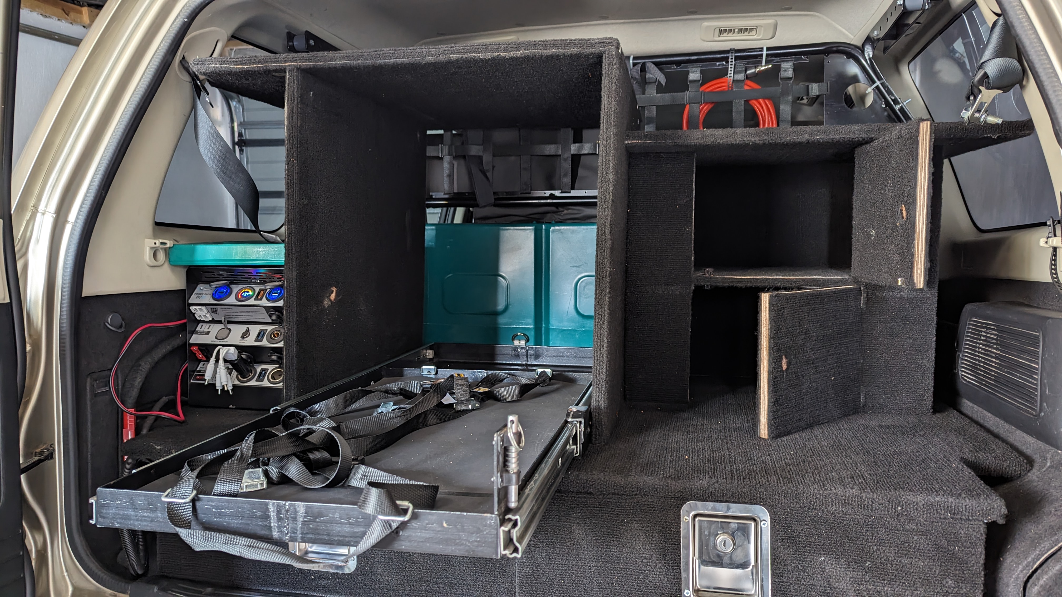

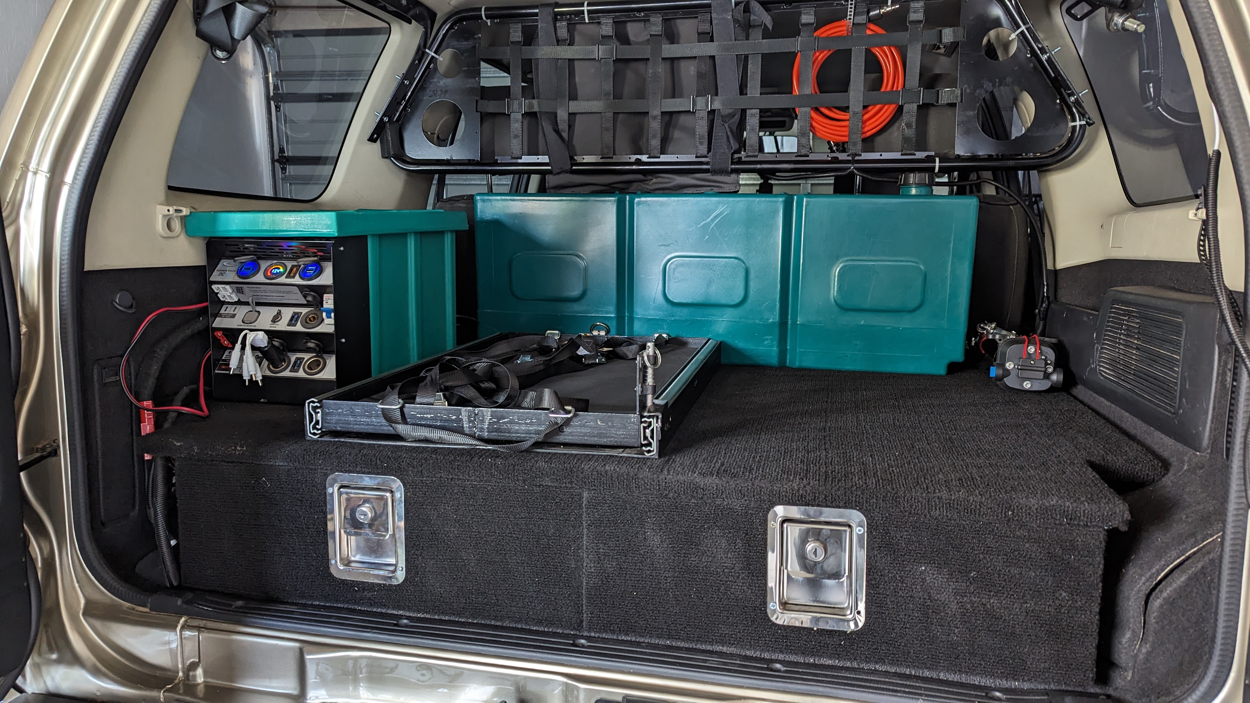

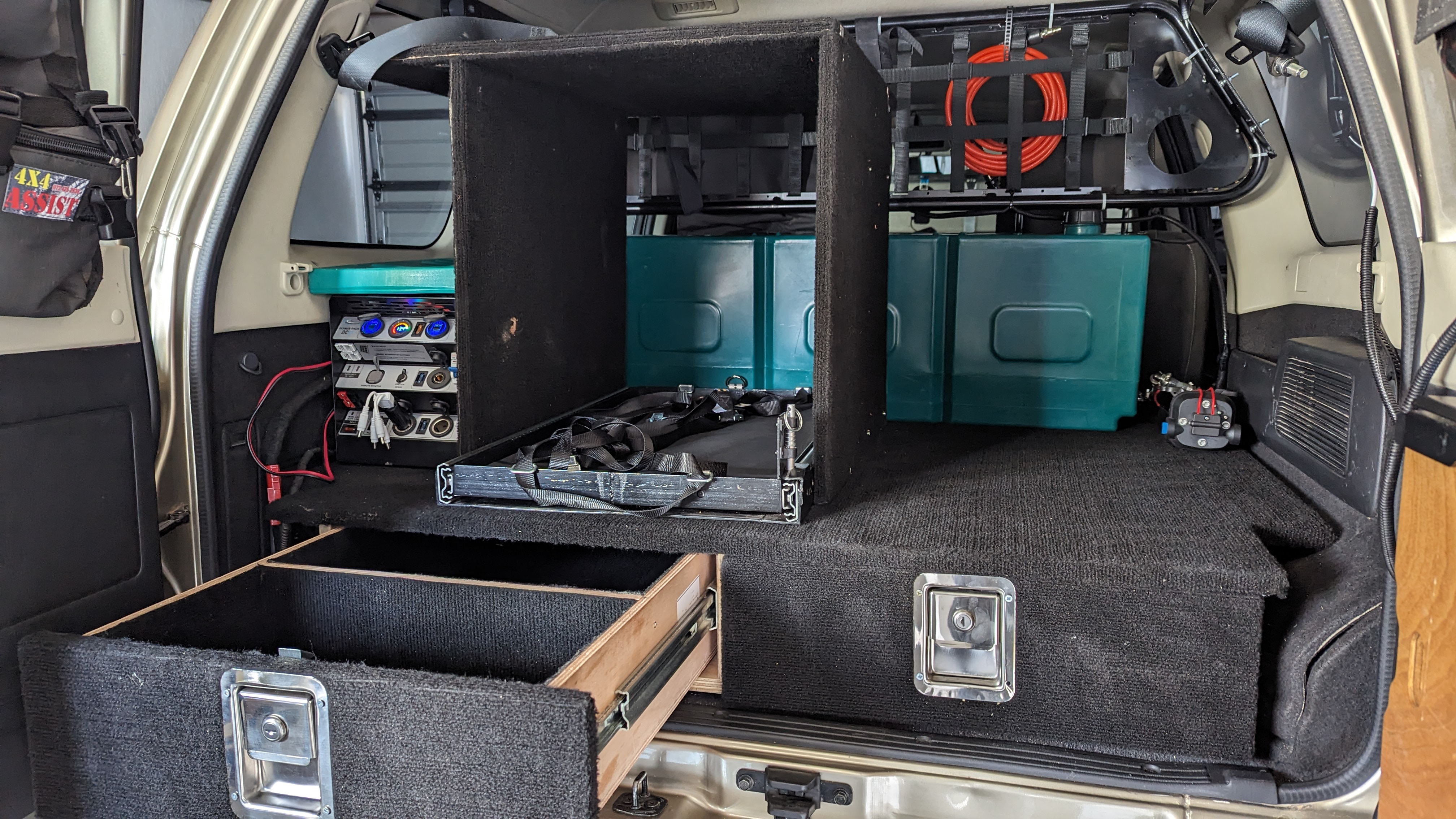

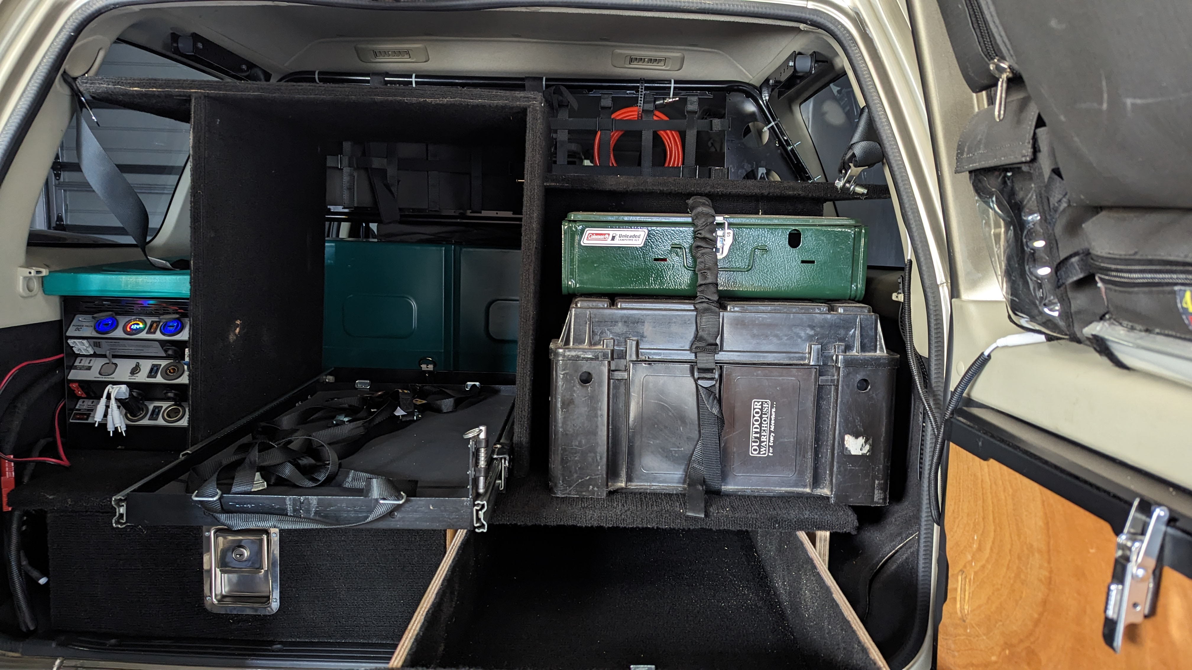

Hi Izak, This is my storage solution and works pretty well for me. I am using the NL battery box and 50 l water storage at the back. I just had to rebuild the bottom draw as the previous material I used wasn't strong. So I am in a position to take them apart for pics. Material I used this time are 18mm shutter ply for the outer frame and 12mm marine play for draws, shelf's and fridge enclosure.
Hope this will give you some ideas. I have an ARB compressor mounted in the engine bay.

ra_01 wrote: ↑18 Aug 2023 11:14 Hi Izak, This is my storage solution and works pretty well for me. I am using the NL battery box and 50 l water storage at the back. I just had to rebuild the bottom draw as the previous material I used wasn't strong. So I am in a position to take them apart for pics. Material I used this time are 18mm shutter ply for the outer frame and 12mm marine play for draws, shelf's and fridge enclosure.
Love your setup! Is that the barrier from Taurus that I see there? To have a water tank inside ….pure bliss, not like the ocean I carry on the roof!
