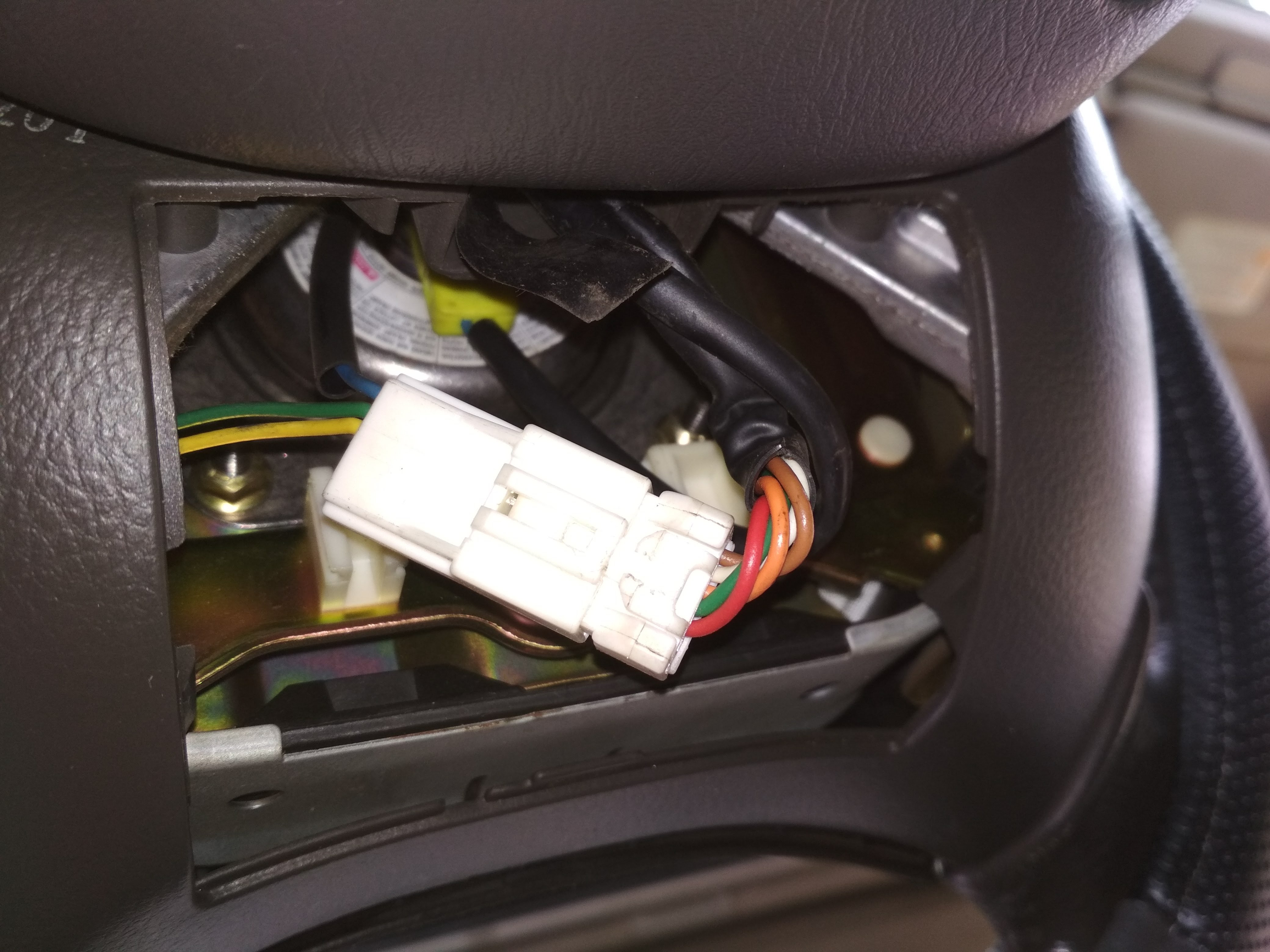

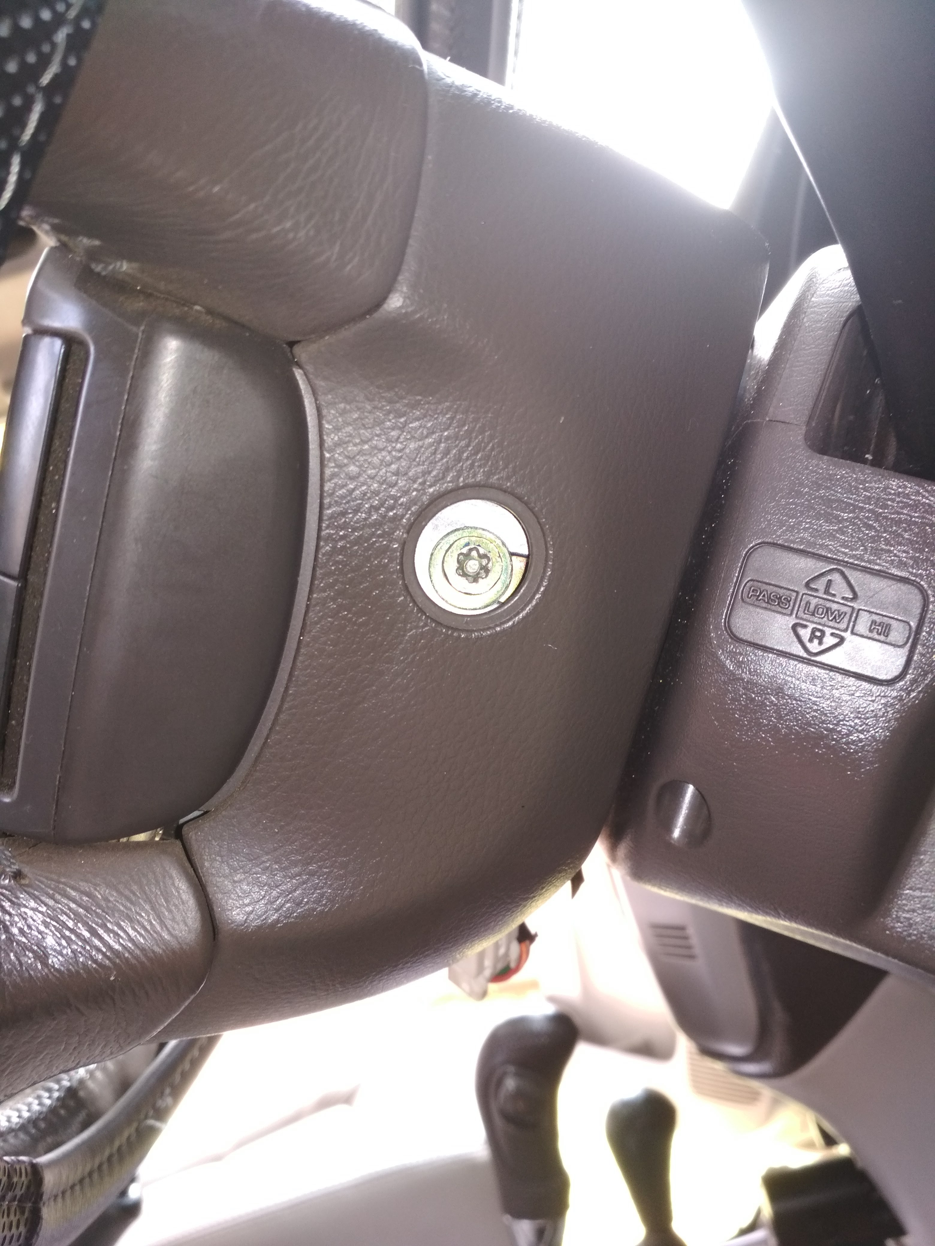

On the side of the steering wheel there are two holes covered by small plastic covers. Removing them reveals two torx screws. Unscrewing them releases the airbag. Note that the airbag is still attached to wiring so lift it carefully. Once the airbag plug is visible lift the tab to release the plug to free the airbag. Once the airbag is out disconnect the cruise control / hooter plug.

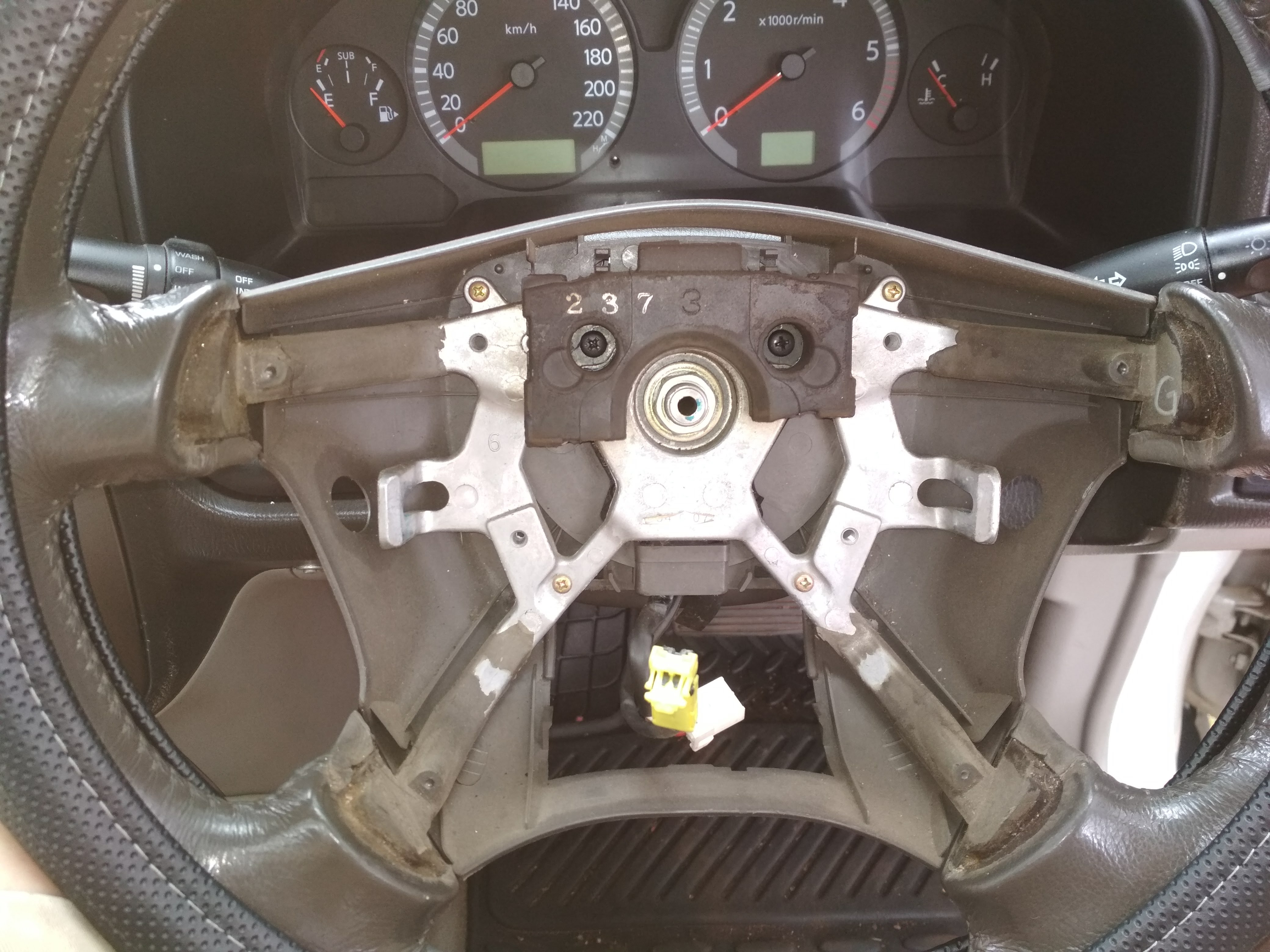

With the airbag removed the steering wheel can be removed by undoing the nut with your favourite socket wrench. Firmly hold onto the steering wheel while you undo it as you don't want to break the steering lock which really is not as tough as you think. Don't undo it completely. Once it is loose use the appropriate amount of violence to loosen the steering wheel. If you had removed the nut completely before this step you would likely have suffered a small contusion as it is very tight initially but accelerates rapidly to your face when it comes loose.

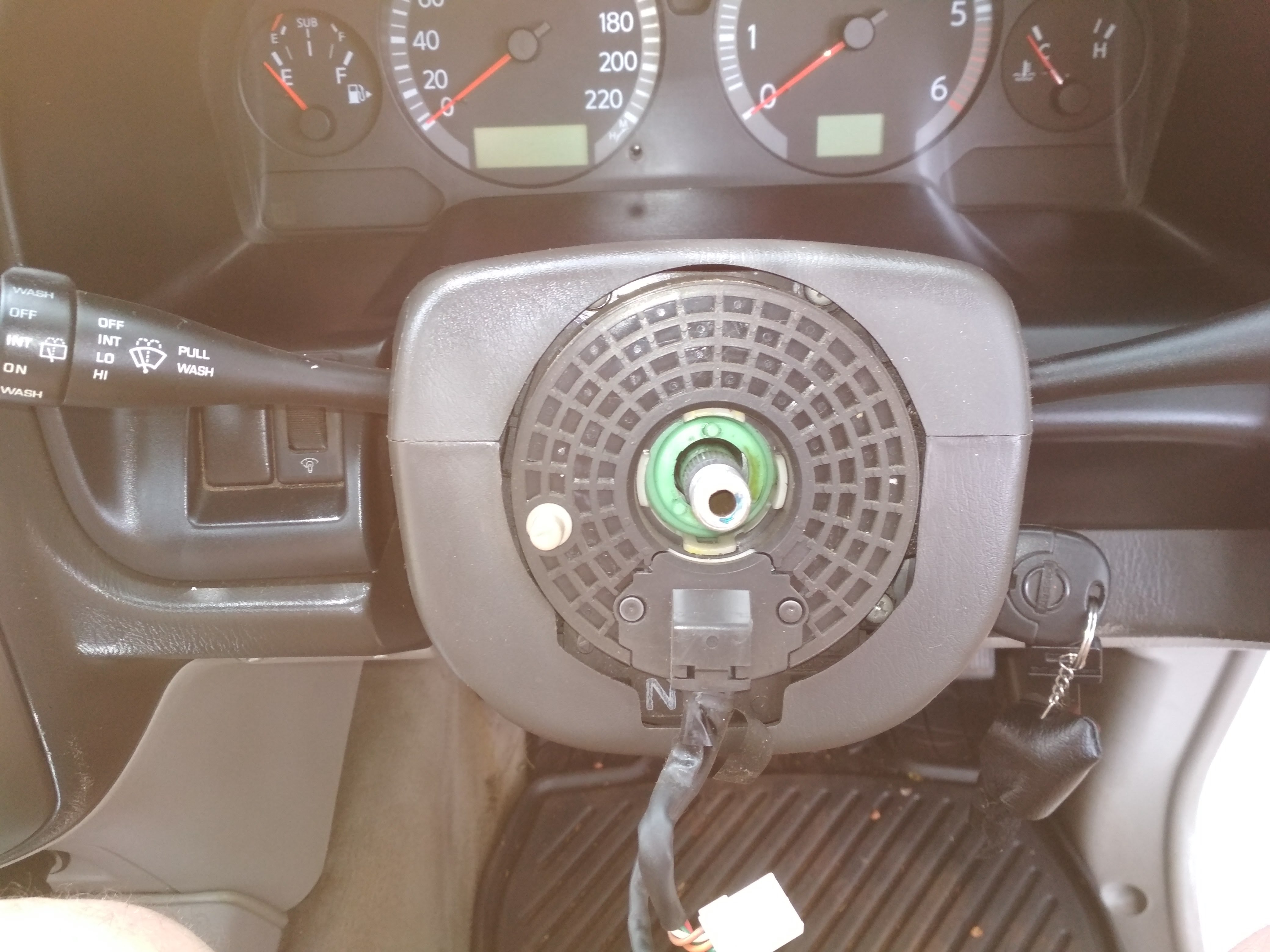

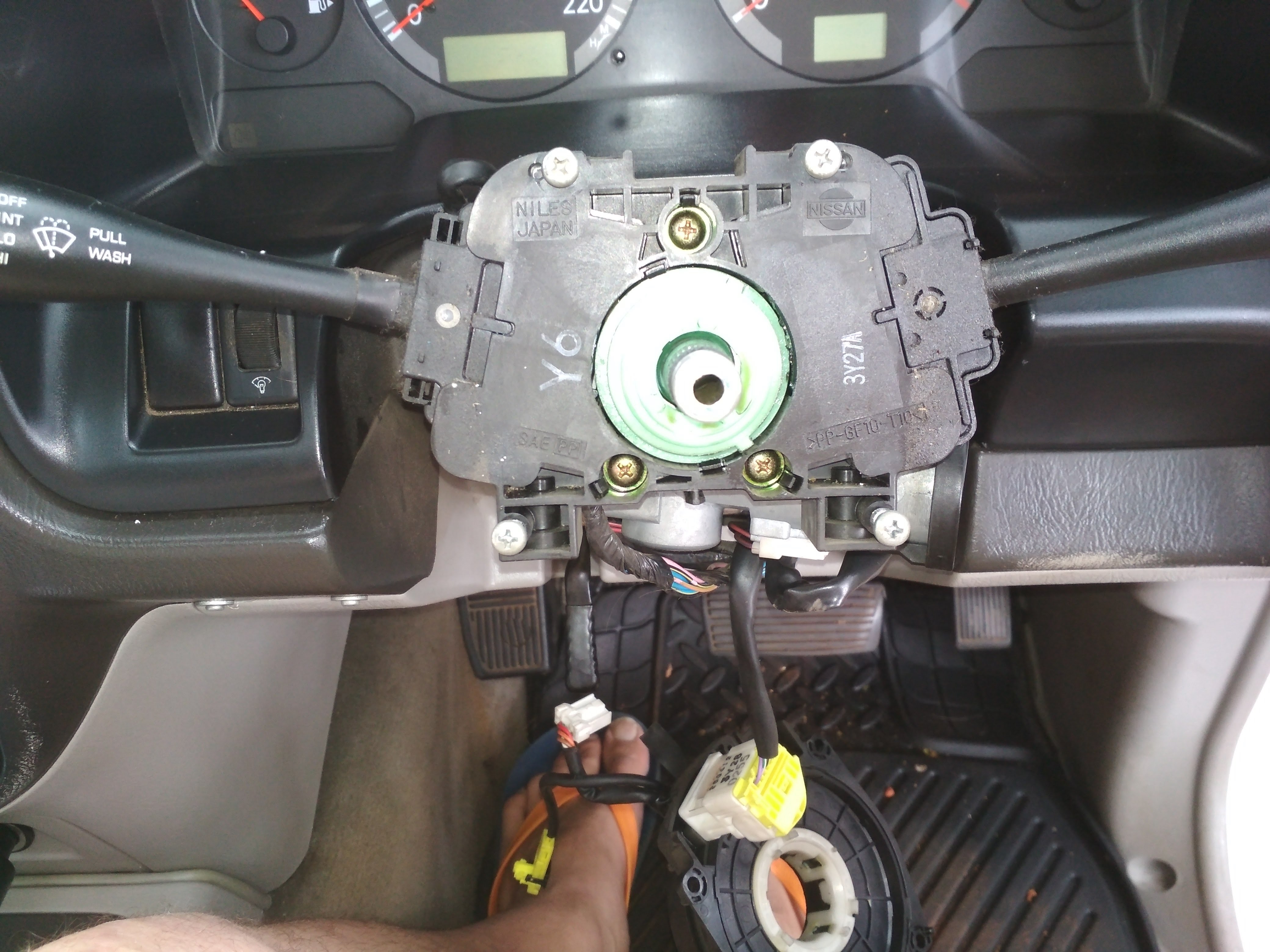

With the steering wheel removed you can finally see the clock spring. Notice that the four screws holding it to the steering column are obscured by the surrounding plastic covers. Remove the 6 screws underneath the covers to remove the covers. Once removed undo the screws holding it in place.
There is one remaining plug holding the clock spring in place. Once disconnected the clock spring is ready to be inspected. Notice the green plastic surrounding the steering shaft. It is important to keep its alignment in place as it terminates the turn signal, so a misalignment here means the turn signal will not terminate at the correct steering wheel angle. Notice the three bumps. There are three holes in the steering wheel that must line up with the when reassembling.

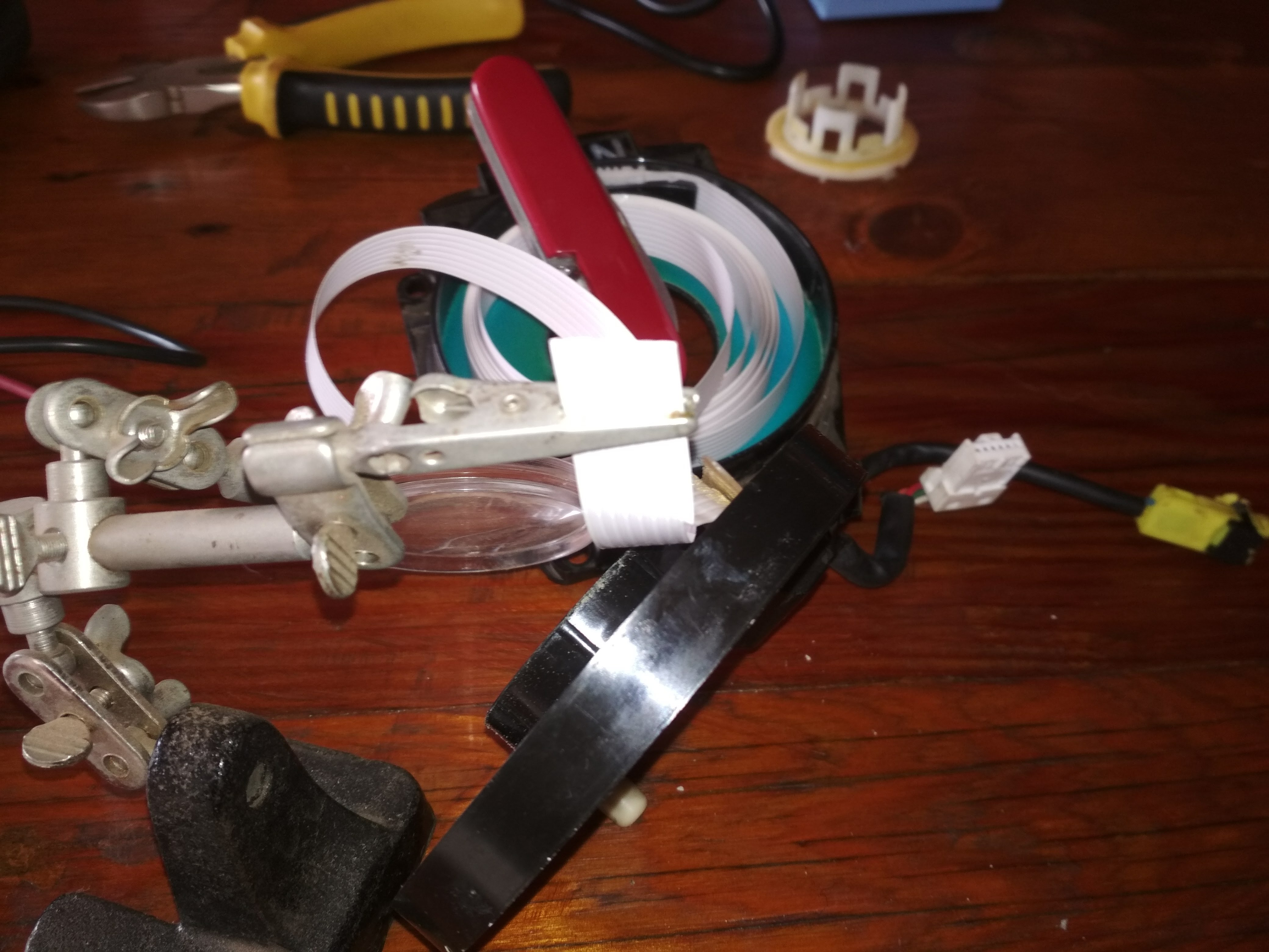

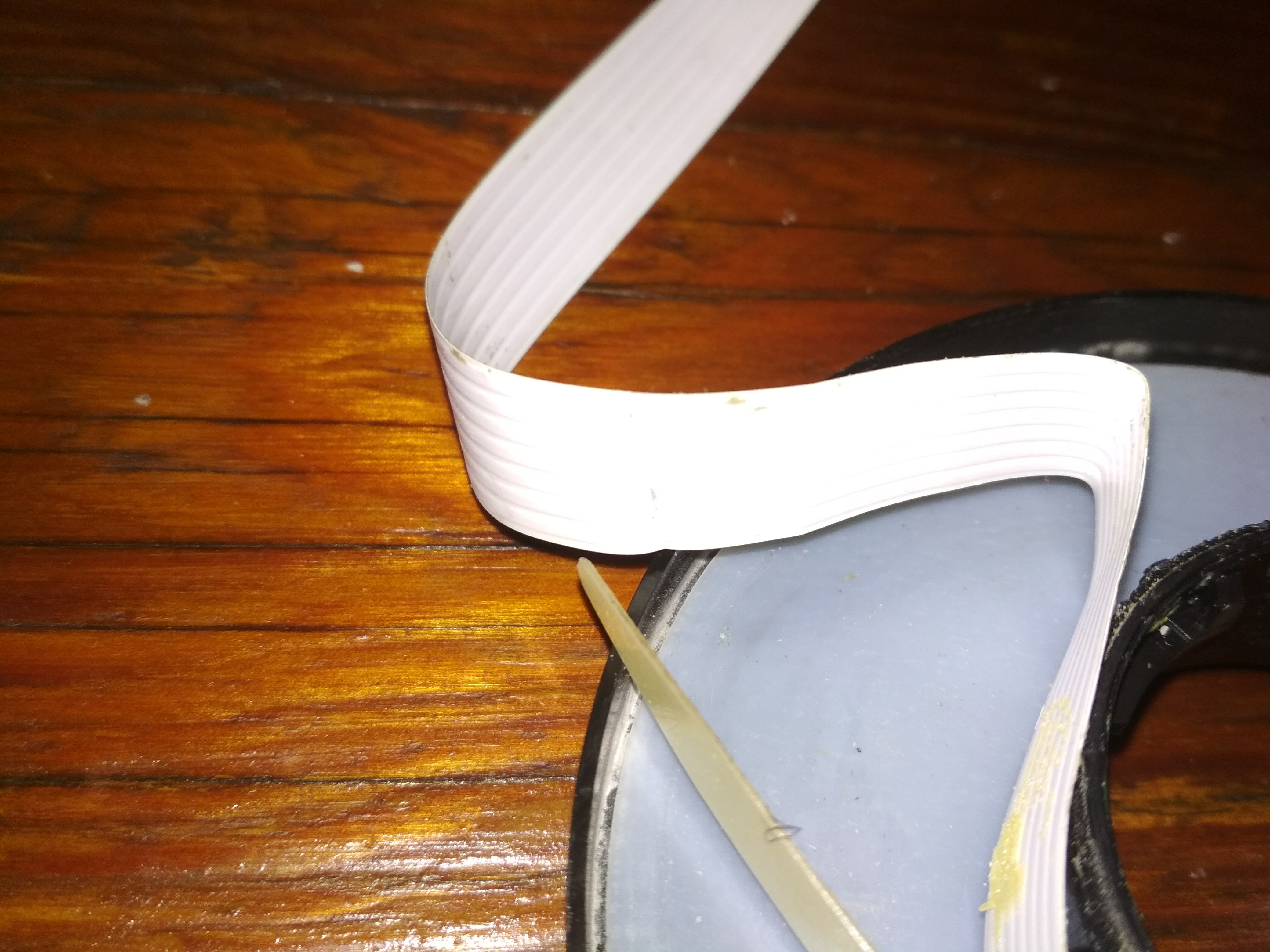

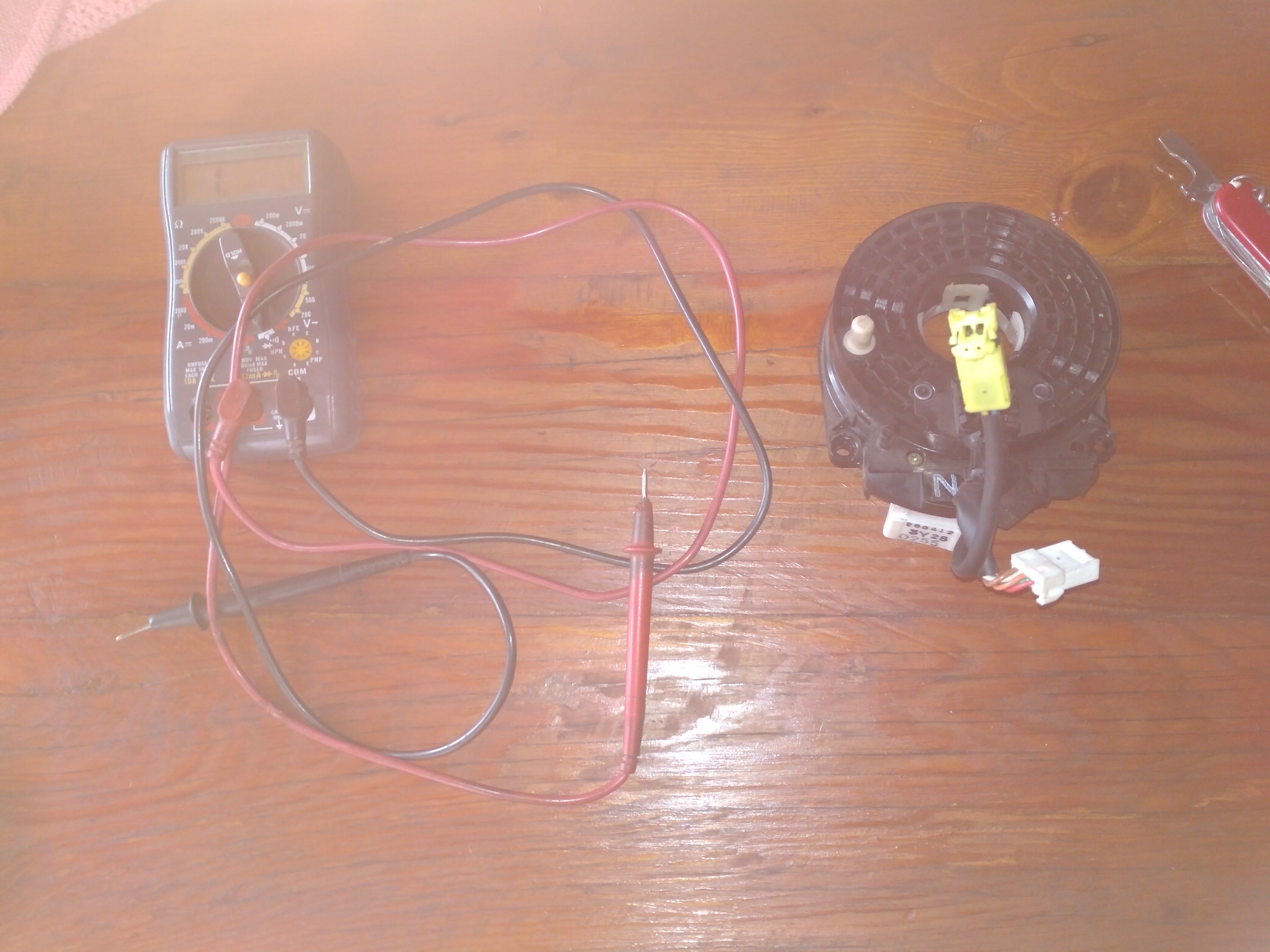

You can safely use a continuity tester on the clock spring as there are no active components that can get damaged here. Do note that you should not use a multimeter on the airbag as the small current might cause it to deploy. The clock spring is held in place with a small plastic clip in the center that can be popped off. Once off the clock spring breaks into two pieces, connected by a ribbon cable.
There is a 180 degree bend on the inner radius for reasons I cannot explain. It seems obvious that it would break here at some point. With the multimeter I detected that all but one of the seven tracks had broken here, explaining why the hooter was still functional.
I flattened the cable at the bend, completely severing the remaining track and used small scissors to trim the ends. With a slight overlap I used my soldering iron to solder each track. I applied some epoxy and insolation tape to secure the two together in the hopes the next fracture would be elsewhere. Unfortunately I forgot to take a photo of the end product.
I reassembled everything in reverse order ensuring the alignment of the steering wheel with the clock spring. Make sure it can do two complete turns in either direction otherwise you will snap the ribbon off with the first sharp turn. Also make sure the green plastic bit is aligned correctly with the steering wheel otherwise your turn signals will not terminate at the correct angle and you'll have to disassemble everything again the way I did.
