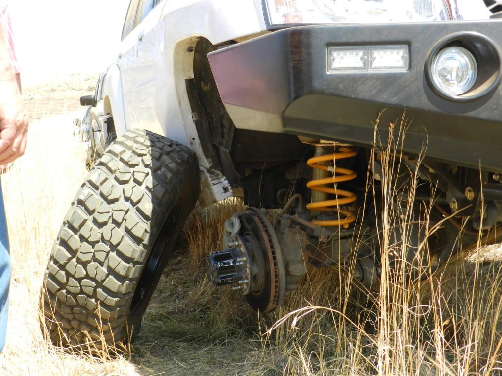

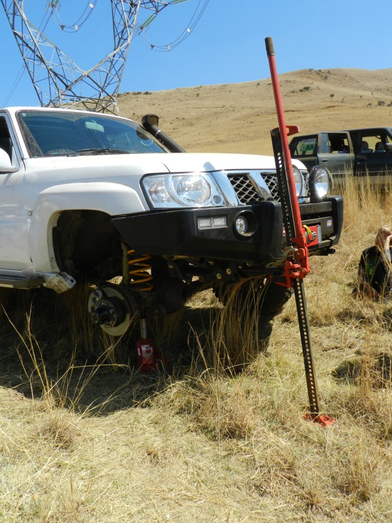

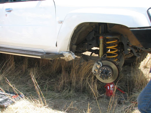

Kobus. again I'm going to say it, purely cause its very important....... If you get new rims ( Dick Cepek or similar ) then you definitively need to either get the center hole machined with a radius if it doesn't already have it.
This happened on the Patrol 60th anniversary at 3 provinces a few years back. Mags were fitted to a patrol without the radius being machined out or spacers fitted. over time the wheel nuts loosened themselves due to the rim/mag not sitting flush with the hub. luckily he was only doing 20 odd km/h when the wheel fell off and damaged the Patrol bodywork!!!!! You don't want this to happen at 120Km/h !!

Hallo Ricster, thank you so much for the advice. If I understand you correctly the the hub has a radius therefore the rim must have a matching radius?
Posts: 6138
Has thanked: 1124 times
Been thanked: 1038 times
Re: Rims for 2013 GRX
Not necessarily a radius. The hub has a spigot, and the rim must fit over that, but there is a very small radius at the base of the spigot.
The rim can have a small radius, or a chamfer.
The important bit is that the rim must pull down onto the flange properly.
