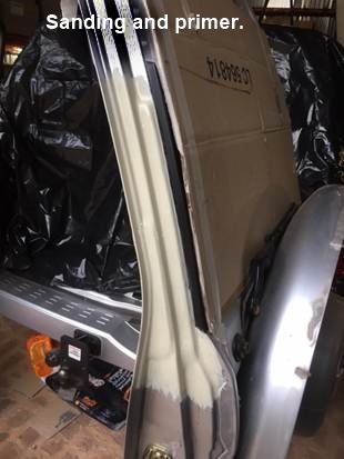

Barn Door Repair
When I bought my Patrol, it had a significant crack on the outer skin of the right barn-door side,
more or less in line with the bottom of the window.
During my initial hunt for a Patrol I noticed cracks on several of the vehicles which I looked at.
The crack on the specific vehicle I bought was one of the worst.
I read up on this forum as well as on the Australian Patrol forum about this problem.
A popular culprit “has been identified” as bigger / heavier spare wheels as well as slamming of the door.
My vehicle has a standard size spare wheel…. This argument is not valid in my case.
However, it had a sagging / misaligned RH barn door.
Below I will describe the method of repair which I applied to repair the cracked barn door.
In my opinion the root cause of the barndoor cracking is the design of the door itself.
The crack on all the Patrols with this problem appears to be always exactly in the same position.
The doorframe has been reinforced with an additional panel on the inside.
The crack runs within 1mm above this reinforcement plate.
(See Image 1)
When closing the door one needs to apply a certain force in order to ensure that all 2 door locks (bottom and top) engage properly, otherwise the “door open” signal on the dashboard stays lighted. However, forcefully closing the door puts a bending stress on it. The stress is highest in the middle of the door - at the bottom of the window. It has the same effect as bending a thin piece of metal up and down over a table edge until it breaks off.
In this case, it is the reinforcement inside the doorframe representing the tables edge.
I am quite certain that this problem would not occur If this reinforcement piece were to be significantly longer at the top. The forces created when closing the barndoor will obviously be even higher when the hinges are worn causing, a sagging of the barndoor.

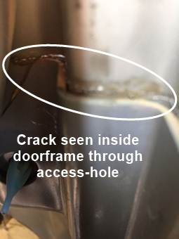

2) I cut a strip ~ 150 x 20 mm on the inside of the doorframe as access-hole with a Dremel tool at the height of the cracked outer skin.
(See Image 2)
(See image 3).
This picture was taken through the access-hole and shows the crack of the outer skin from inside the doorframe, exactly were the reinforcement piece ends.

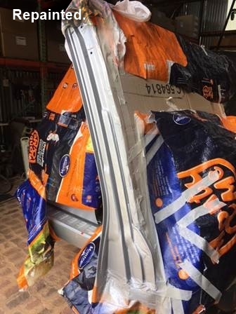

After the reinforcement process as described above was complete, the remaining task was to smooth out the reinforced area, then apply primer and paint.
(See Image 5,6 and 7)
