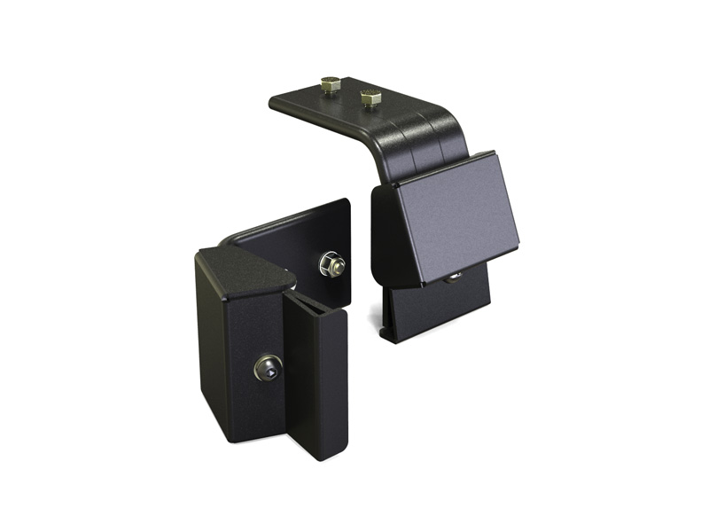

Hi Folks, my first post here, and need advise on the Front Runner roof rack gutter mounts please.
So a mate of mine just gave me his Front Runner roof rack, he used to have a 2007 LWB GU. I have a 2012 GU. I believe that Nissan have at sometime changed the design of the roof rain gutters.
They are about 20 degrees upturned now. This does not allow the clamps to hold, initially we were able to fix the rack, but it is not secure for offroad use, and also with loading.
As you can see on the image, the clamps refuse to hold securely. As the bottom threaded clamp is torqued, the clamp L-shape part slides off.
I was wondering if anyone here has tried the newer style clamps from Front runner on these newly designed rain gutters from Nissan?

Re: Front Runner Gutter Mounts
If I look at the bracket that holds onto the underside of the rail, it looks like a "homemade" conversion. On my roof rack the bolt that runs in the "tube" that the nut fastens up onto doesn't have the same amount of play in it as it looks like you have in yours. Mine is a 1999 model GU (Y61) and I think my rails are also slightly upturned ( will have to check though) and mime clamps solidly onto the rail. I'll take a pic tonight and post it here for you to look at. My roof rack isn't a fromt runner, but an African Outback, but the principle remains the same.
I had a simmilar front runner model with same issues modified the bracket with tube below the nut to stiffen it worked well dont have picks becouse I dont have the rack any more. Also there is a allen key grup screw to help it towards the car
I had a piece of pipe that I cut to just go into the bracket and then made the hole in bottom bigger thats the bracket hole .the rod bends it makes it slide off
Hi Vanhack .. O K .. Had similar big headache with Front Runner n previous PATROL [the G Q aka THOR]
On the side of that foot that comes down, is a allan keay headed bolt [about 5mm circ] LOOSEN that FIRST
Then put that lat clap underneath the gutter -- Then tighten the "leg" nut untill the clamp STARTS grabbing on the gutter -- NOW take that allan key [size 6 i think] and tighten that little bolt on the side untill it grips .. not using force] NOW final tiughten the top nut and fianl the allan key tightne [HAND tighten]
ALSO -- work on opposite side alternately -- Then you have a very STRONG roofrack -- one I loaded on Thor with almost 200 Kg and did teh Namib desert crossing [same gutter / same rails/ same Roof carrier]
GUTTER FITTING.jpg (117.35 KiB) Viewed 9919 times
O K -- what Oompi was trying to say == That ALAN Key bolt must start as loose -- BUT befor the top nut starts pulling the clamp away from the gutter, you must tighten that little allan key bolt .. untilli it holds that 8mm bolt in place -- THEN you tighten on top, the final again, tighten the alan key thingy.
Note of note. Take 15mm standard green water hose PLASTIC, cut just about the length of the clamp foot. Slit open top to botttom and fit over the steel foot that stands inside the gutter --
Prevents rattles, prevents RUST en prevents damage to paint and gutter ..
