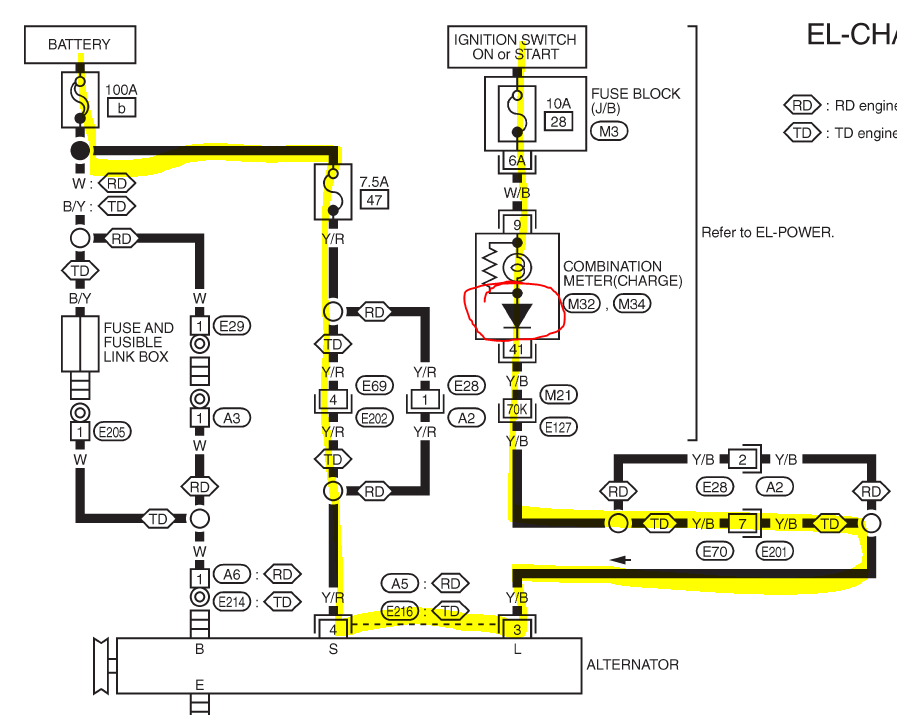

Peter - I'm intrigued. You mention that you've also had a failure where the warning light did not trigger. But that if anything goes wrong with the warning light circuit or the warning light blows, the alternator will not charge ? How the heck does this work ?Peter Connan wrote: ↑14 Nov 2024 08:18 Nice to hear you had some great leopard sightings.
I have also had an alternator failure that didn't trigger the warning light. Well done on finding and repairing the issue.
It's probably also worth knowing that if something goes wrong with the warning light or it's circuit, the alternator won't charge.
But I've decided I'm going to put a voltage meter in the dash somewhere in any case - so that I can instantaneously see the voltage when driving. I've just got to decide where, exactly...

My knowledge of electrickery is notoriously patchy, but my understanding is that the lamp is in a part of the circuit that, if broken the alternator doesn't switch on. Somewhat like the low-tension/switching circuit of a relay?

Ian, that light is very clever because both sides are connected to (a different) positive! The one side goes to the battery's positive (via the ignition switch), the other side to the charging output on the alternator.
If the battery's voltage is higher than the alternator's output voltage, current will flow from the battery to the alternator side and the light will come on. This means your car's battery is providing power to all electrical circuits. When the alternator output is the same as the battery voltage there will be no potential difference between the two sides. As a result no current will flow and the light will go off.
While the battery is being charged the alternator output will actually be higher than the battery voltage. To prevent the light from coming on, the circuit has a diode (circled in red) that only allows the current to flow in the direction of the arrow. This ensures that you're warned when the battery voltage is higher than the alternator voltage (bad!) but not when the alternator voltage is higher than the battery voltage (good).
According to the circuit (the bit between connection L on the alternator and the ignition switch), a blown bulb cannot prevent the alternator from charging. A break in the circuit between connection S and the battery will prevent the alternator's coils from energising which will prevent it from charging. This will probably also prevent the light from warning you because it is then only electrically connected on one side.

Thanks Christo. That makes sense. But I have gathered my battery warning bulb must be blown. No light on it at all. Will see if I have a chance to fix this all the coming weekend.
