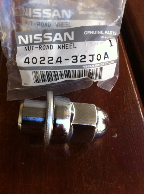

- Landcruiser 80 series oem wheels 16x8j 0 offset, gunmetal colour, bored to fit the Patrol 110.1mm center bore, temporary 31's/265/70/16's Bridgestone 18's. I wanted a set of 16's with better offset than the 7j 15" steelies my car came with, after fitting the wheels and driving the car for a couple months now saving for tires, I noticed a wobble between 80-100kmph. This is because the 80 series wheels needs flanged nuts, but the Patrol studs are a different thread pitch, so using normal nuts on the wheels, not the flanged nuts creates this wobble. All said and done, I will be going after market Dynamic or Dirty Life 16 or 17's with 35's soon....watch this space!

There is a flanged nut of the correct pitch.
It was used on the early GU's.
But they are scarce. And I am not sure if the diameters are correctfor the Cruiser wheels.

They were used on the 4.5 GRX mags..
You can get them from Nissan at R150 per wheel nut.
(Last time I checked in 2017)
Or perhaps from partsquip.
Toyota's thread is 1.5mm, NIsssan is 1.25mm. But also not sure if Nissan wheel nuts would work on cruiser rims. (dont know if lengths are the same)
