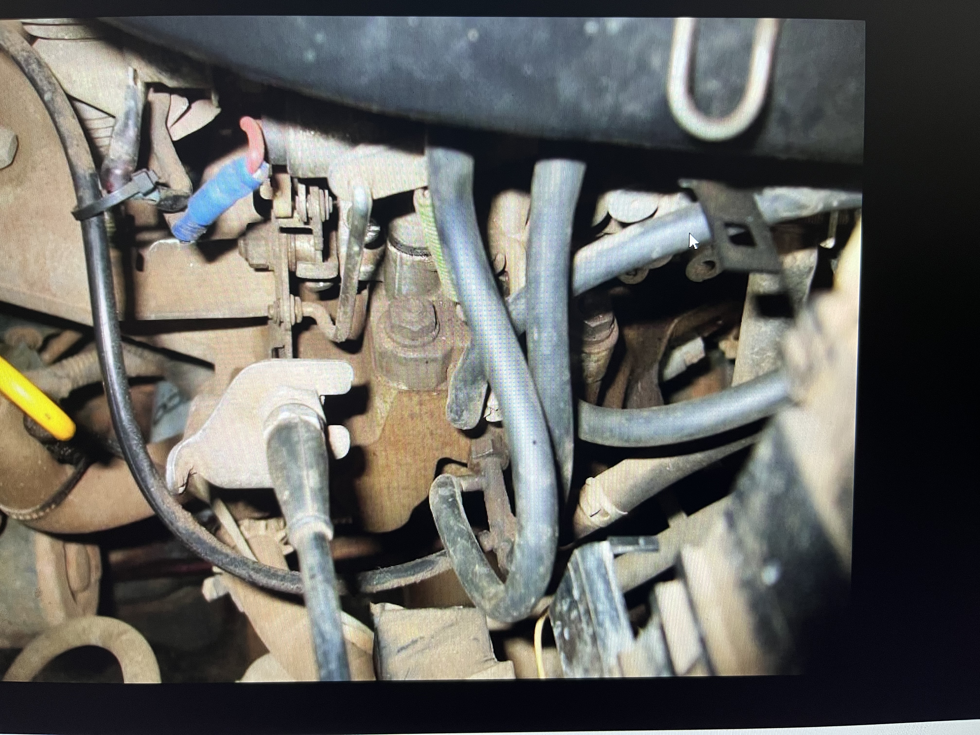

Hi Guys,
So I recently removed my TB42 intake with carb to replace all heater hose fittings, heater hoses, fuel hoses, and any vacuum lines that were suspect.
After putting everything back together, my engine won't idle well, was first over-fuelling couldn't hold a steady idle, and was spluttering & stuttering and wanting to die.
With this in mind, I realised I could have by mistake adjusted the idle mixture screw while the intake/carb was off the car. So I set about trying to get a could idle by adjusting the mixture screw, this didn't help anything.
I then had a look at the vacuum lines, and after much searching I made sure all vacuum lines were at least to my knowledge all in their right places.
Still idles and runs like before.
I didn't touch anything else other than the mentioned heater components. How did this issue happen?!?!?!?
I didn't mess with the timing, or distributer at all, not the leads, plugs anything like that, and the car ran perfectly well/fine before I started and finished my work on the cooling system.
So What could I have done to cause this issue??
Next I am going to look if I bent the float arm, but don't know how I would have done that.....
Also I noticed at one point that there was some fuel in the vacuum lines, I think from flooding the carb/engine from all the starting trying to figure stuff out. could this mean anything?
Any advice is appreciated, this is really frustrating me now :thumbdown: :thumbdown: :thumbdown:

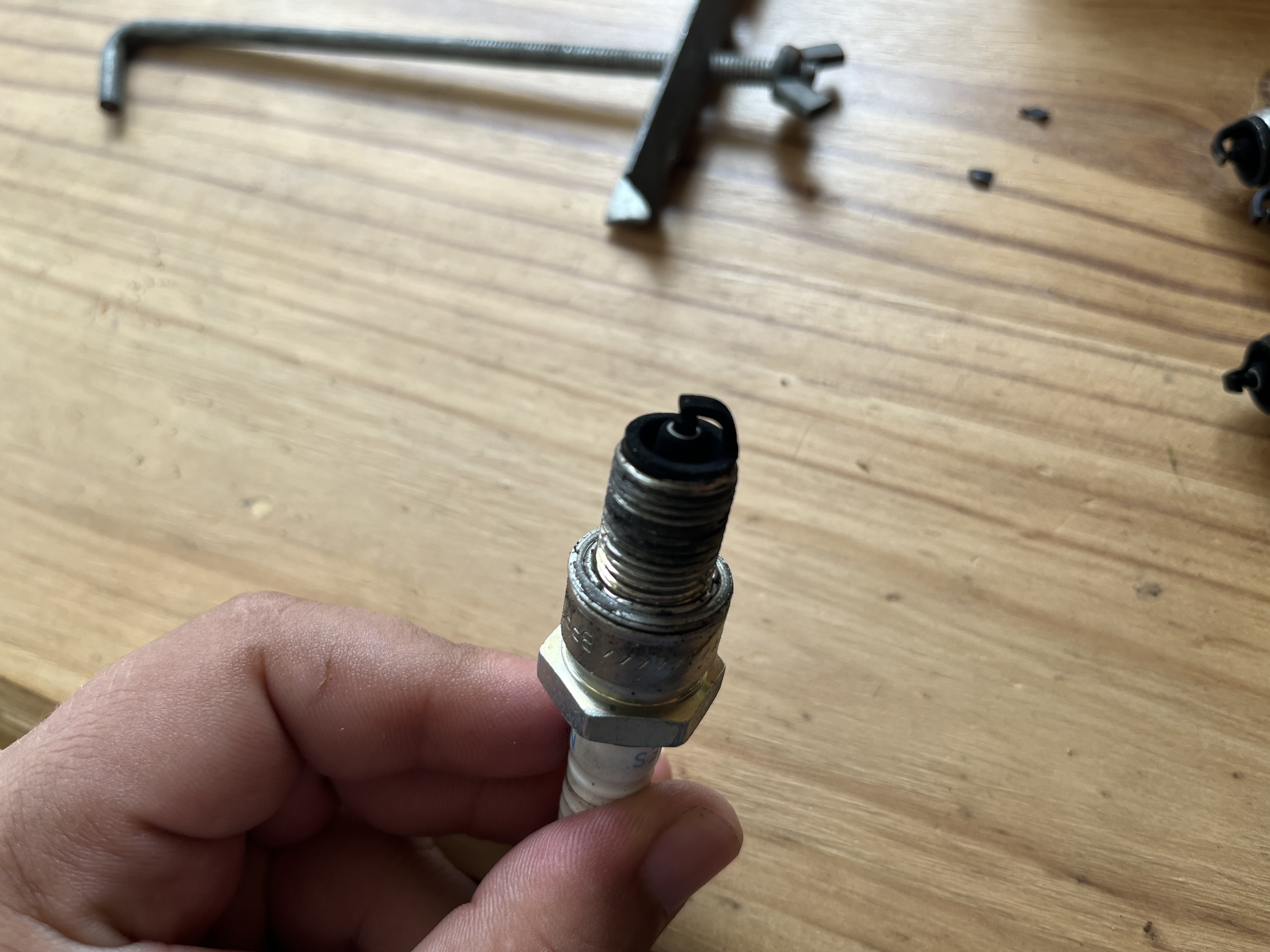

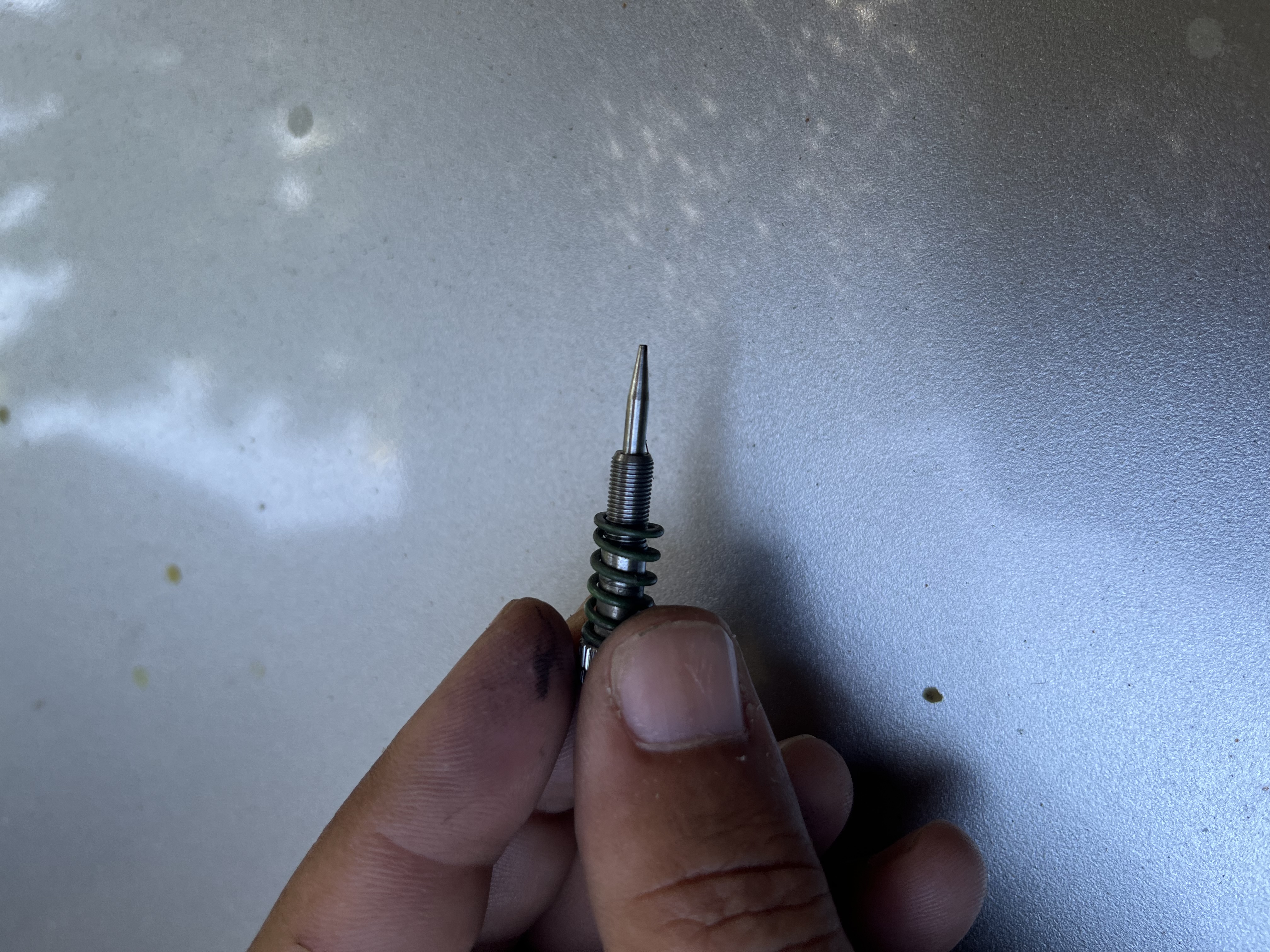

btw this is what the idle mixture screw tip looks like, I just wanted to inspect it to make sure its not damaged, does this look fine??

It also seems like adjusting the idle mixture screw does nothing while the car is idling!?

Is the idle cut-off solenoid working?
You should be able to.feel it click if somebody switches the ignition on and off while you touch it.
I haven't looked at an idle screw in several years. That one looks a little blunt but I could easily be wrong. Either way, that should not give you zero response.
Is the hole clear?

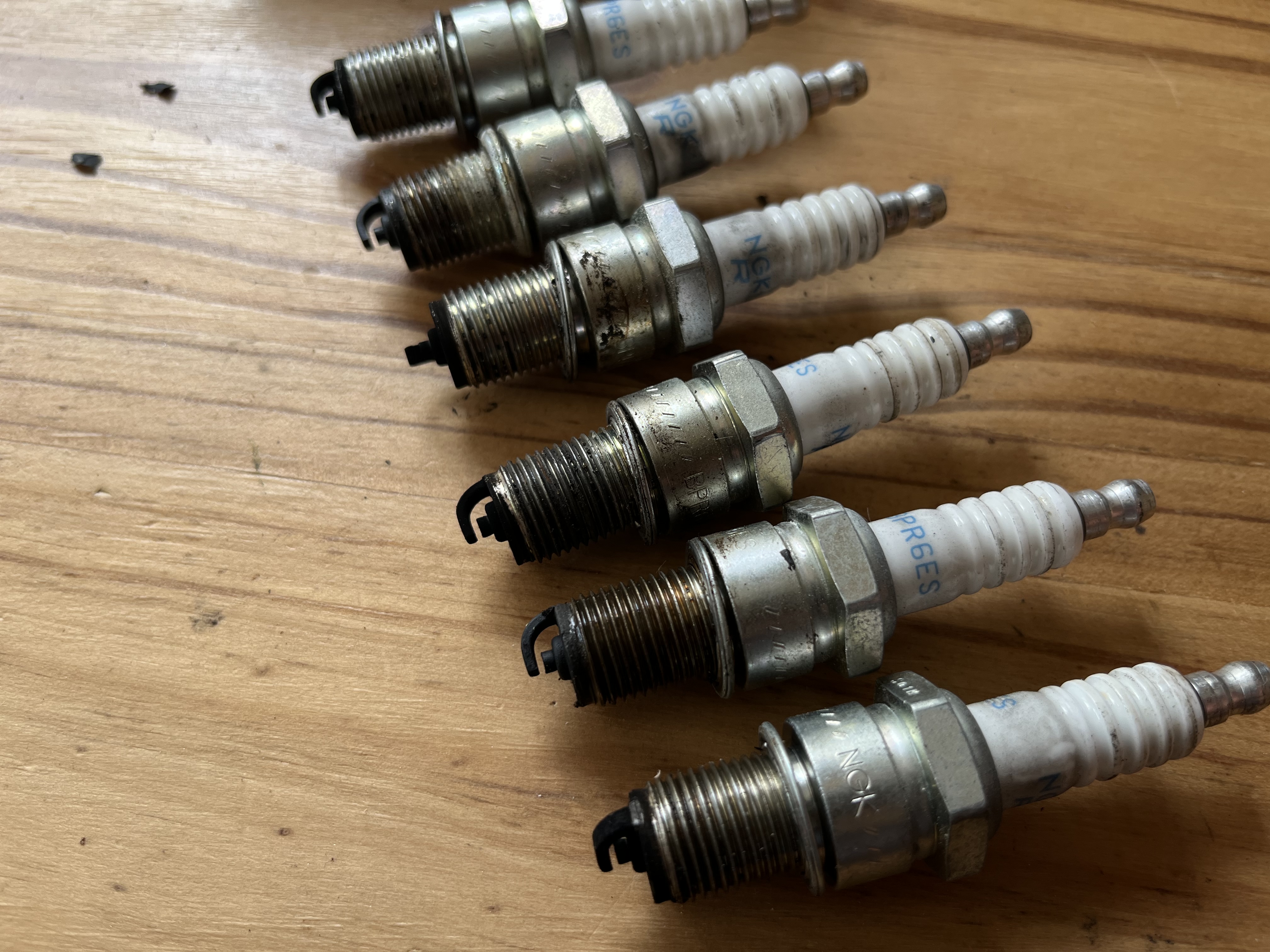

So,
After a lot of thinking, checking etc etc seems like I've sorted the issue.

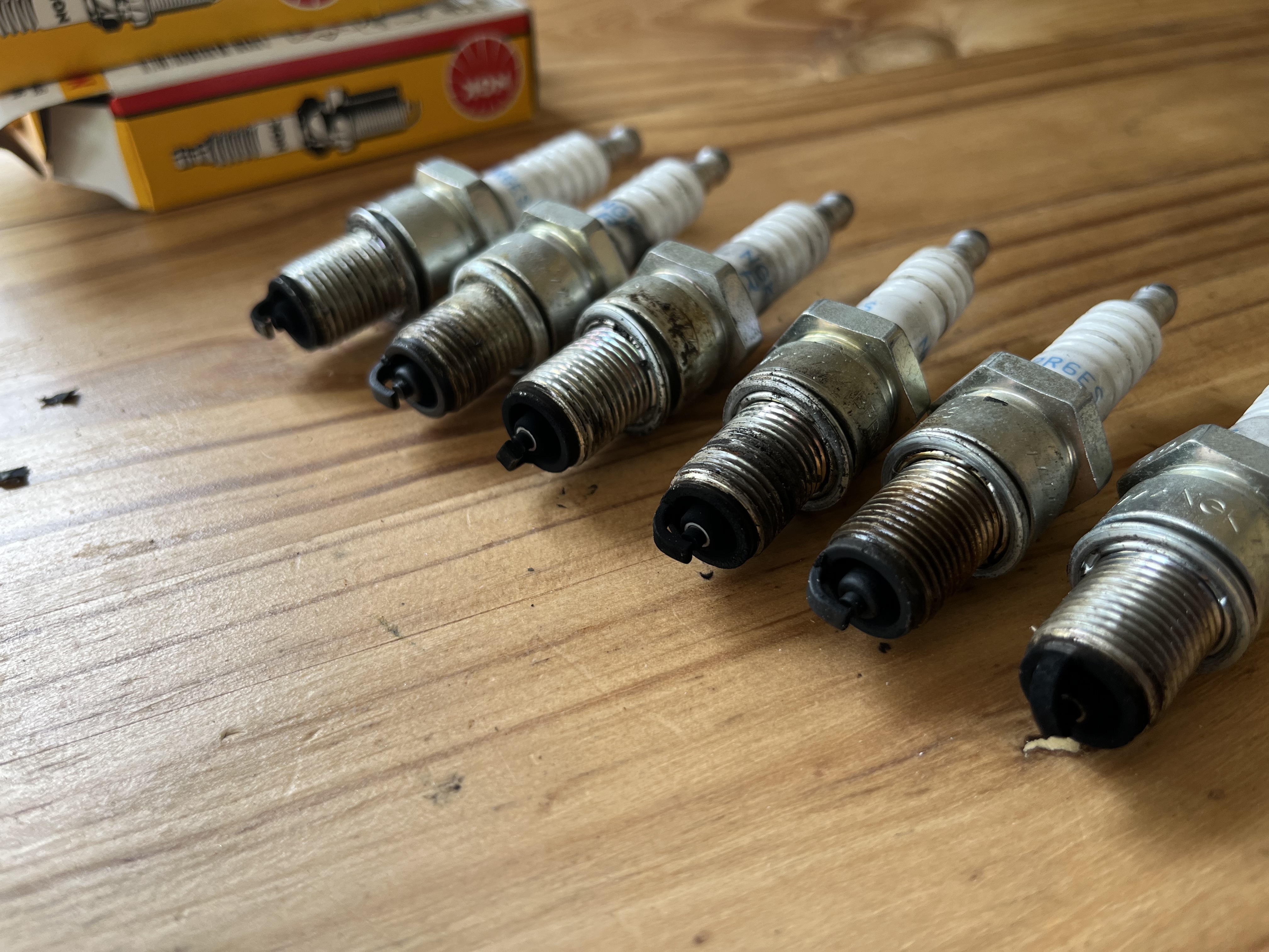

Changed out the plugs, to new NGK BPR5ES plugs, and the TB42 is running well!
The old ones, with fiddling with the carb too much, and whatever else was going on with the over fueling seemed to have fouled the plugs:

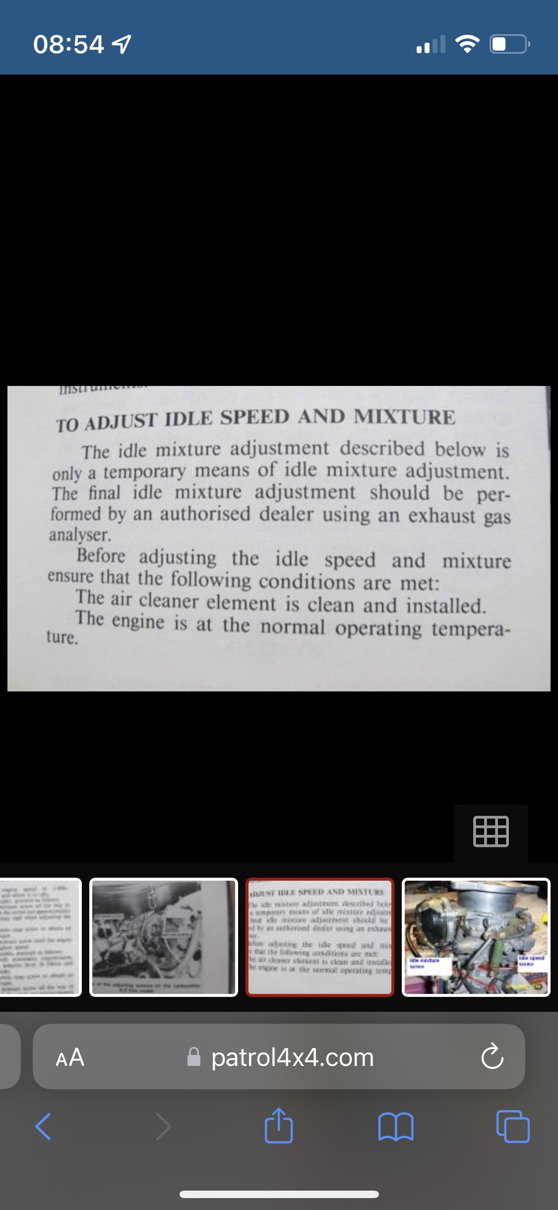

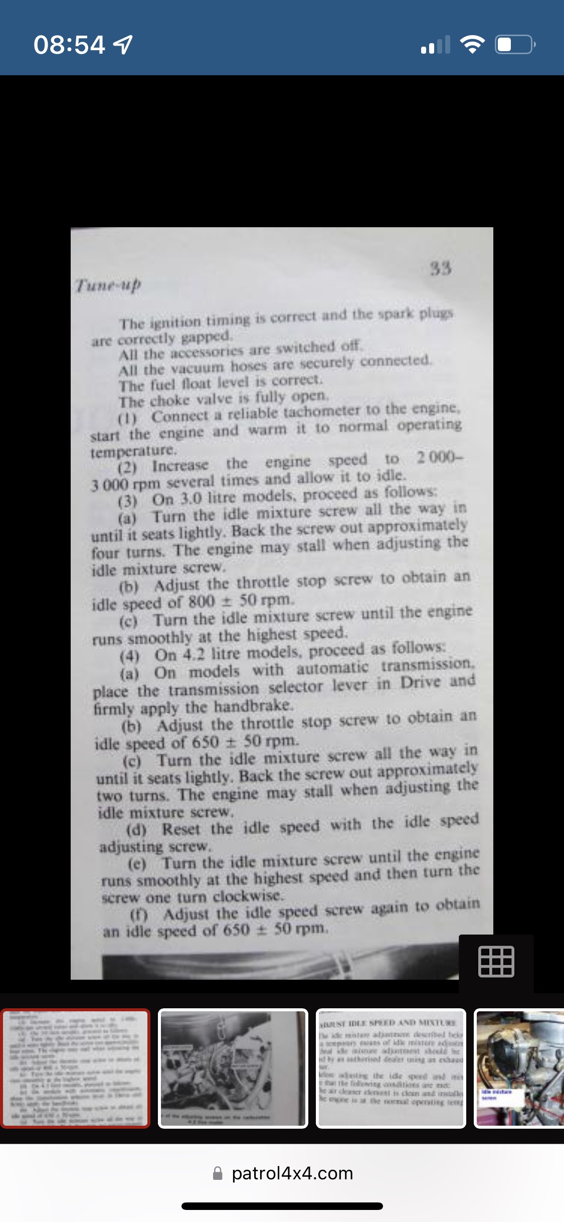

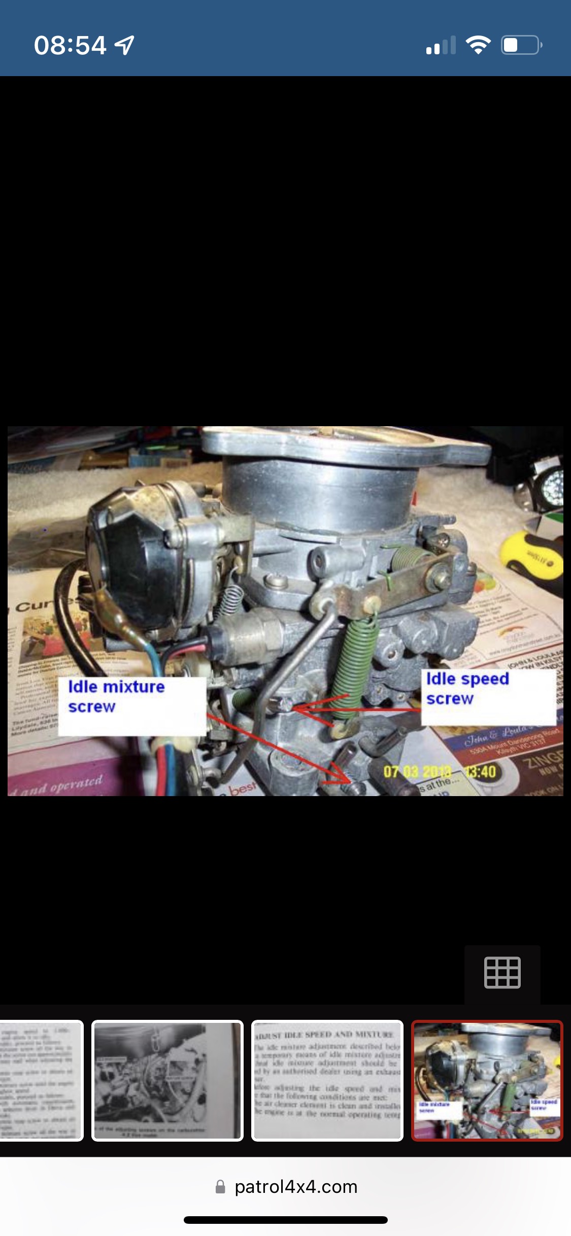

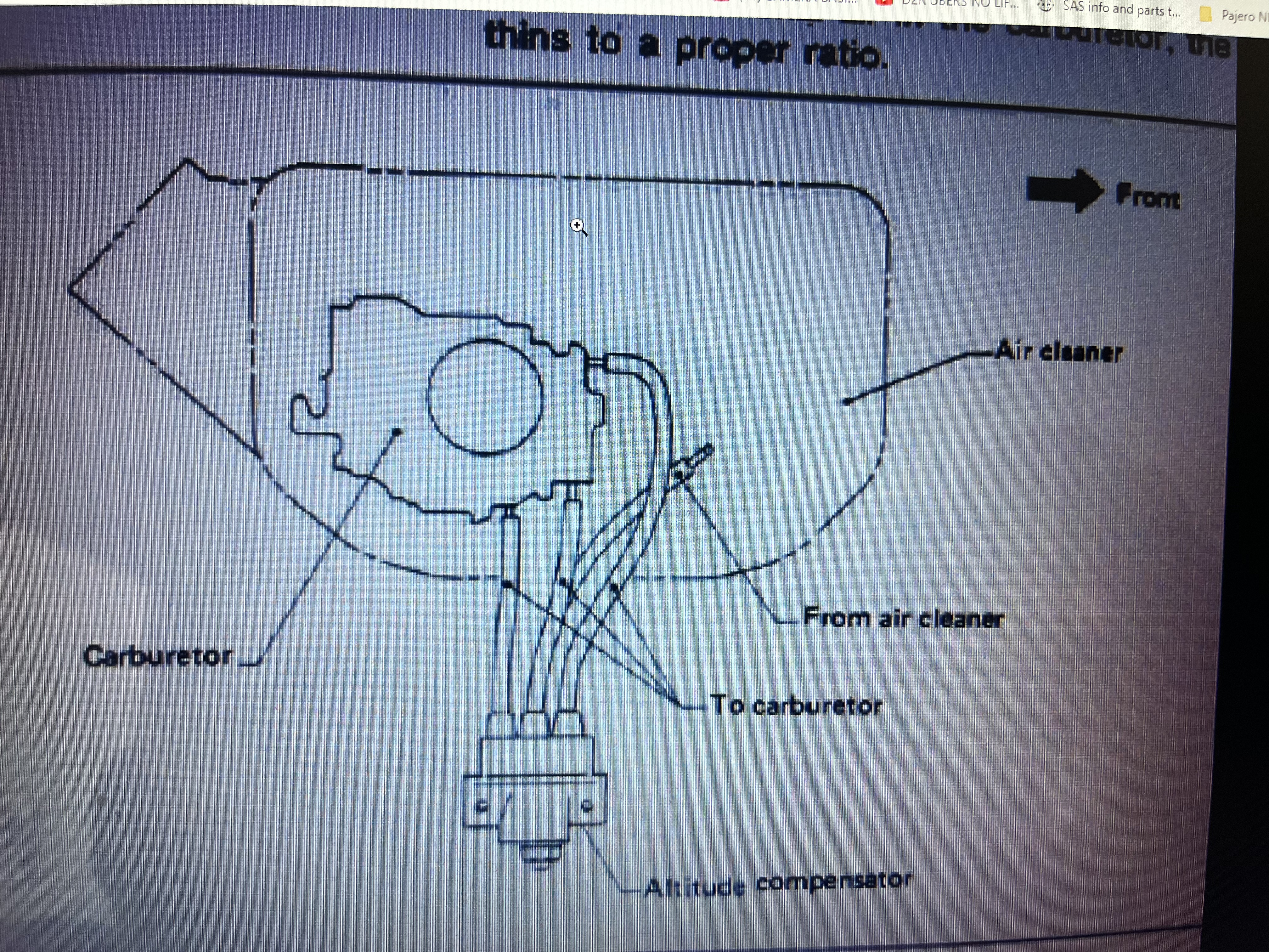

I did the carb idle mixture adjustment procedure as followed here, and no matter what, the engine wouldn't run smoothly, which led me to changing the plugs to eliminate that, and it worked.

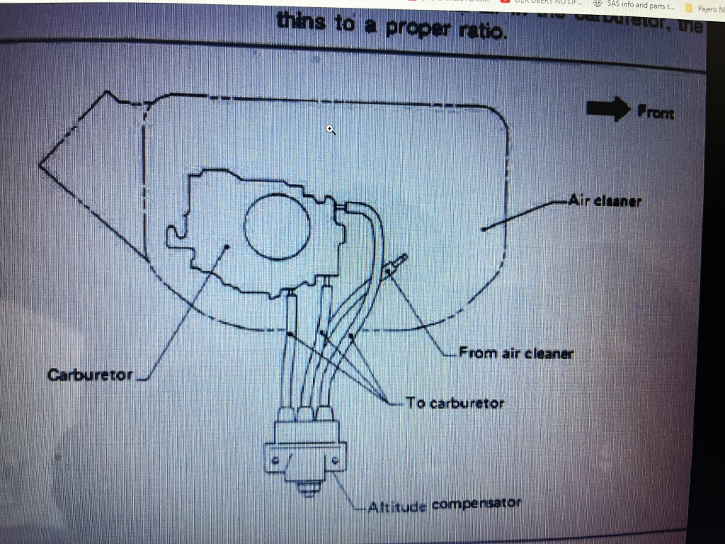

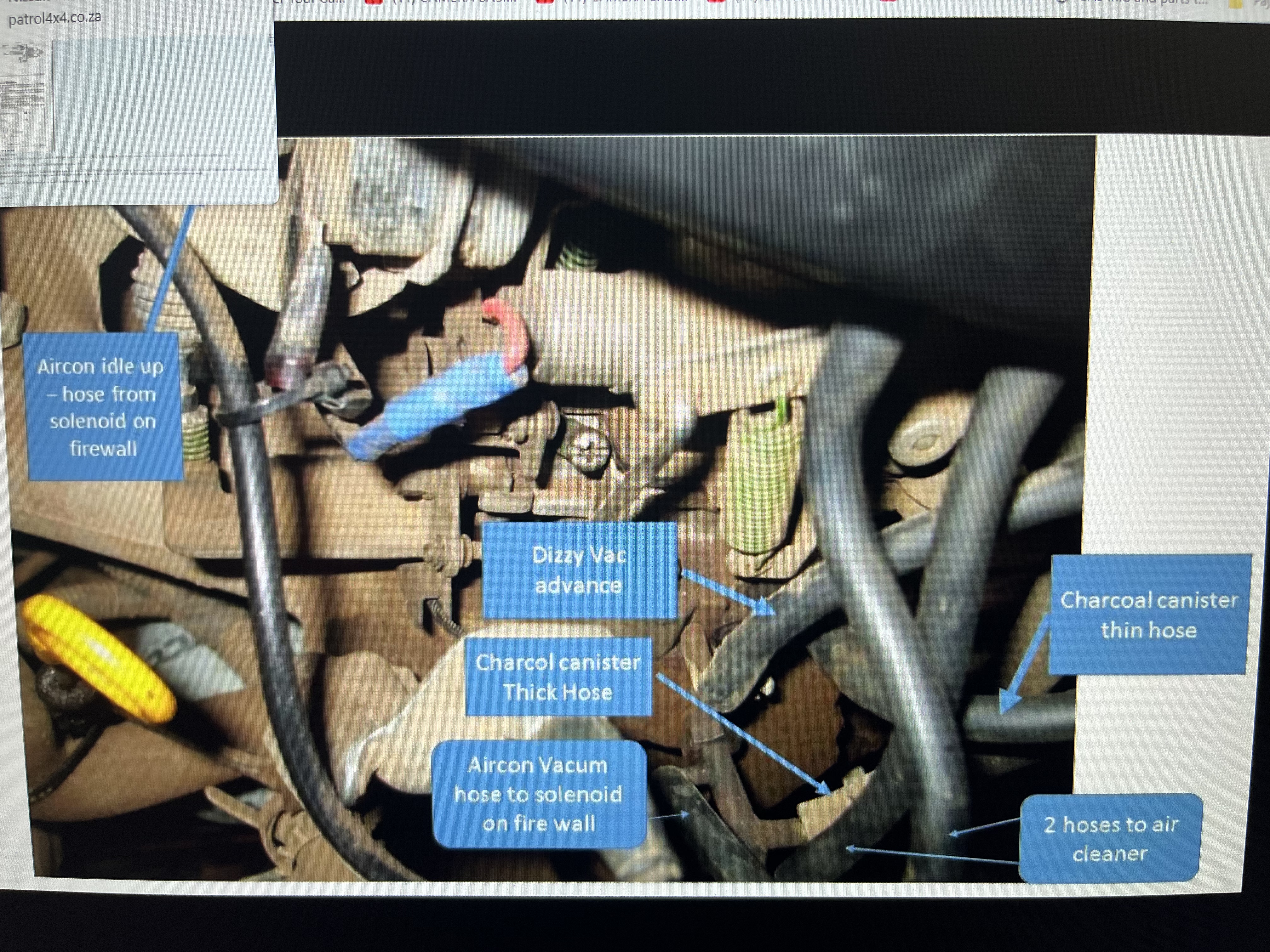

also made sure the vacuum lines all were correctly fitted in the right places as per here:
