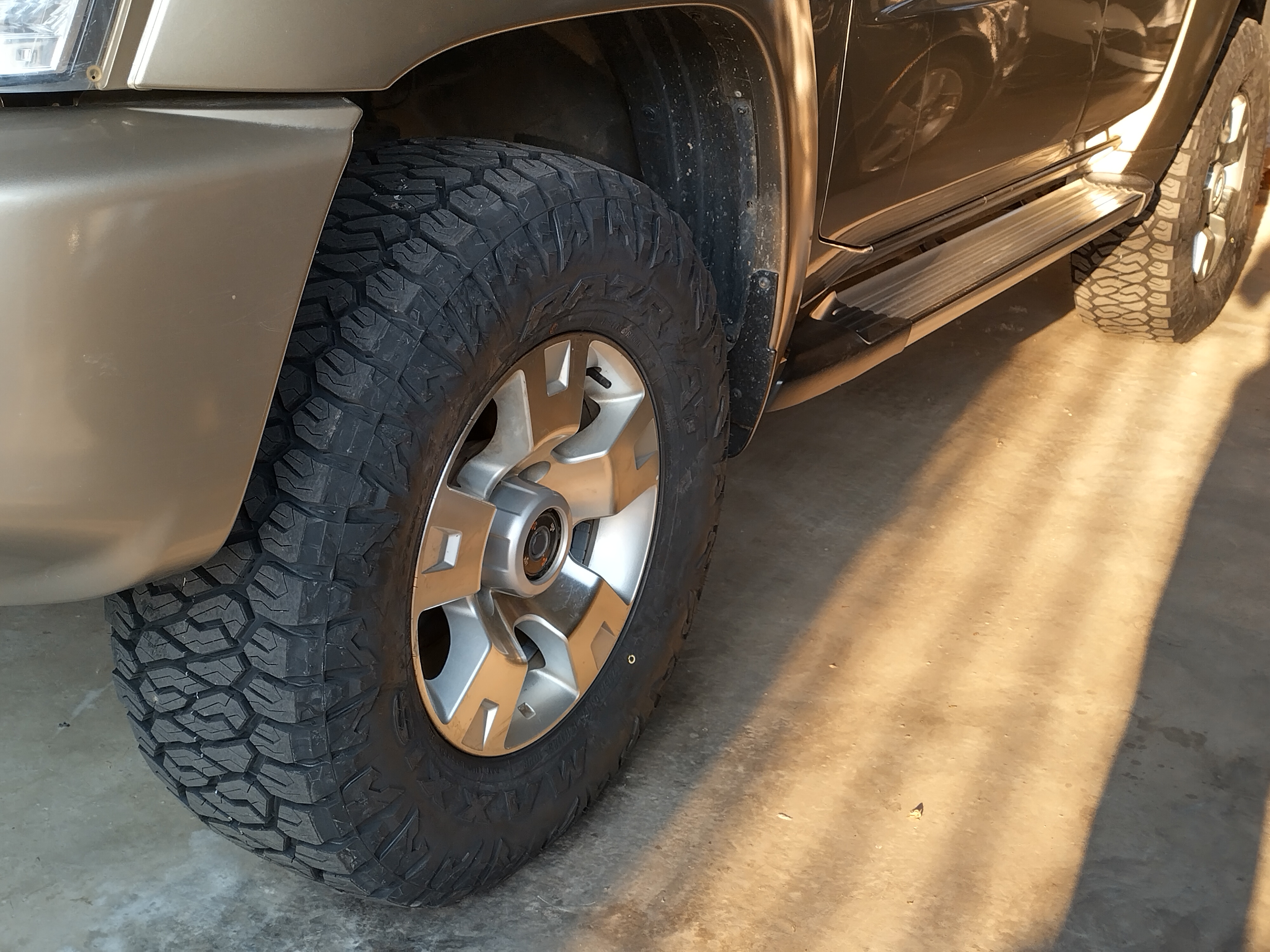

It so happens Maxxis received stock. Thanks Tinus for organizing the tyres.
Didn't notice any noise compared to GY wranglers, which was a surprise. I will have to see how it affects the consumption.
