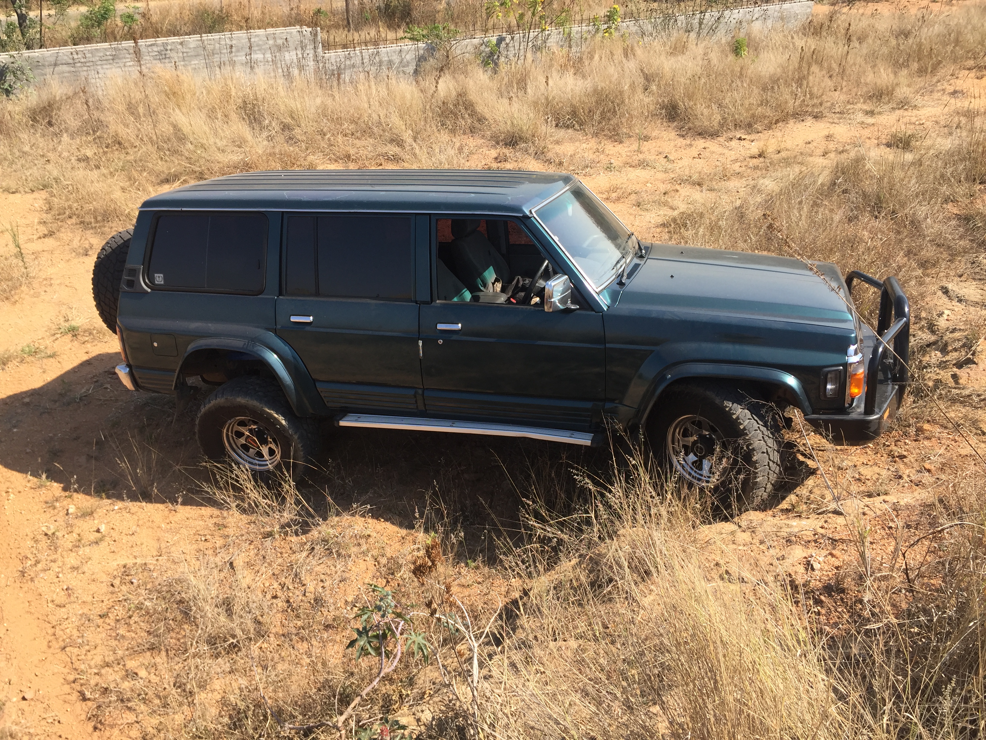

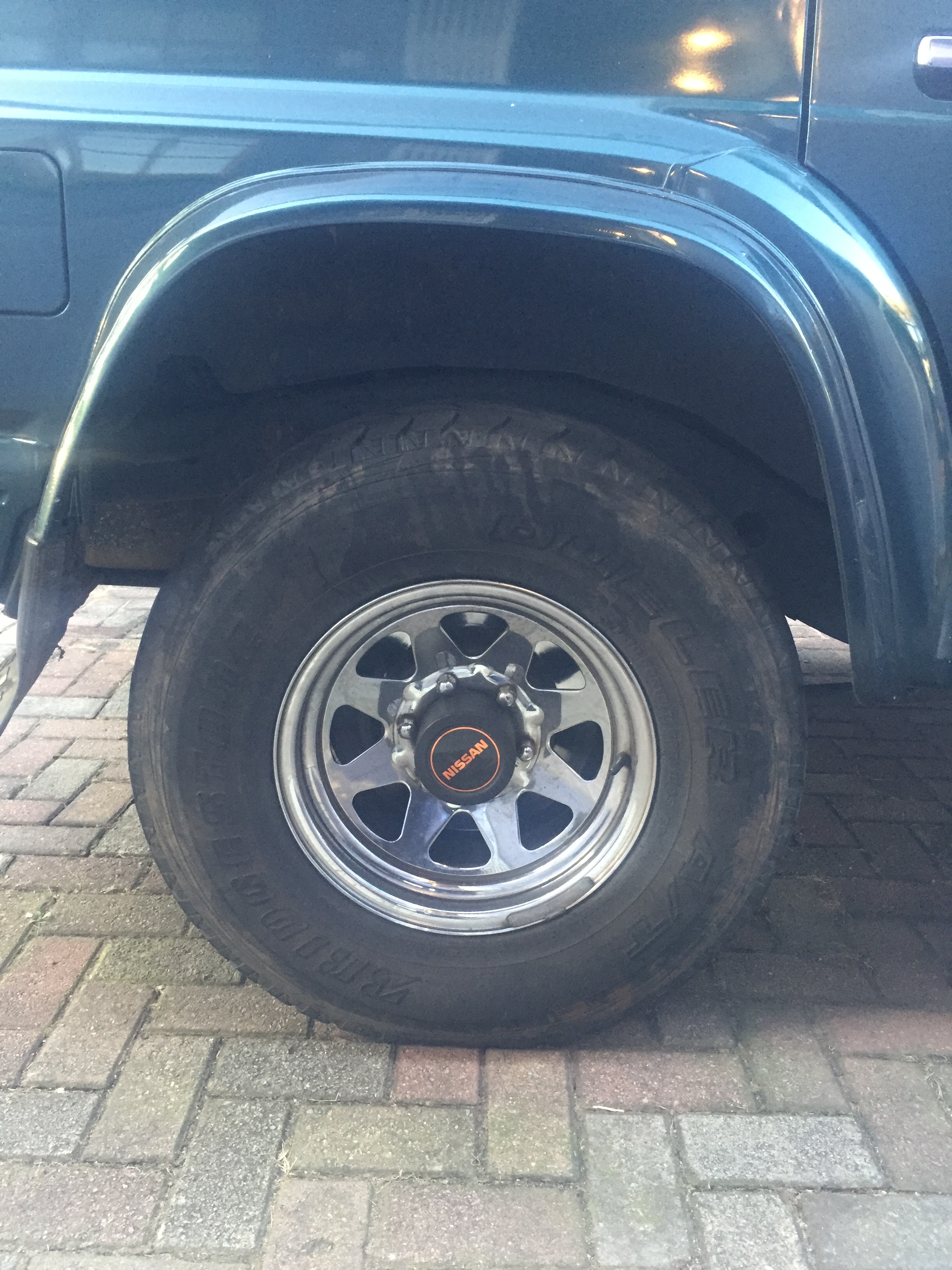

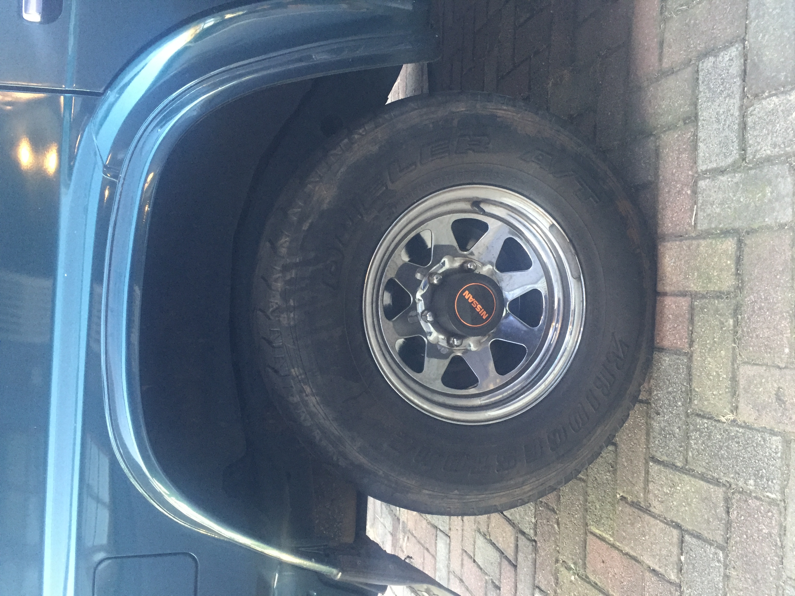

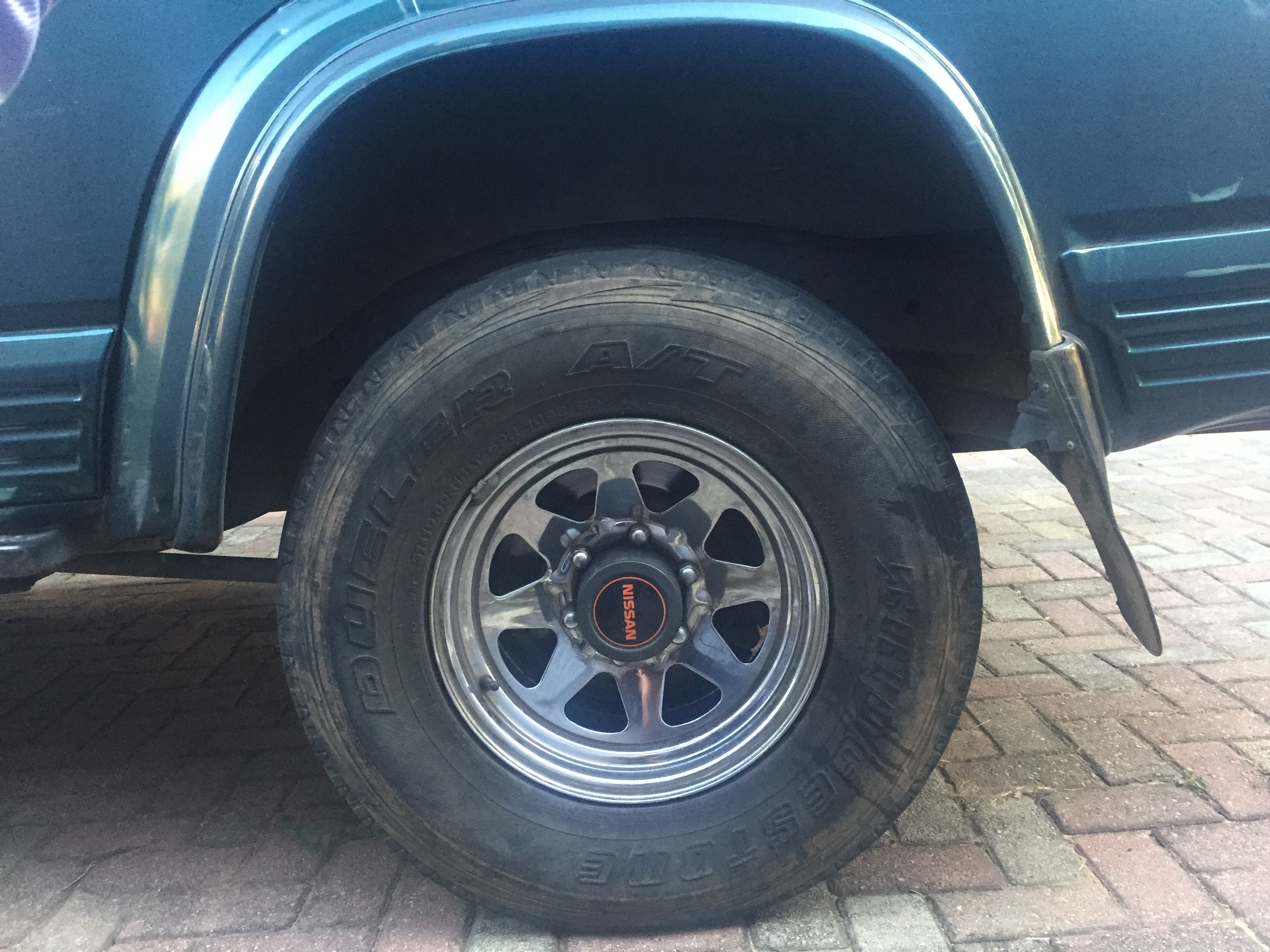

Pic of the worn 31x10.5r15 on my gq:

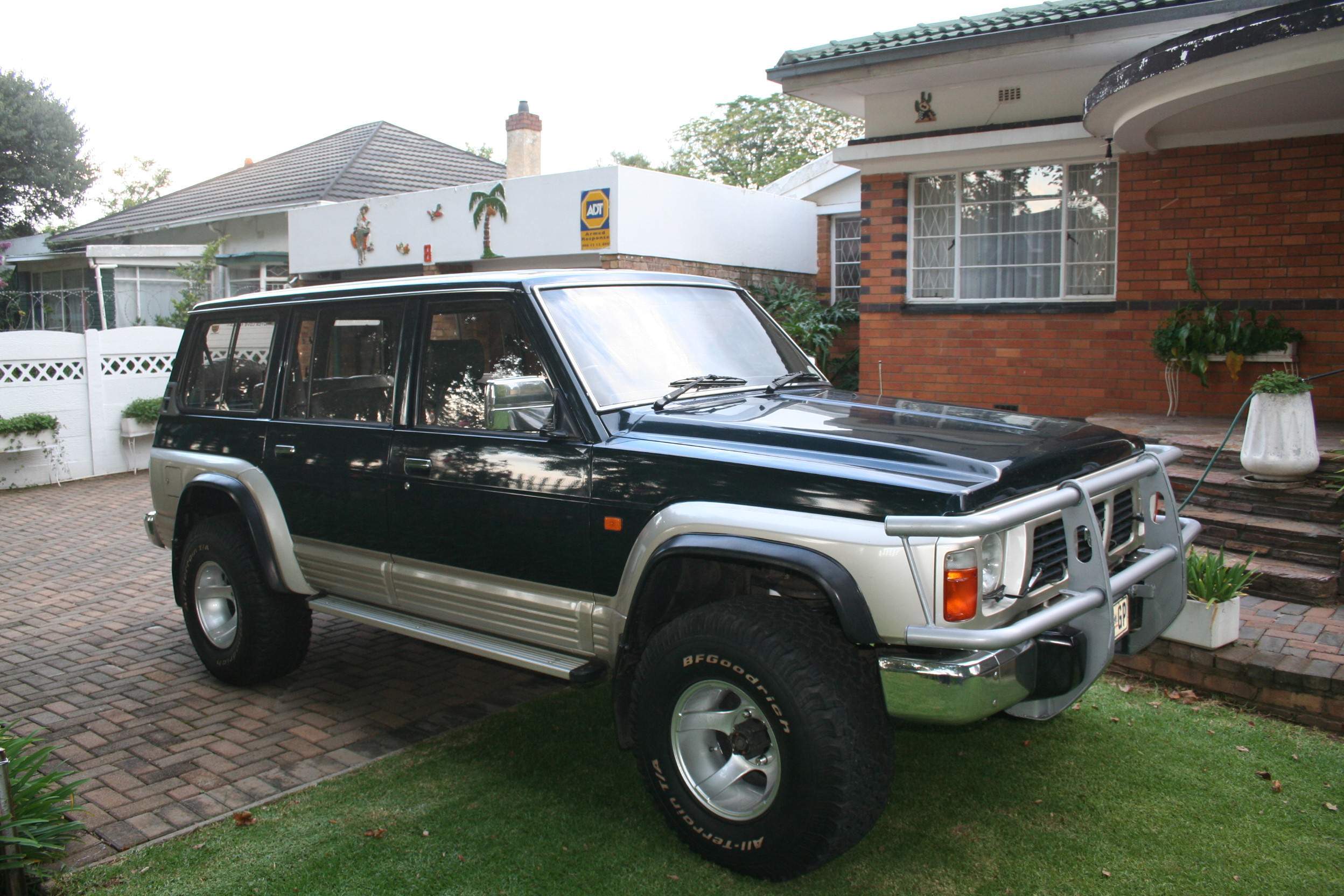

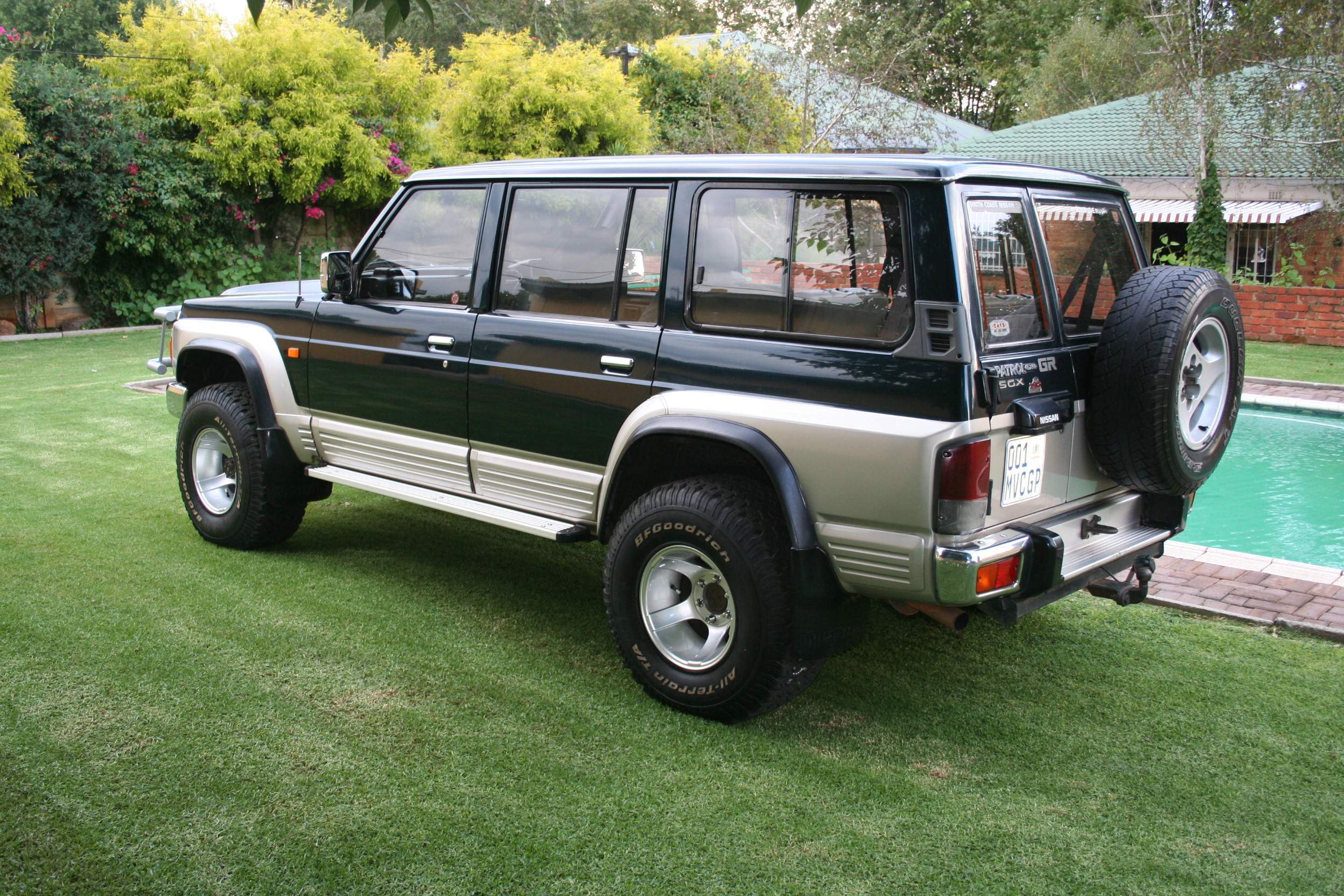

I fitted 12.5 33 R15 tyres on 10" wide rims on my 1995 GQ after lifting it 3 inches.
I was happy with the looks and tyres never caught.

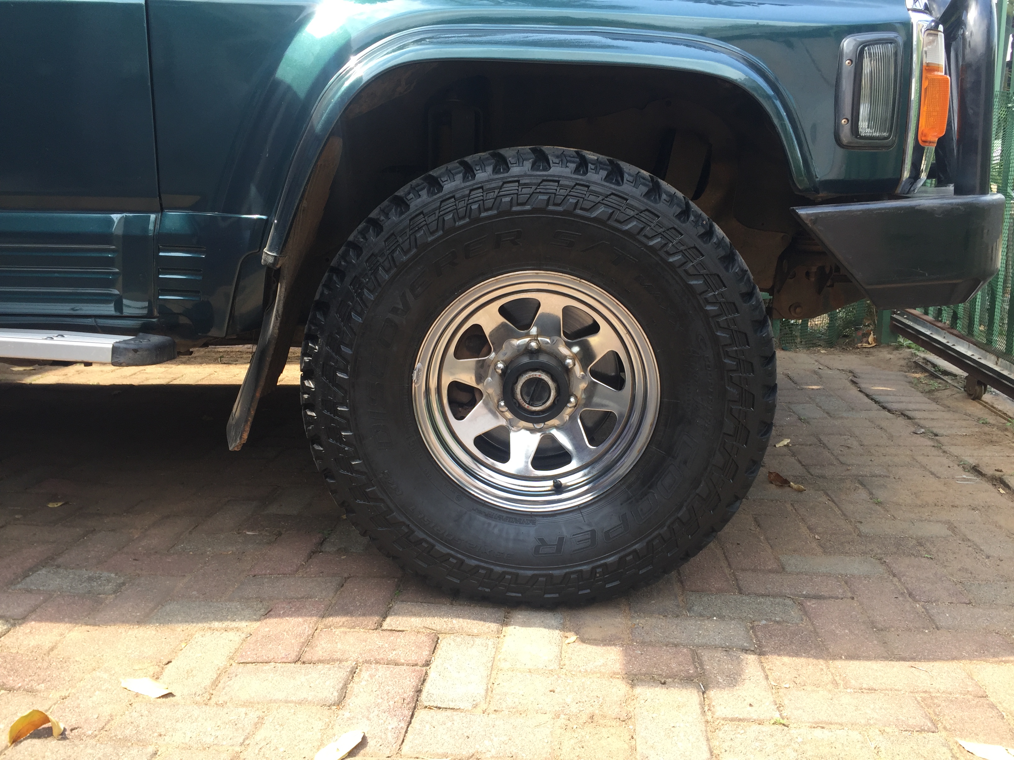

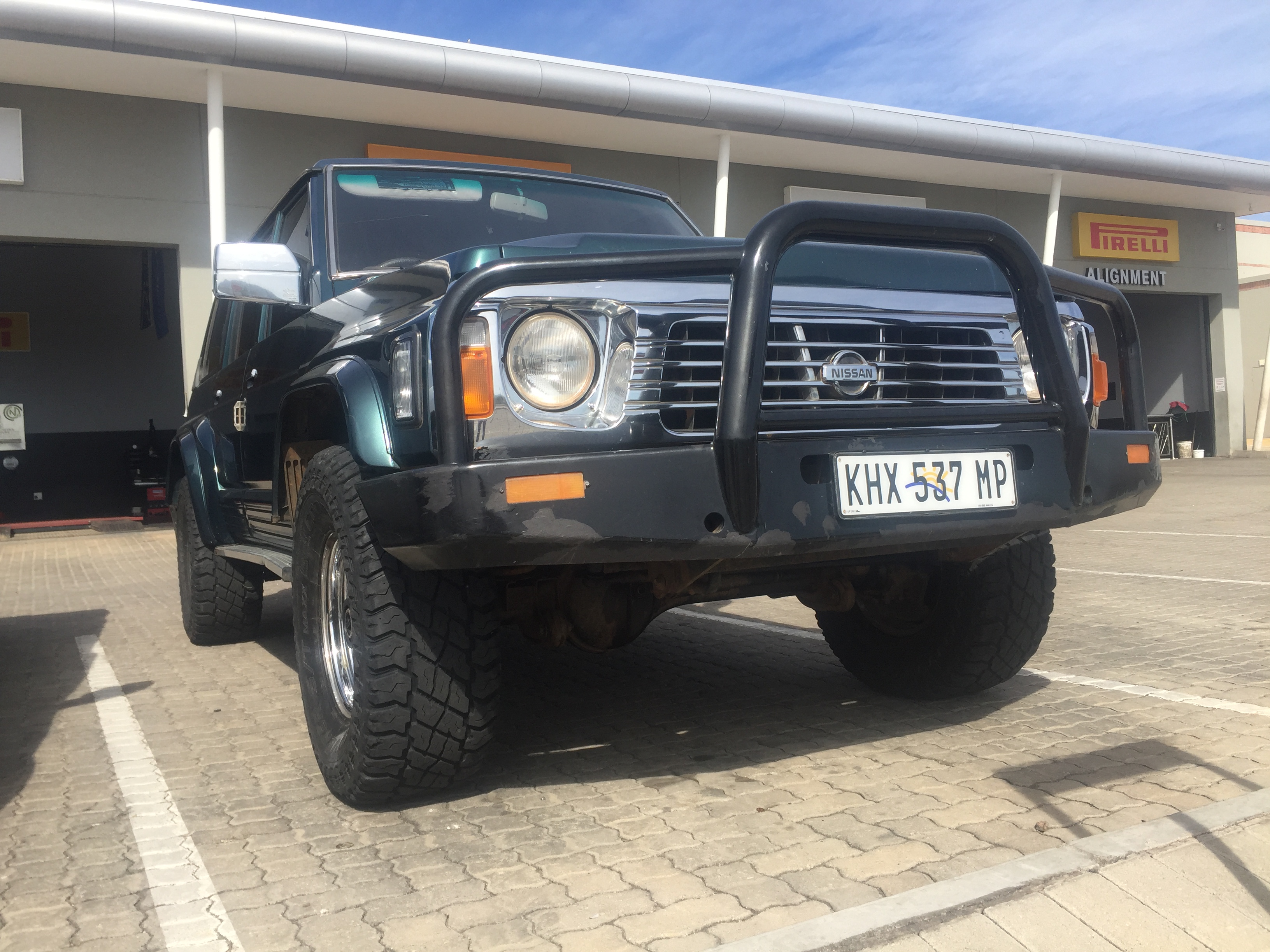

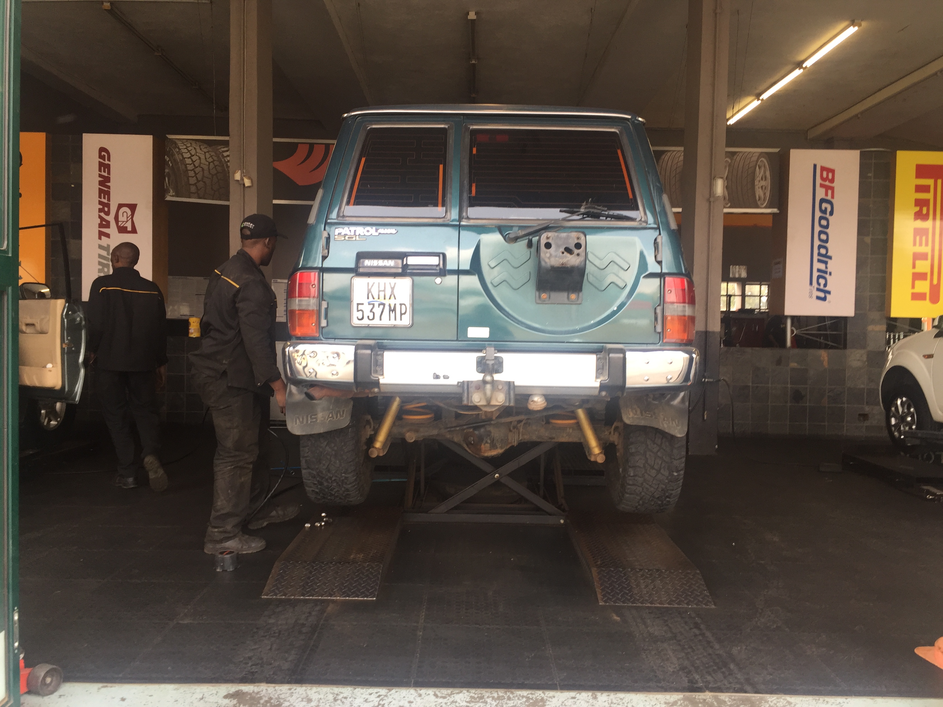

Another few pics of my GQ with the 31x10.5r15's:
(on 8" GQ chrome rims)

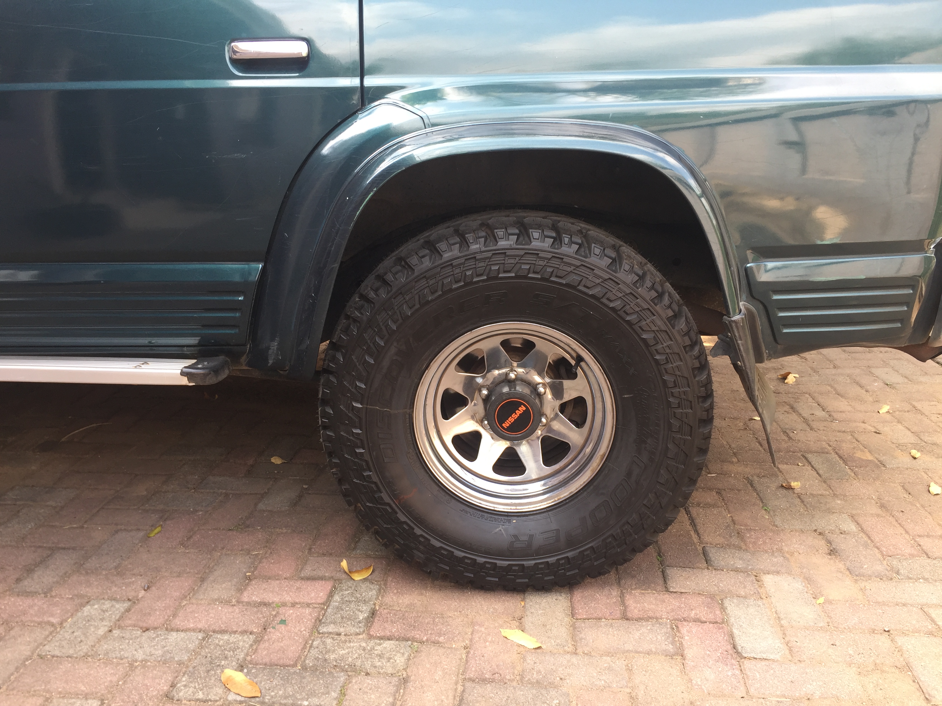

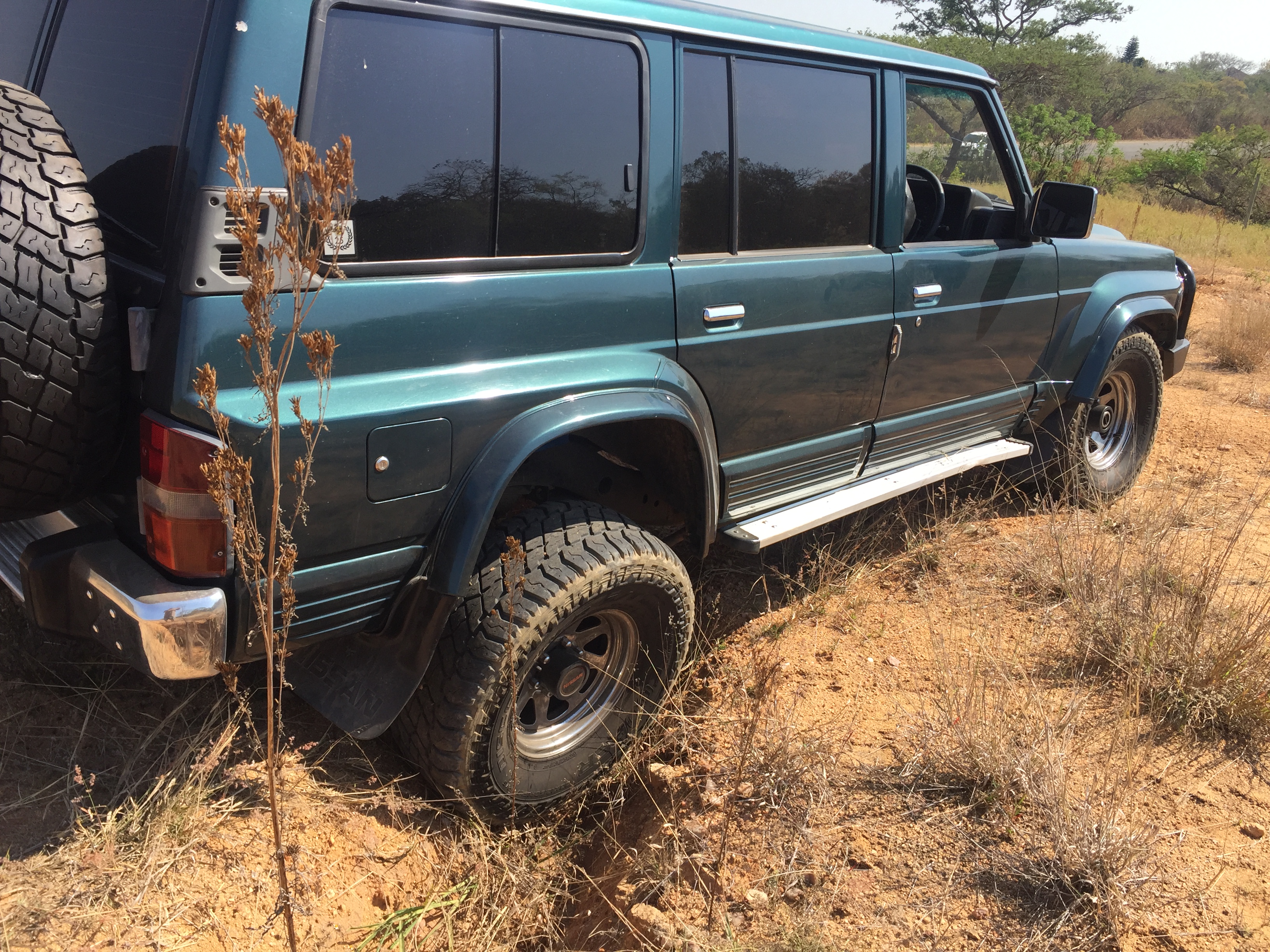

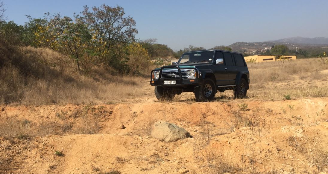

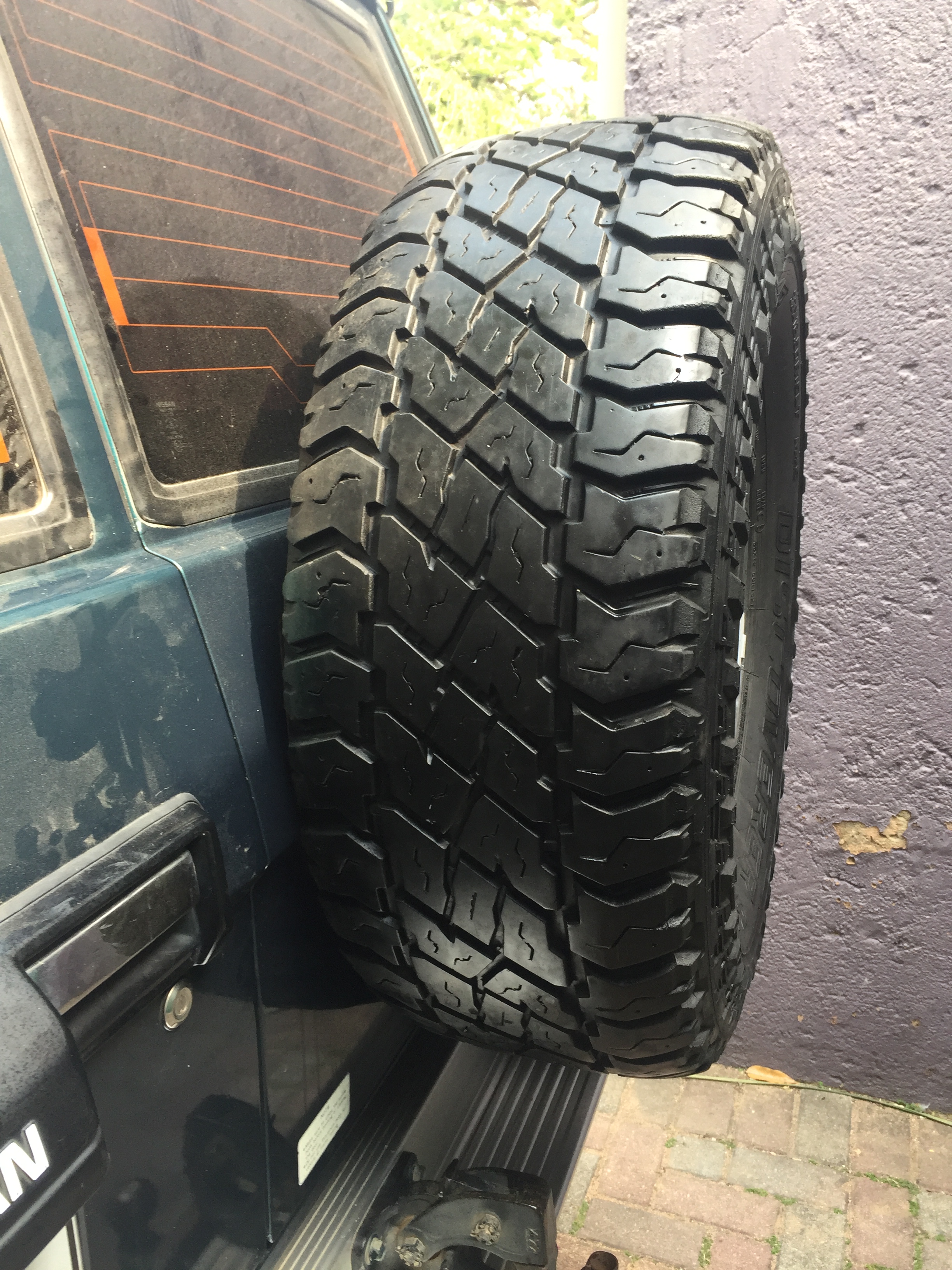

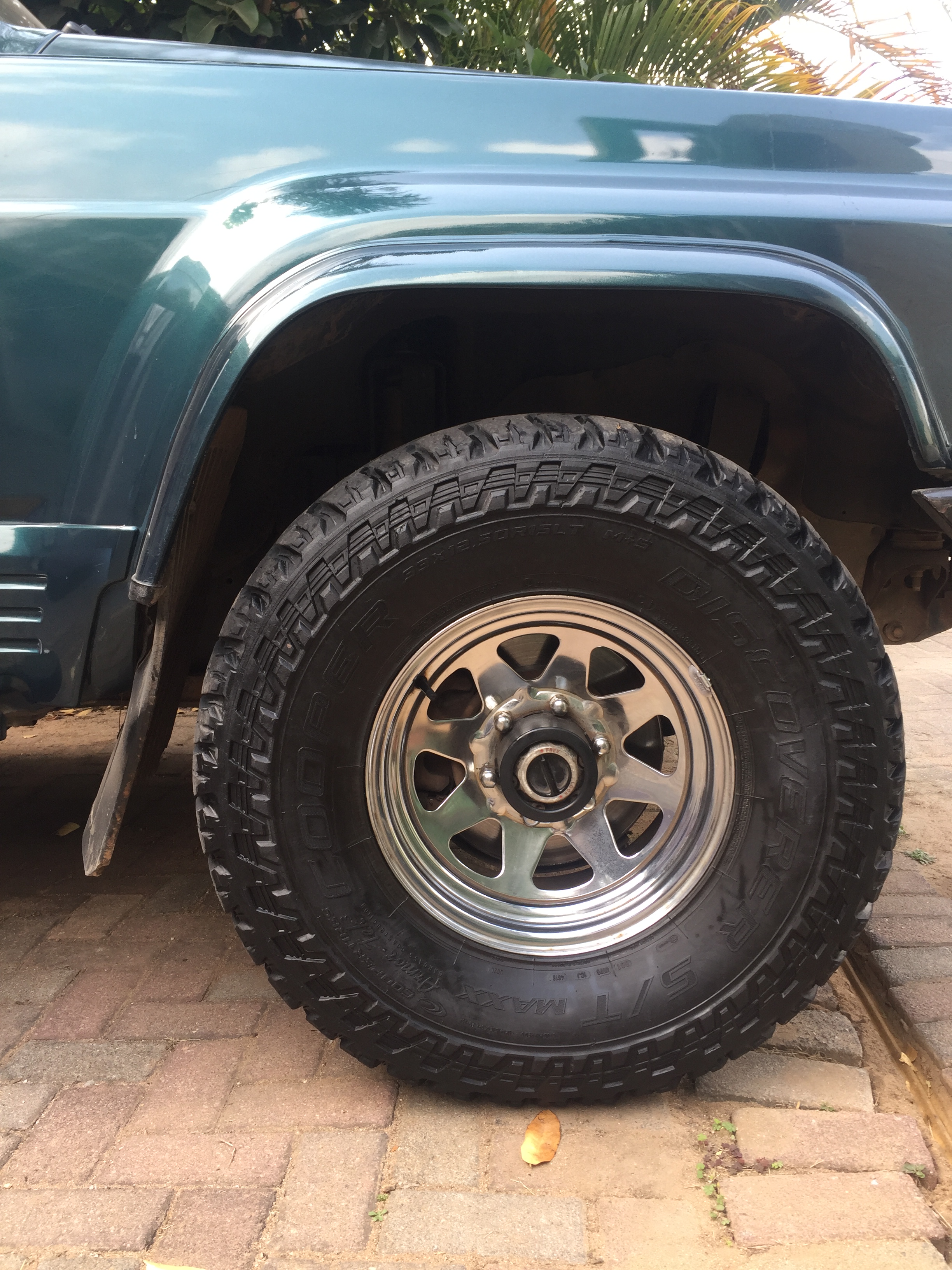

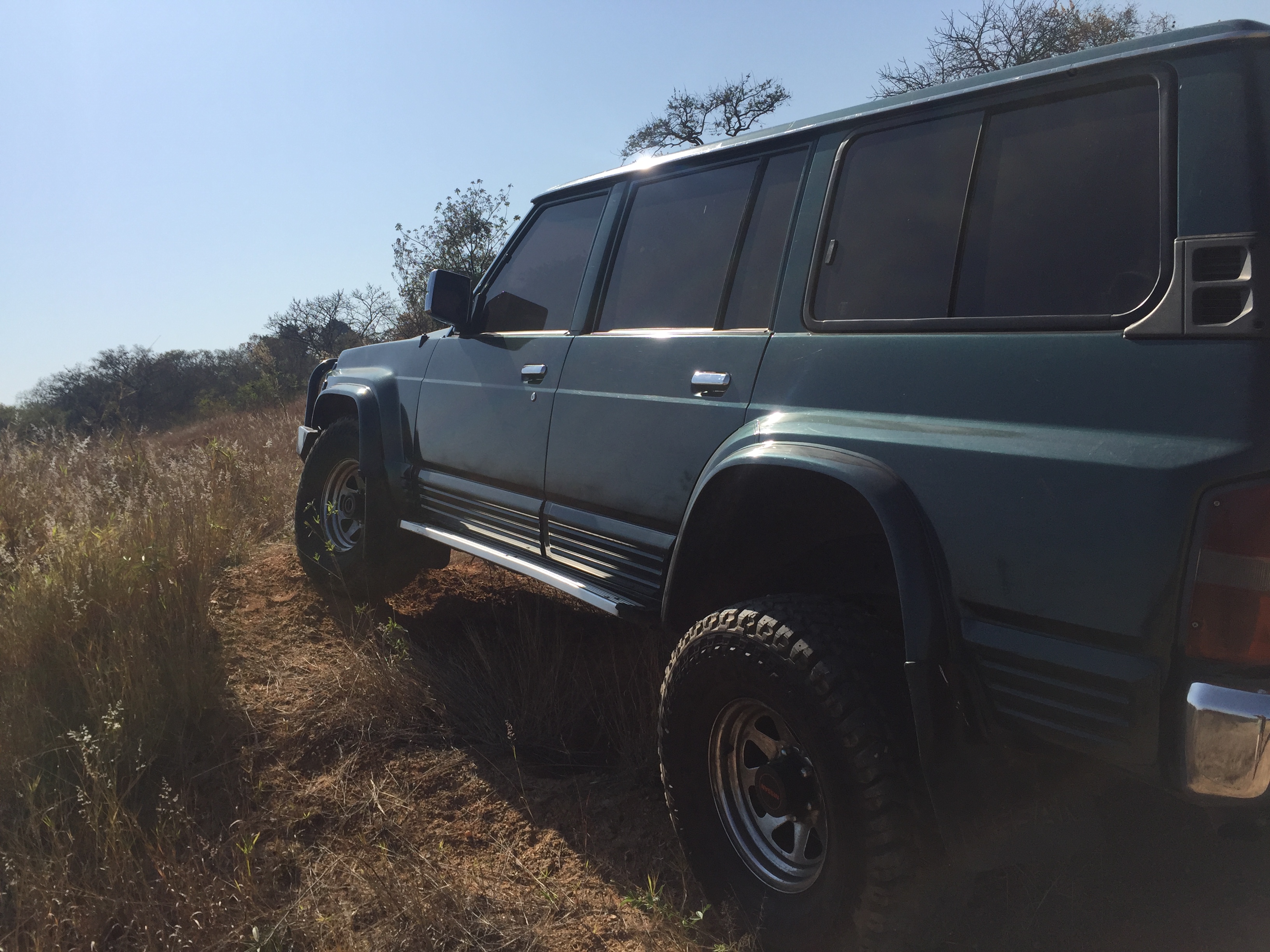

Here with 33x12.5r15 Cooper ST Maxx (on same rims):
Must say, the 33" tyres just look right on a Patrol :salute:
I read about 33" rubbing on full turn on mudflaps or even on extended wheel flares, but mine is not rubbing at all.
Must still test it while flexing...

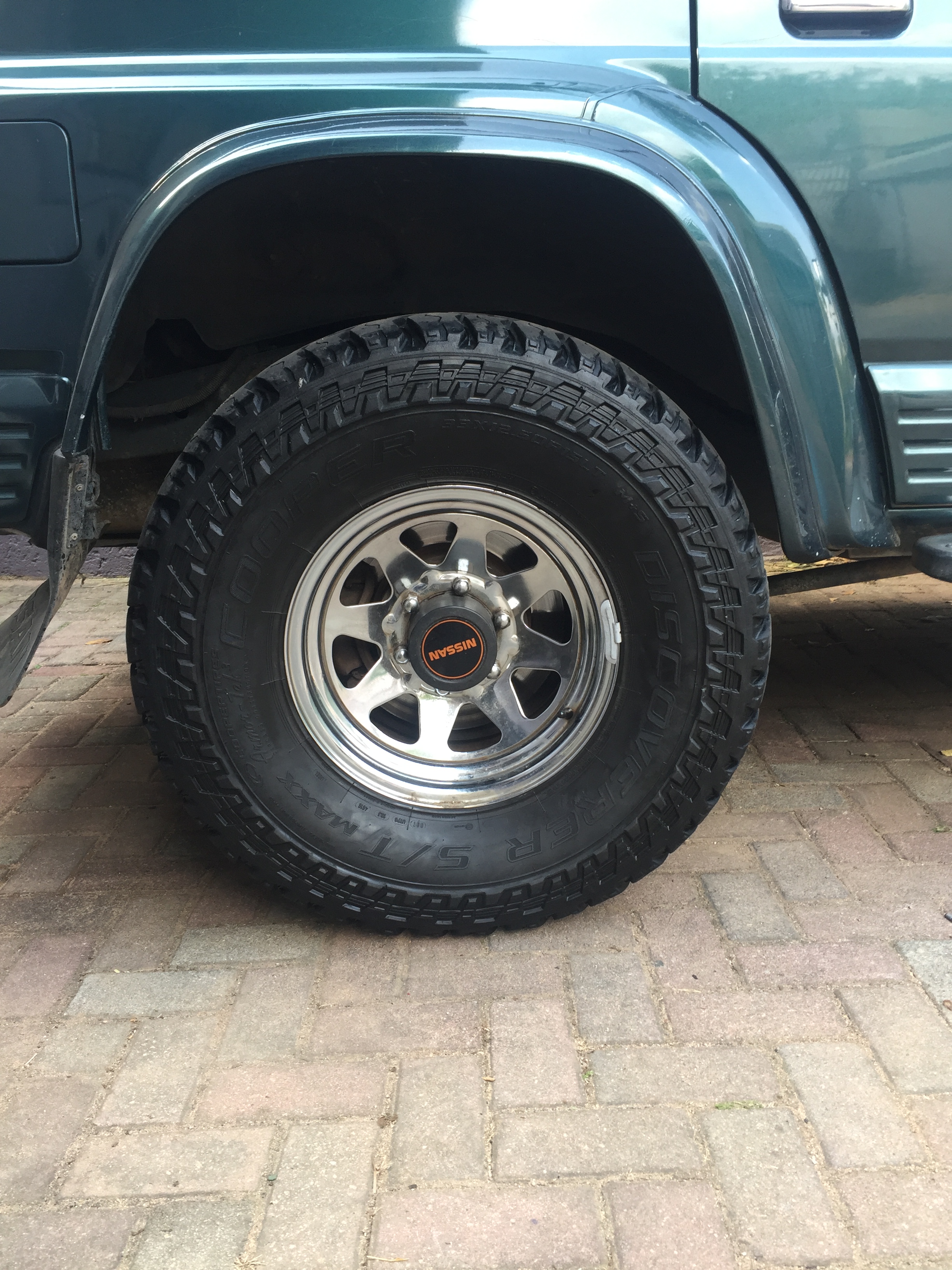

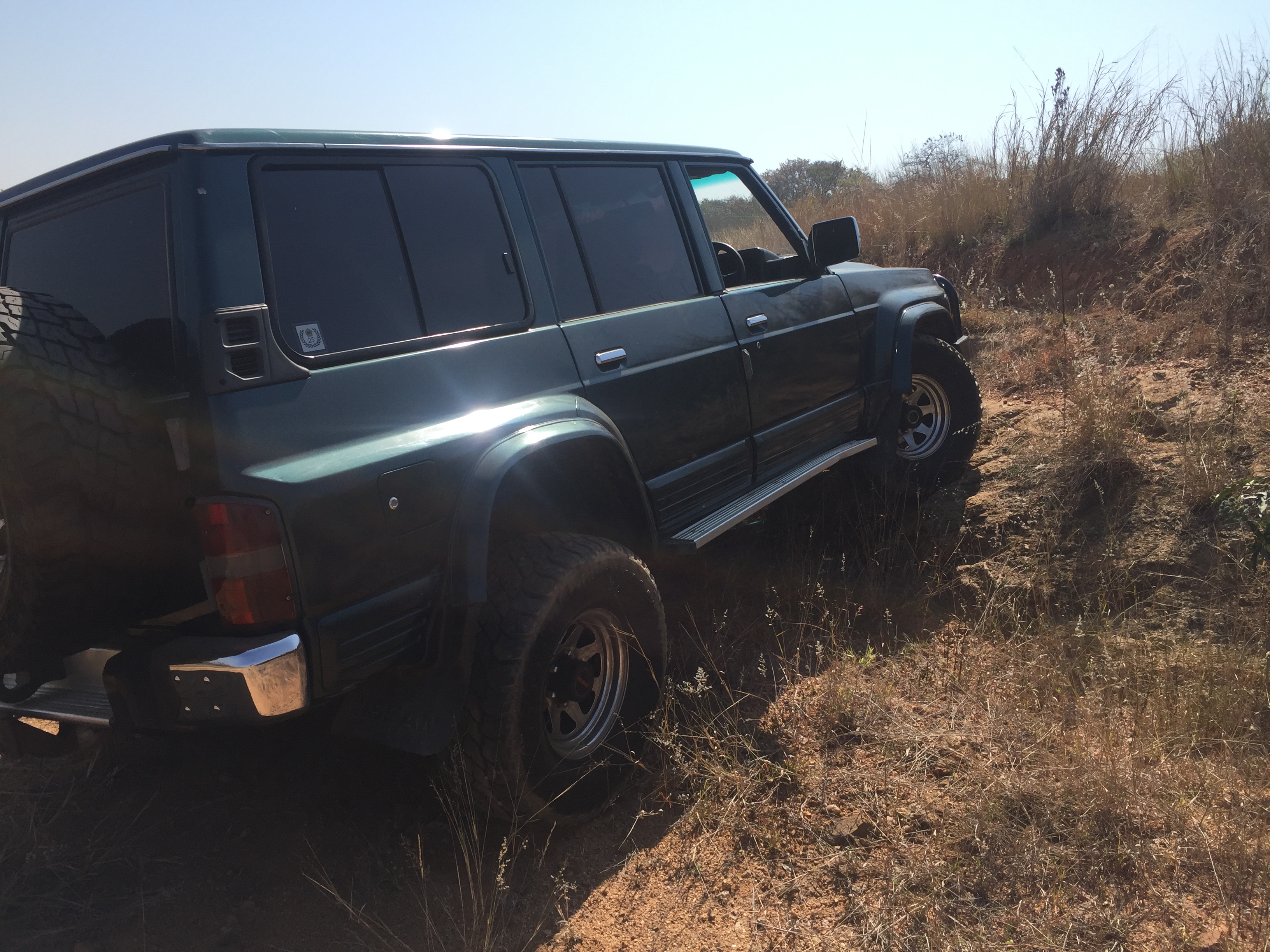

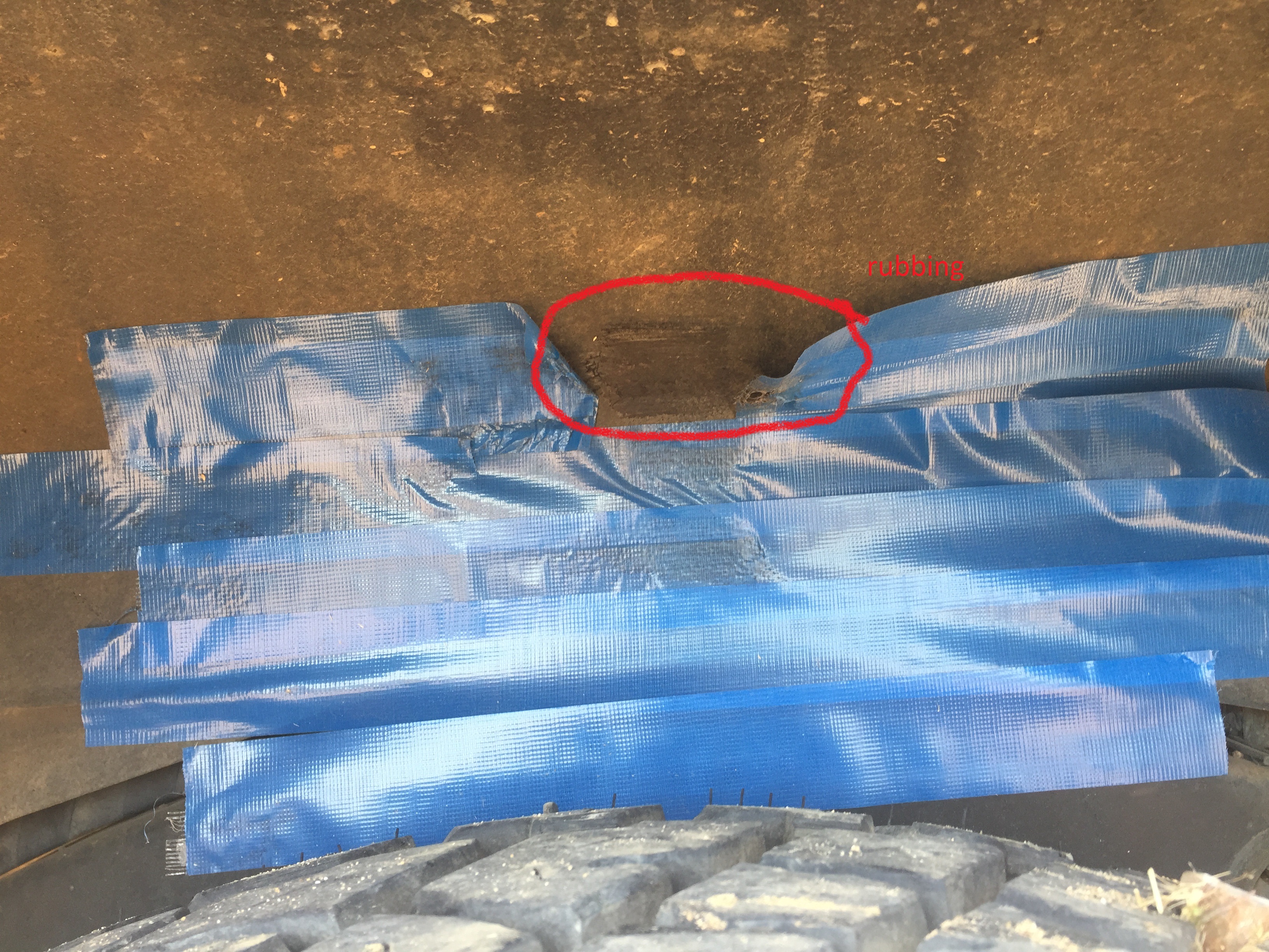

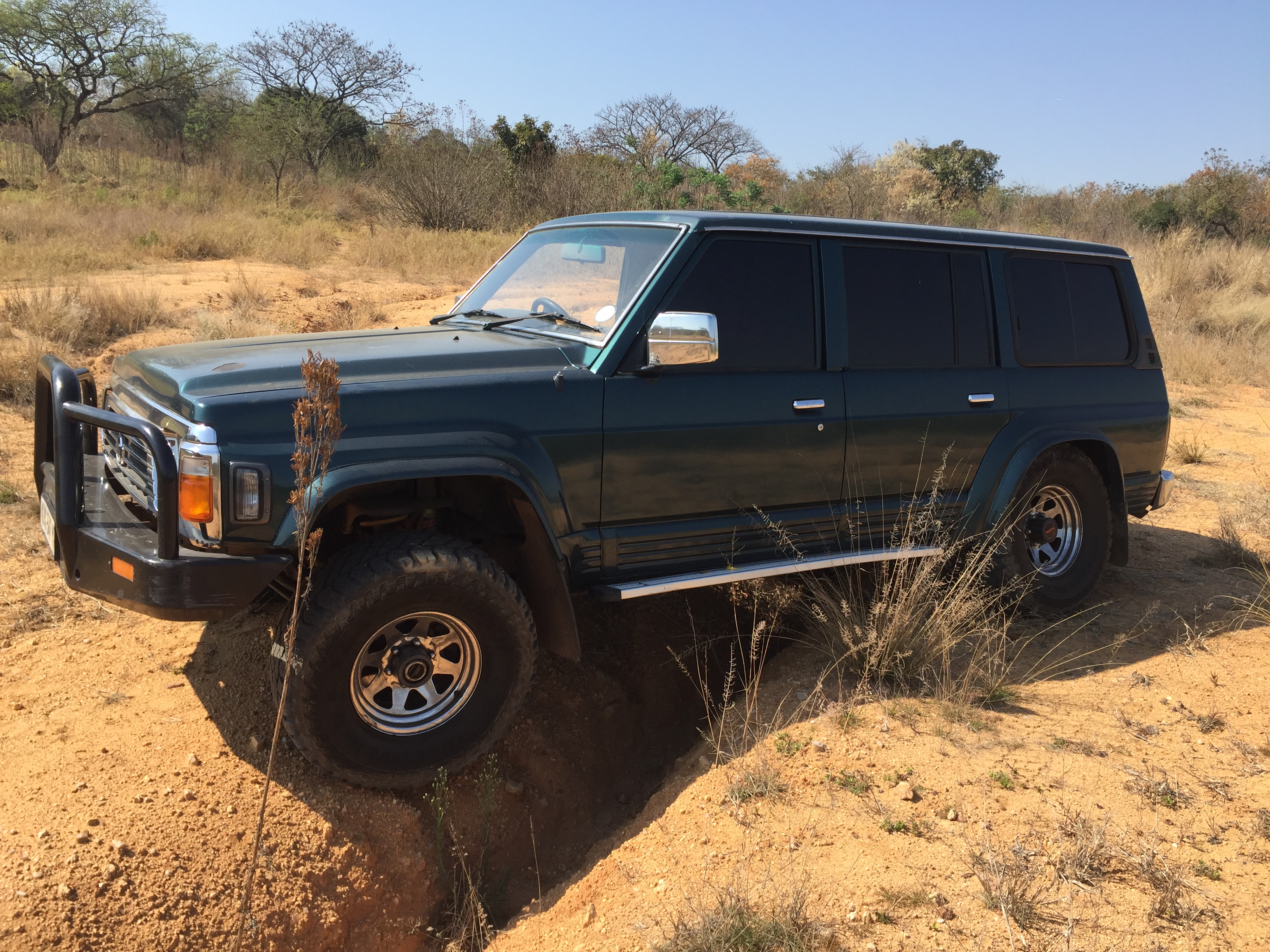

Went to test the tyres to see if they rub on full flex... (at a "playground" close to my house).
I got the new tyre on the rear left, which is the only tyre rubbing slightly at full flex. 6mm spacer will fix this :wink:
Must say huge improvement from the worn 31" duelers to the 33" st maxx's.. one crossaxle i drove previously, I had to use locker, this time no locker required.. :blonde:

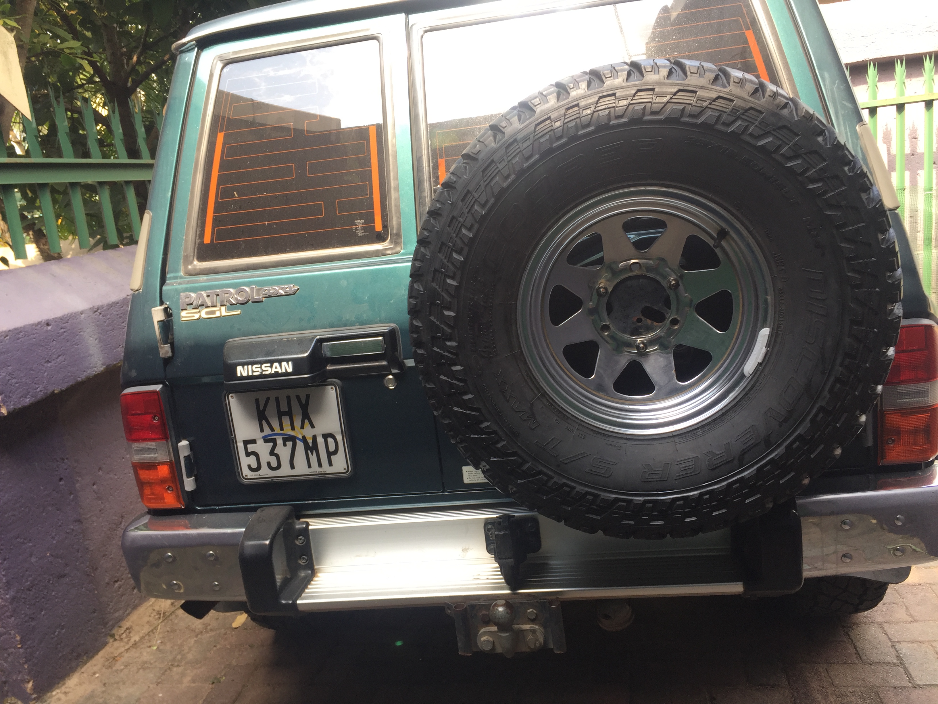

Did you have to use a spacer on your OEM Rear Door Spare Wheel Mount?
What off-set are those 8J GQ wheels?
