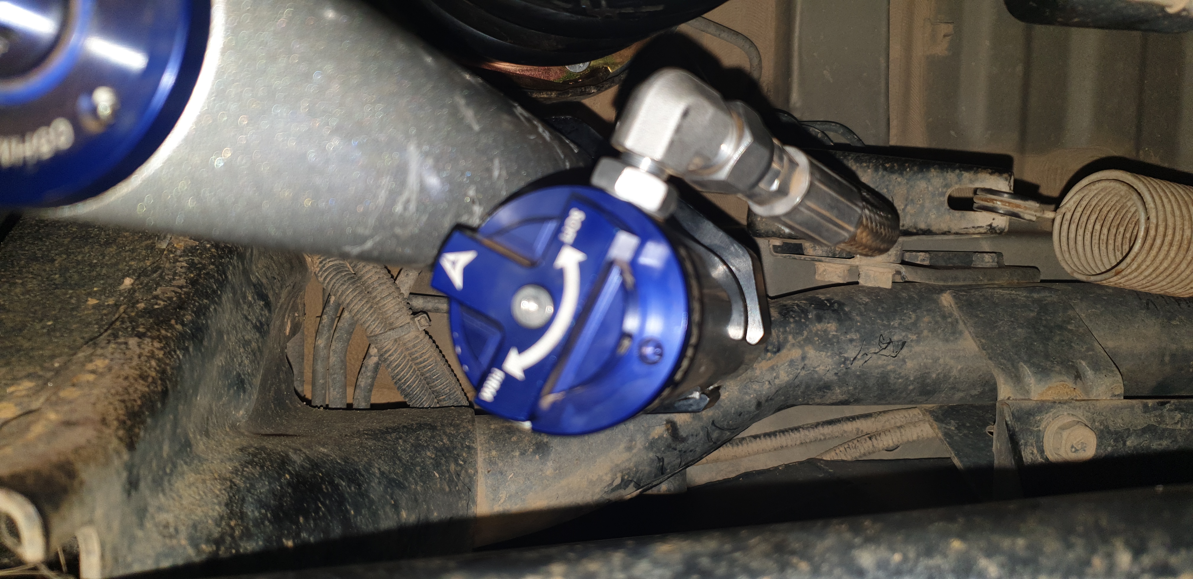

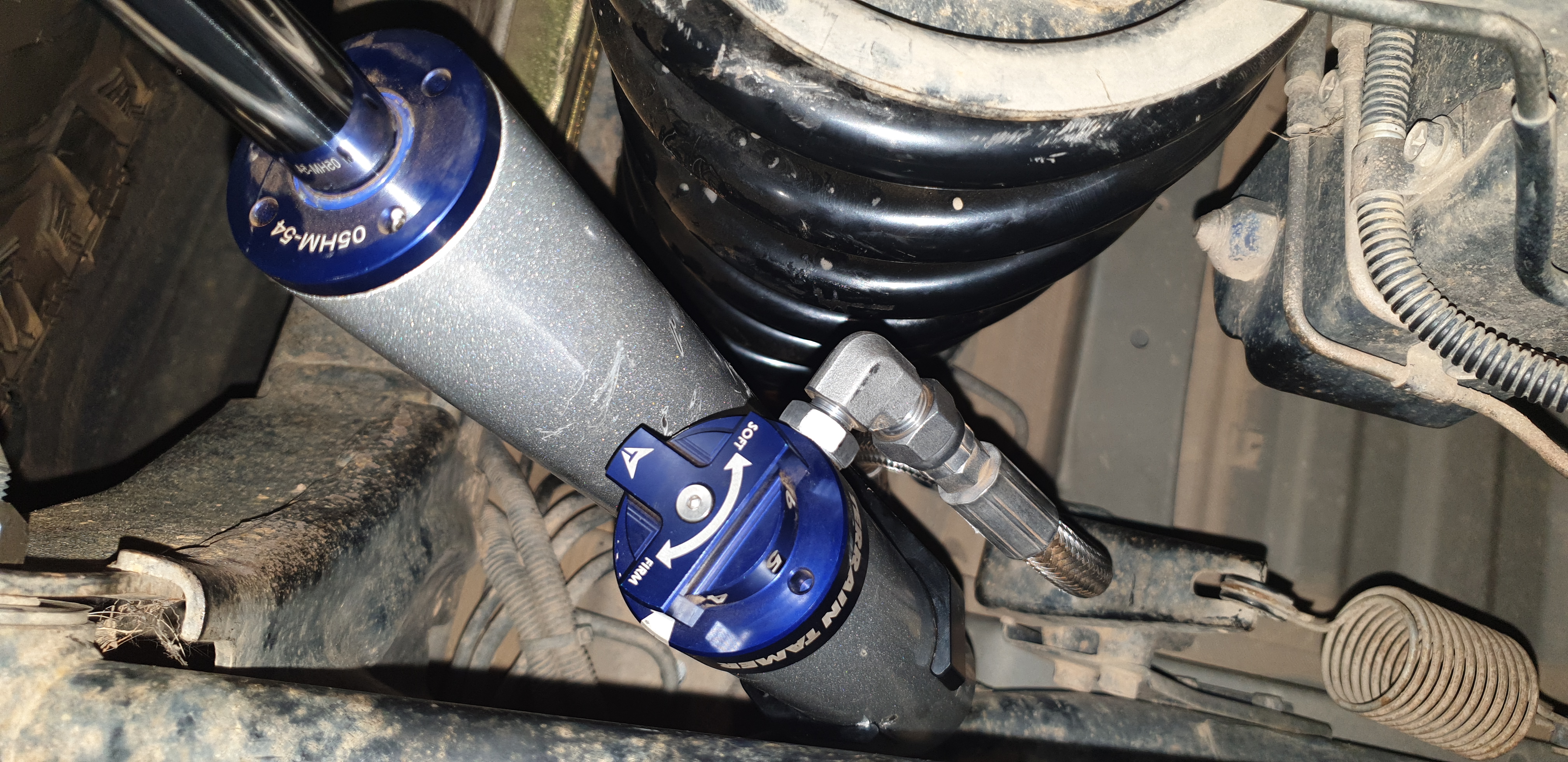

An aspect of the Pro Shocks that I really like is that it is easy to adjust the shock. Unlike the ARB BP-51 setup I don't need a special tool to make the adjustment to the Pro Shocks and the knob to make the adjustment is easily accessible, whereas the BP51 adjustment dials are located inside the coil on the front shocks and that will be challenging to change with a loaded vehicle compressing the rings of the coil close together. With the minimal space that I have in the rear due to the Brown Davis main tank that I have fitted I dont see how I would have been able to adjust the rear shock of a BP51 using the special tool.

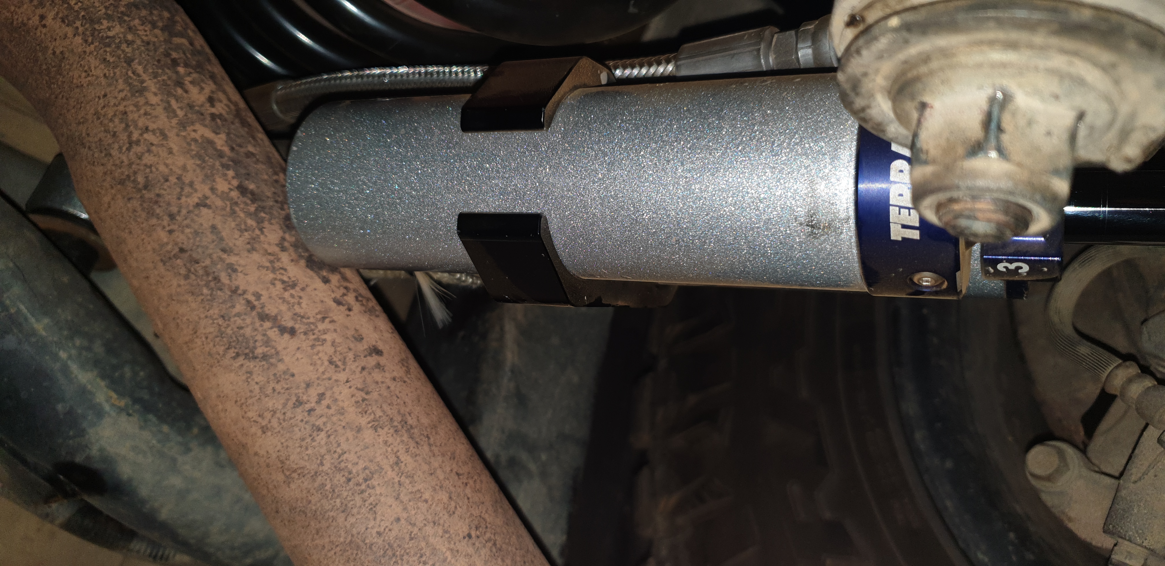

  • The rear stone guards fitted to the Pro Shocks had to be removed. The Pro Shocks are actually designed for the Toyota Land Cruiser, but also fit the Patrol, with the exception that the rear stone guards need to be removed as there is not enough space for them to remain fitted without getting in the way of the vertical movement of the shock. Marinus from Terrain Tamer provided me with Steering Racks Boots that were easily cut and fitted to protect the stanchion, so remember to include this if you order the Pro Shocks.

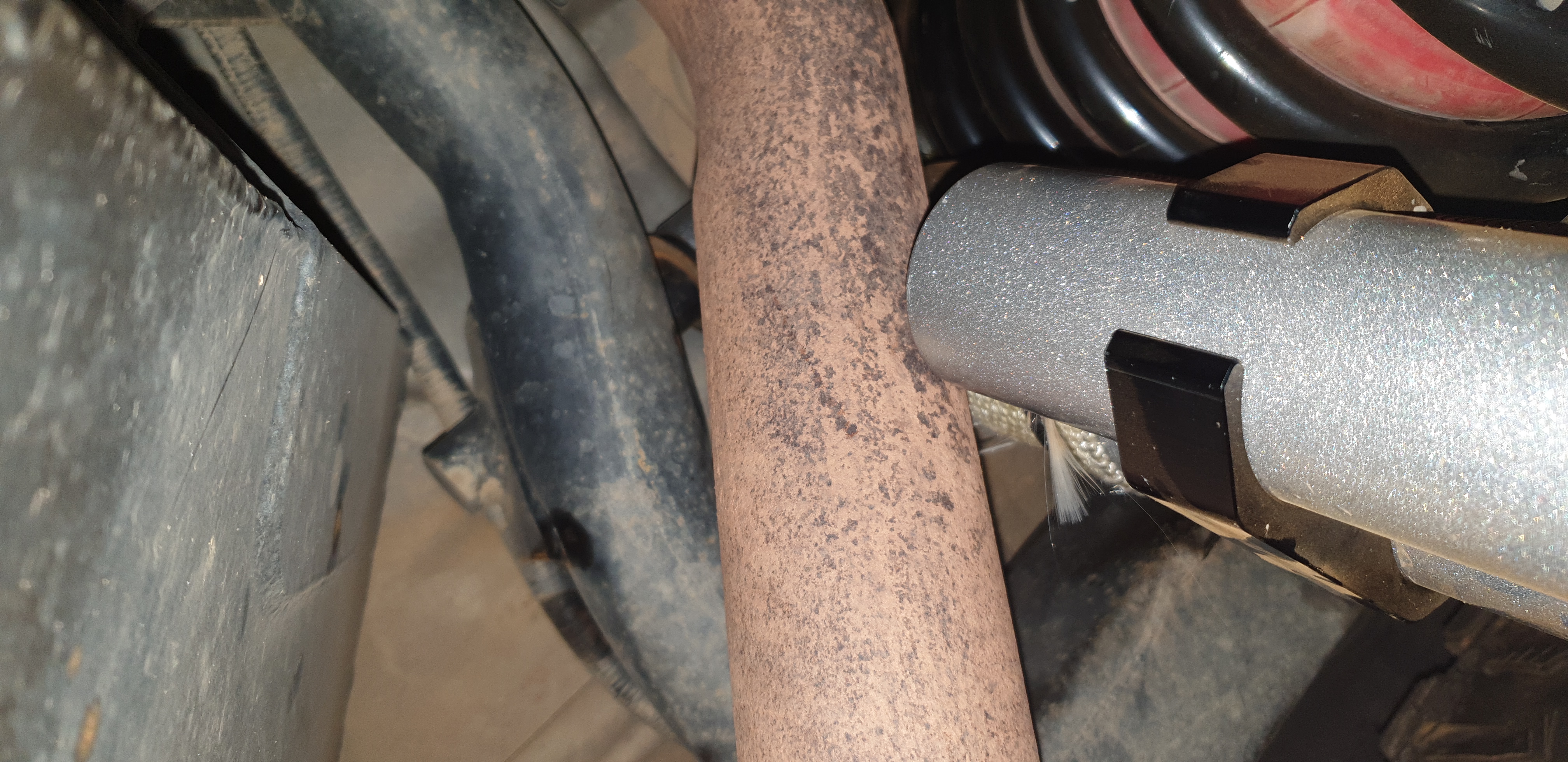

  • I have a 63mm freeflow exhaust from Powerflow and the exhaust pipe was very close to the passenger side rear shock and was causing it to heat-up due to the radiant heat from the pipe. It was easily resolved by taking it to Powerflow who fitted a new section to the rear and rerouted it so that it was further away from the shock.
  • I have a Brown Davis long range tank fitted and it makes maximum use of the available space, which meant that the space for the fitment of the shocks was tighter than it would be if you had a OEM main fuel tank. The minimal space meant that we had to be very diligent in making sure that the braded hoses that connect the shock to the external reservoir would not get pinched by the coil. The hoses are connected to the sock and reservoir y means of threaded elbow joints and Marinus from TT confirmed that they could be loosed slightly and then rotated, which allowed us to route the hoses in such a way that they would not be pinched by the coils. What was interesting is that with the initial setup it looked like the hoses were safe until I parked the Troll on my driveway, which has a slight incline, and got under the car and noticed that the vehicle "floats" slightly backwards on the coils and this then meant that the braded hoses were coming into contact with the coils.

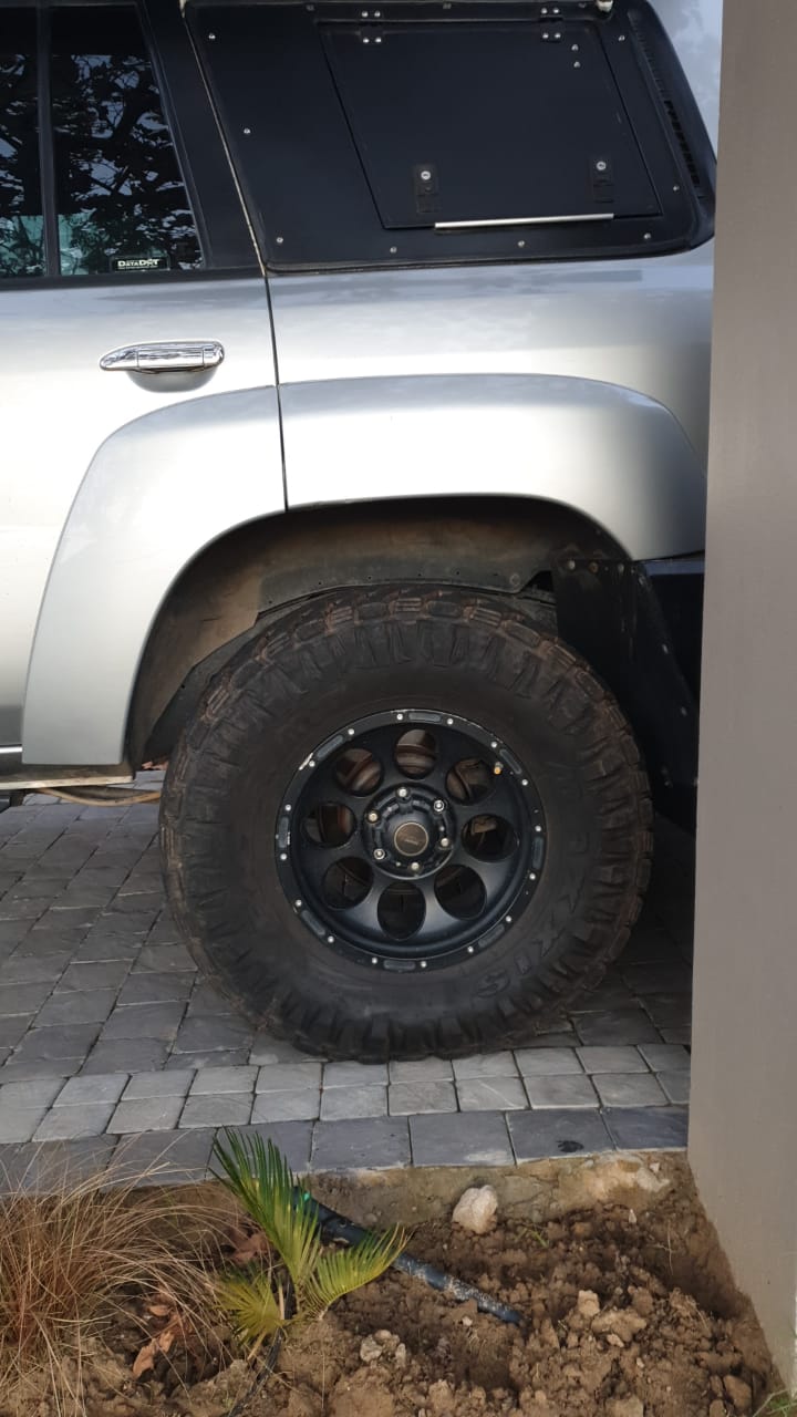

Below are the stats of my suspension lift. I have included the loaded and unloaded heights of the TT Pro Shocks, the stock Patrol height, and then the height on my previous EFS setup. Keep in mind that the Fully Loaded setup means that my vehicle weighs in at just below 4T and here you can see that I've got a 40mm lift in the front and a 25mm lift in the back and this is without having to inflate the airbags to keep the vehicle level. To add to this I have 35" Maxxis Razors fitted and I still have enough wheel travel, even though I dont have a crazy lift like I originally thought I needed.

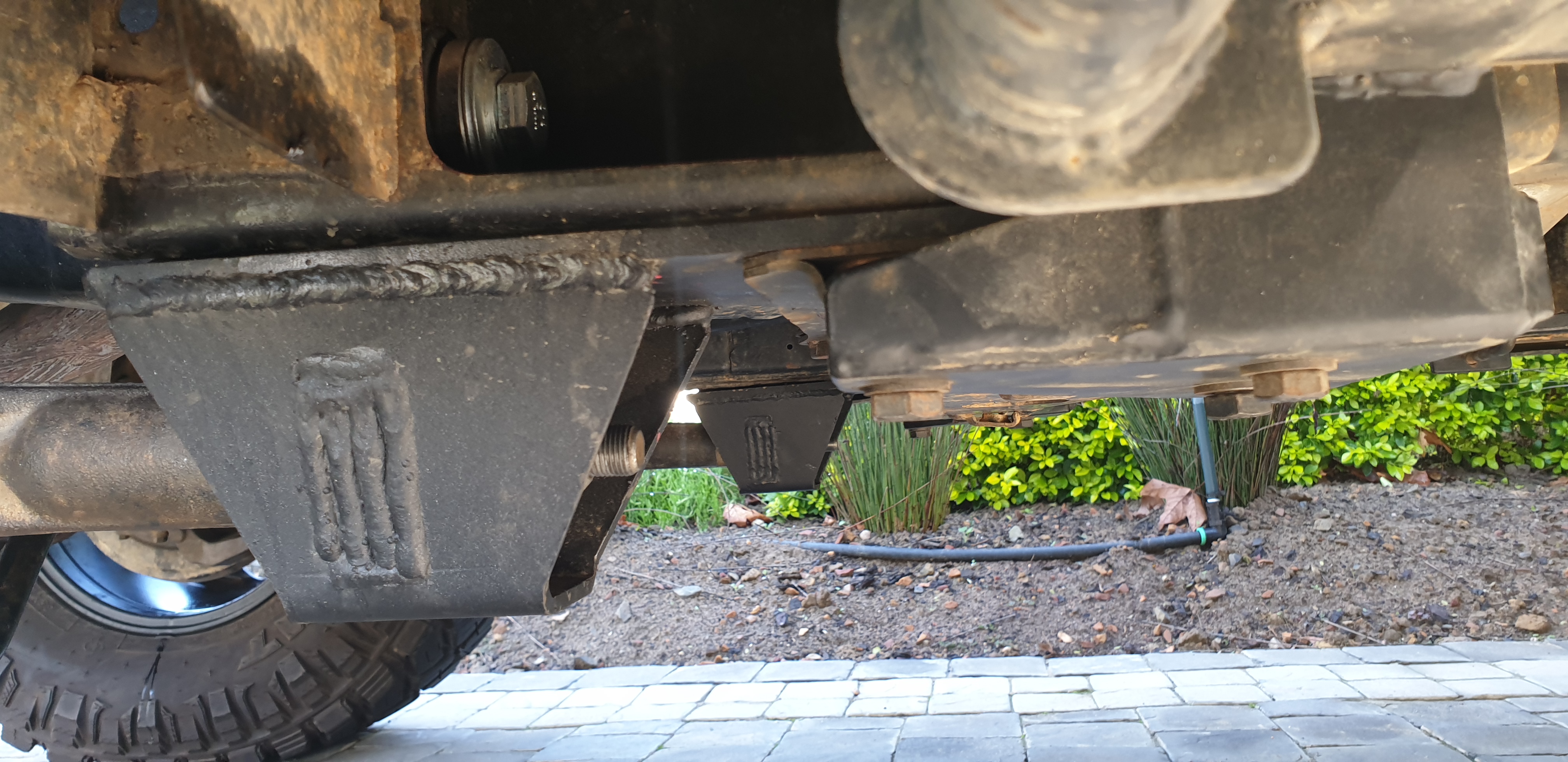

In closing 2 comments on fitting the Drop Boxes:

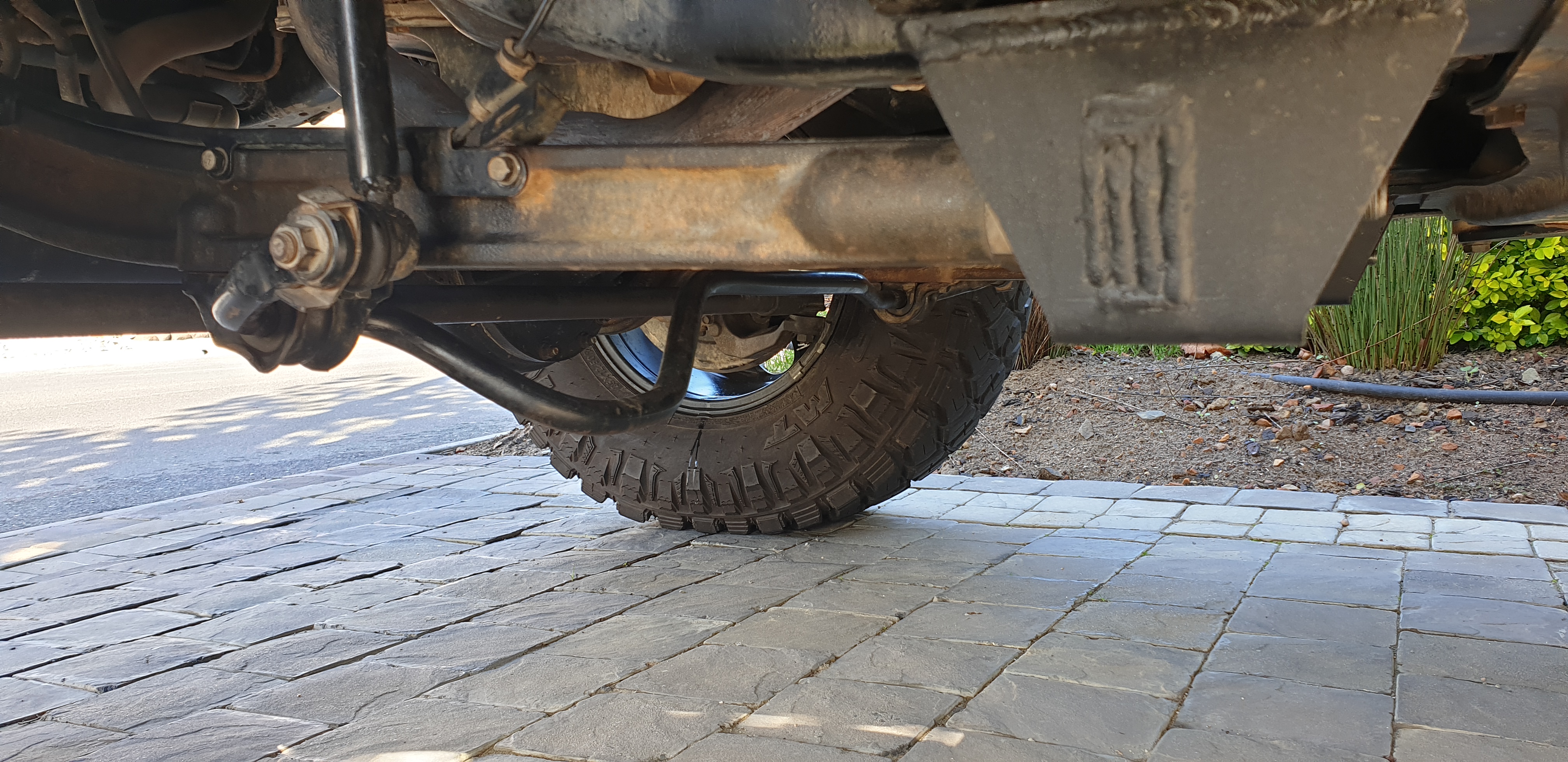

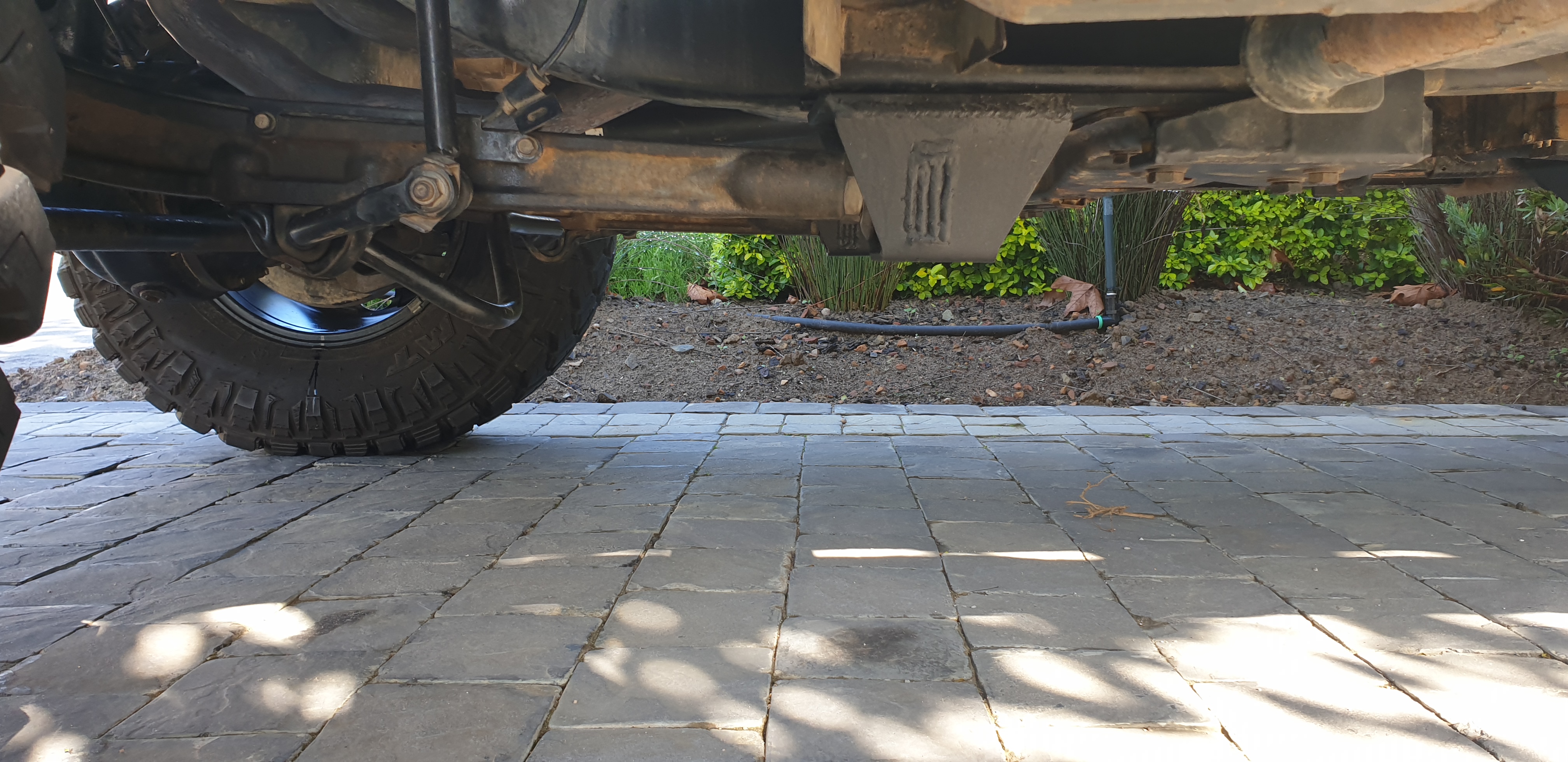

  • The 4 inch drop boxes do not stick out below the body of the vehicle as much as you would think when you see the unfitted boxes. They maybe have a 2 inch profile that sticks out, but they are not the lowest part of the chassis and there would have to be very specific situations where they could fowl you up on an obstacle. If this is a concern then you could always opt for 3 or 4 inch sway bar setup.
  • When you fit the boxes you will also need to extend your sway bar links or buy adjustable sway bar links. You need to do this to keep your anti-roll bar in the correct orientation after fitting the boxes because the height of the sway bars drop away from the chassis to make them more horizontal, which is what you want, but this has an impact on the sway bar links.

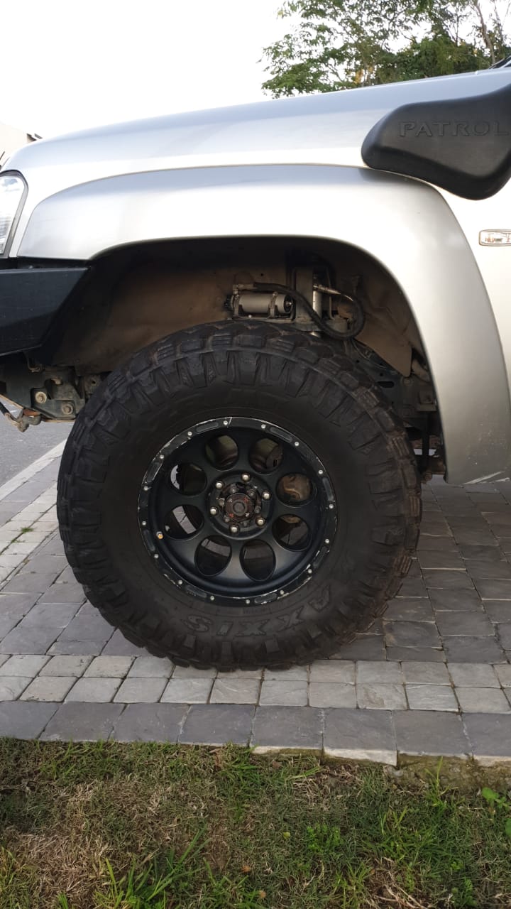

A final, final update....
Today I had a 30mm and 20mm coil spacer from Terrain Tamer fitted to the rear and front respectively. I did this to give my vehicle a full 2 inch lift and to level it out after I took the measurements to determine the final lift after the suspension fitment and saw that I was short a few millimetres and not running level.
The TT spacers fitted in perfectly. I was worried that I would have a problem fitting them with the existing Boss Coil Tower Braces, but that proved to not be a problem.
Cheers
Hugh

I would like to know what wheel offsets are needed so that 35s don't rub on full flex with a 3inch lift? Are there any beadlock rims available that you would recommend?
Re: Upgrade to 3" lift on series 4 GU 4.8 Station Wagon. What do I need?
I had 16" 8j Mickley Thompson rims fitted with 35" Coopers on my 4.8 & I currently have 35" Mickey Thompson Baja Claws fitted on std 16" wagon steelies(I think they are 8j) on my TD42...
On both I adjusted the steering full lock & no more issues, both have 3" suspensions.

As per request from Kyle Reeves, I have updated the lift spec's after having added the spacers
TT (Fully Loaded)/TT Unloaded/Stock/EFS (Airbags @ 1bar)/spacers:
Front Right: 610/615/570/590/635
Front Left: 610/605/570/590/630
Rear Right: 580/585/554/565/615
Rear Left: 580/590/554/565/600
On average, I now have about a 2.5" lift back and front after having added the spacers. as expected the right rides a bit higher to cater for the driver sitting on the right.
