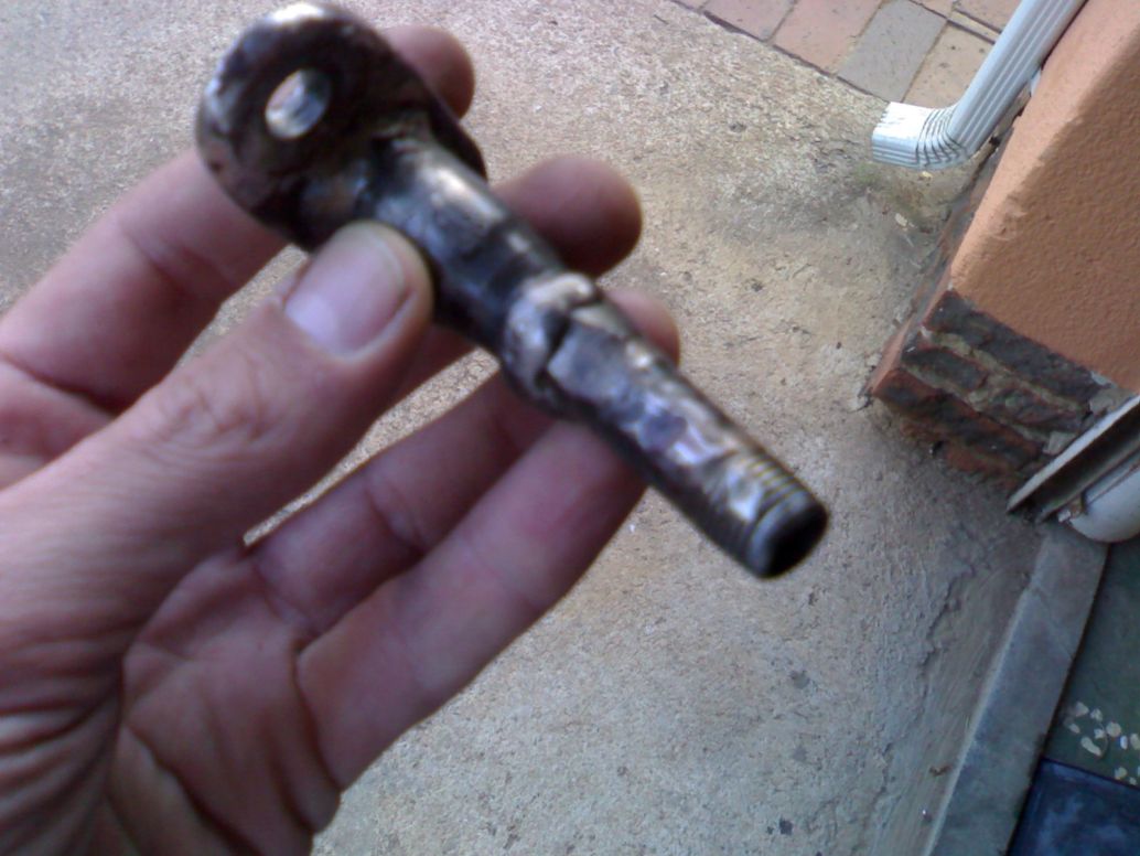

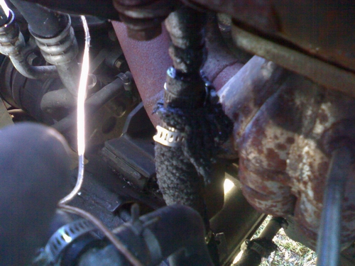

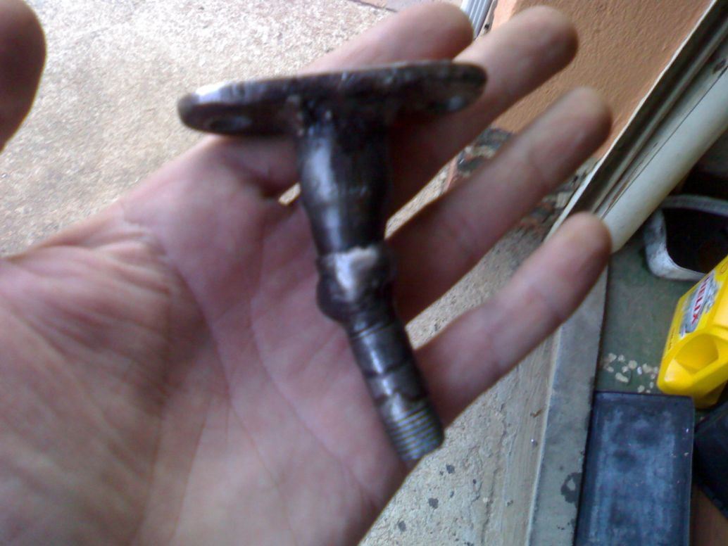

quote....Jongosi also sweats oil from the same spot.
I found out that my turbo was fitted by CRD somewhere in Pretoria area. I must be honest but if this is their workmanship .....then I'm NOT impressed.... and if this was not done by them ....I please accept my apologies.
The steel flange bracket that bolts onto the underside of the turbo, connected to a hose which takes the oil back to the sump is where the problem lies. I'll take photos and post them here. But the bracket has been brutally modified by someone brazing a piece of :surprised: threaded pipe :surprised: :think: where the hose slips over and is clamped tight. Unfortunately due to the fact that the oil, like any oil should, works its way in through the threads between the rubber hose and leaks out all over the asbestos tape the have so cleverly wrapped the hose in. The only way I can sort this out will be to cut the threaded piece off and braze a new ridged piece of pipe, similar to what the old brass garden hose clamps used to look like, on so that when the hose is clamped tight it will not leak.
I wonder if your is the same as mine, as there should not be much if any pressure for the return oil into the sump, and no other reason for it to leak !! but I can understand why the oil leaks through the threaded/dented, gauged out piece of pipe.
look just above the hose ....you can see the brazing bubble where it is brazed at an angle too
turbo bracket.jpg (160.16 KiB) Viewed 1640 times
look at the disgusting finishing off of this ...... I can't think of a nice word to use !!
sorry about the lousy photo....but its about the same as the quality of the workmanship of this flange bracket
