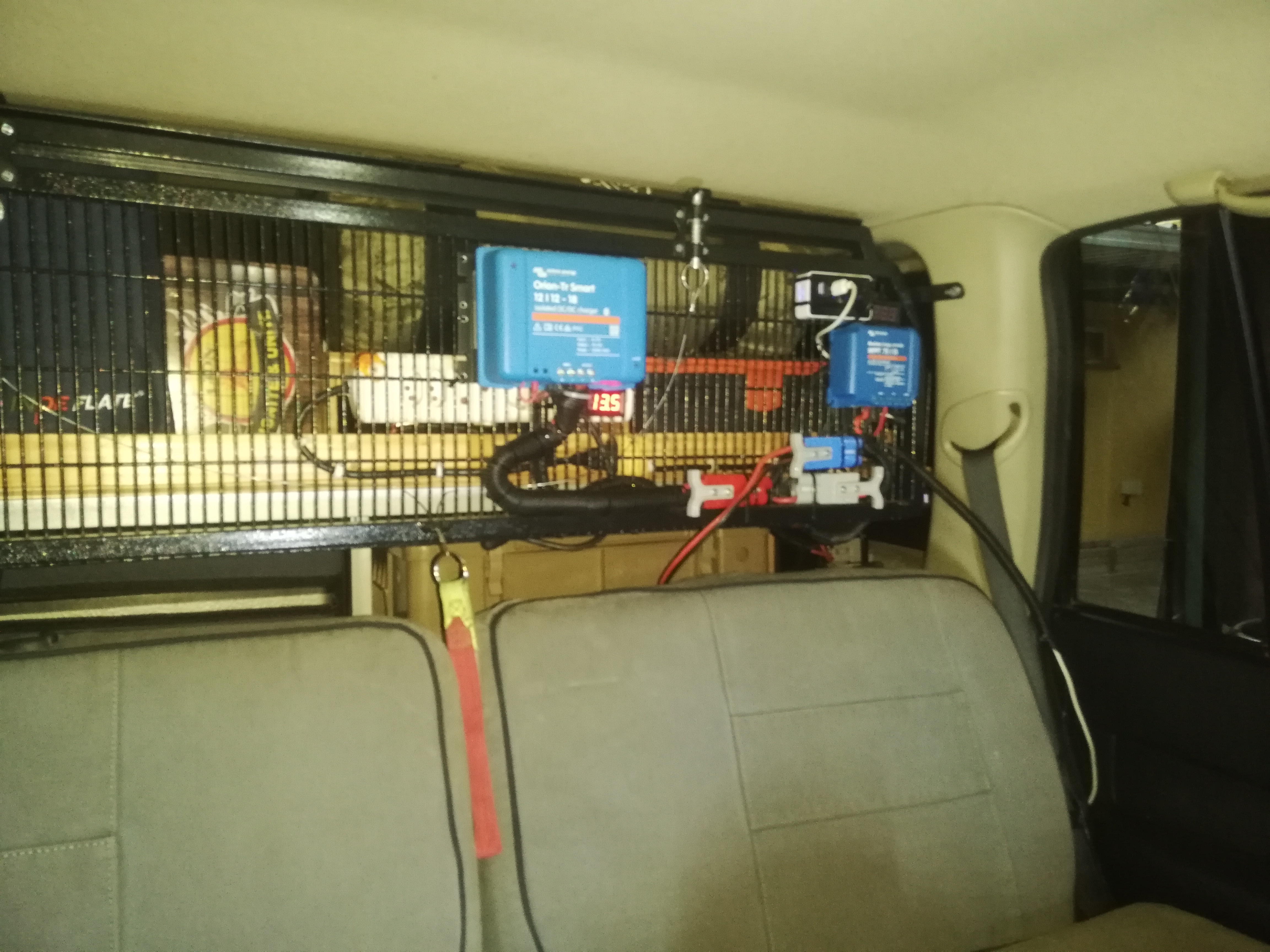

I use Victron charge controllers. I use two seperate units, one an intelligent DC to DC 20 amp (https://www.victronenergy.com/dc-dc-con ... s-isolated) unit (unit charges both my two 120 amp Discoverer AGM/Gel hybrid auxiliary batteries)
and a second intelligent Victron 15a MPPT solar controller (https://www.victronenergy.com/solar-cha ... s/mppt7510) for solar panels.
The reason for using two seperate units instead of one single unit is redundancy. If one fails, you at least have a form of back-up. If your DC to DC charger goes wrong you can at least use you solar charge controller in the interim.
My next next option is to buy an intelligent Victron 500a shunt. The shunt is the ONLY accurate unit that can ACTUALLY MONITOR and measure your battery state.
(https://www.victronenergy.com/battery-m ... tery-shunt)
The Victron Smart Shunt can measure actual amps and will give a history of how many amps reached the battery and when and also what the current amp storage the battery holds it can be mounted anywhere (out of sight even) on the earth lead of the aux battery.(
All intelligent (Smart) Victron units communicate to my normal Smart Phone via a Bluetooth App. It does not have lights like the NL unit that still keeps you guessing by just showing voltage, not amperage.... Do not put ithe Apps on a seperate phone on the dash, if it is on your normal phone, then you always have it on you, it can't easily disappear and it is more likely to always be charged...
Victron is simple straight forward and polarity protected, there is no trickery (that is all inside the box and you cannot access it), not much can or will go wrong. With a 5 year warrantee, you cannot go wrong
This is my current set-up, fix onto the security/safety divider between the load bay and rear passenger area:
I got my Victron stuff from this guy in Kemptonpark (near Pieter Connan's house). He is reasonable with his pricing, VERY clued up and his service is just streets above your generic 4x4/camping type equipment salesman at most leisure/camping/4x4 outlets - http://solarchargesolutions.co.za/
