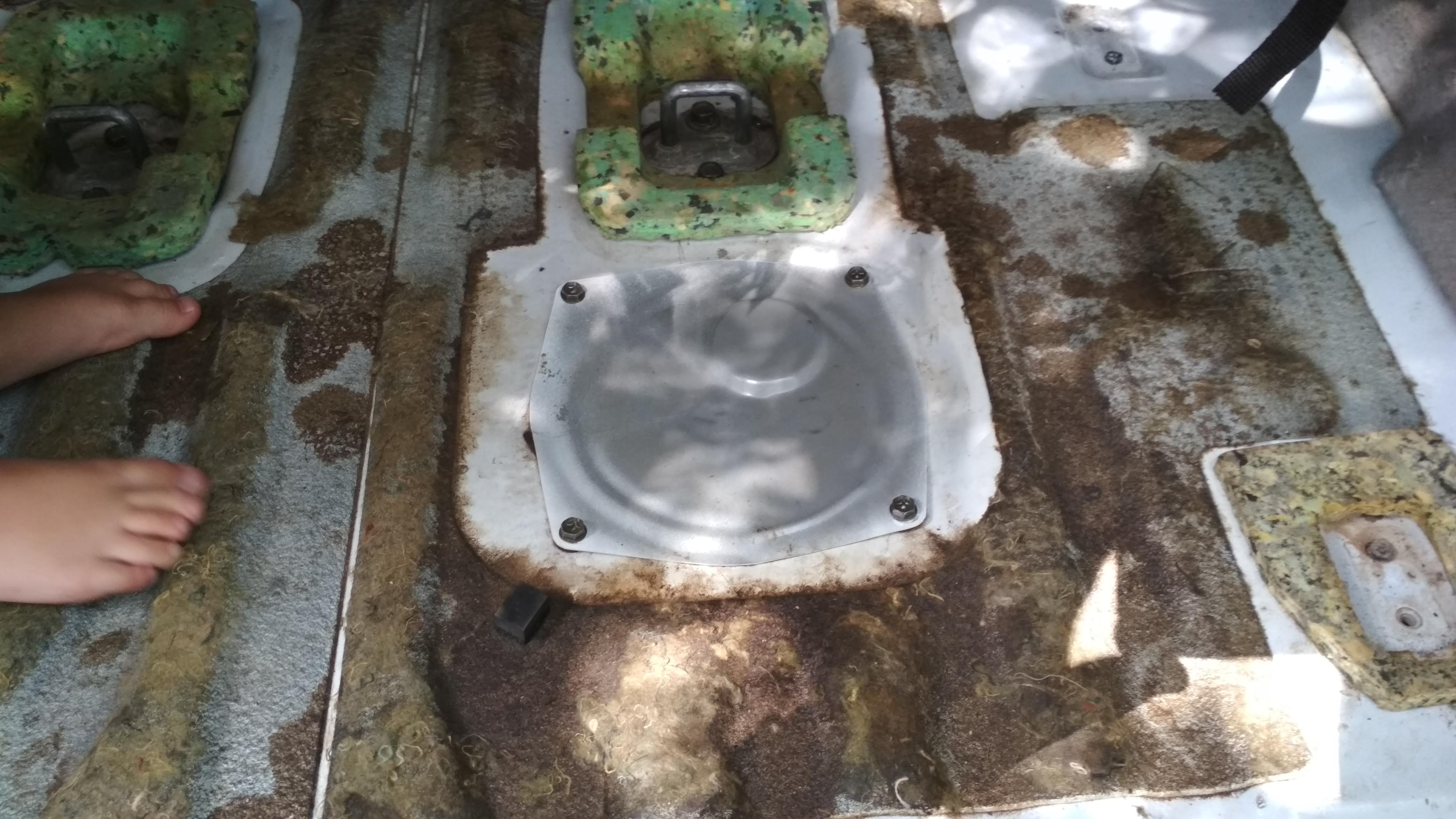

Fortunately there is an axcess cover in the rear load area. Lift the carpet, and look for a cover held on with three bolts. Remove the cover and you will see the tank's top cover.
Unplug the electrics seperate the hoses, remove the bolts and lift the cover. The fuel level sender and pump will come with it.

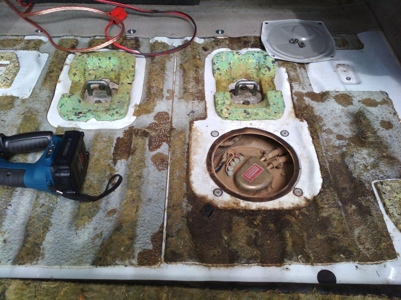

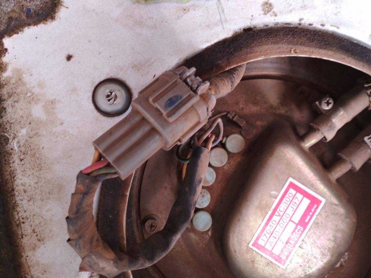

The carpet comes out with the tie downs removed.
Removing the cover reveals the pump assembly with fuel lines and wiring.

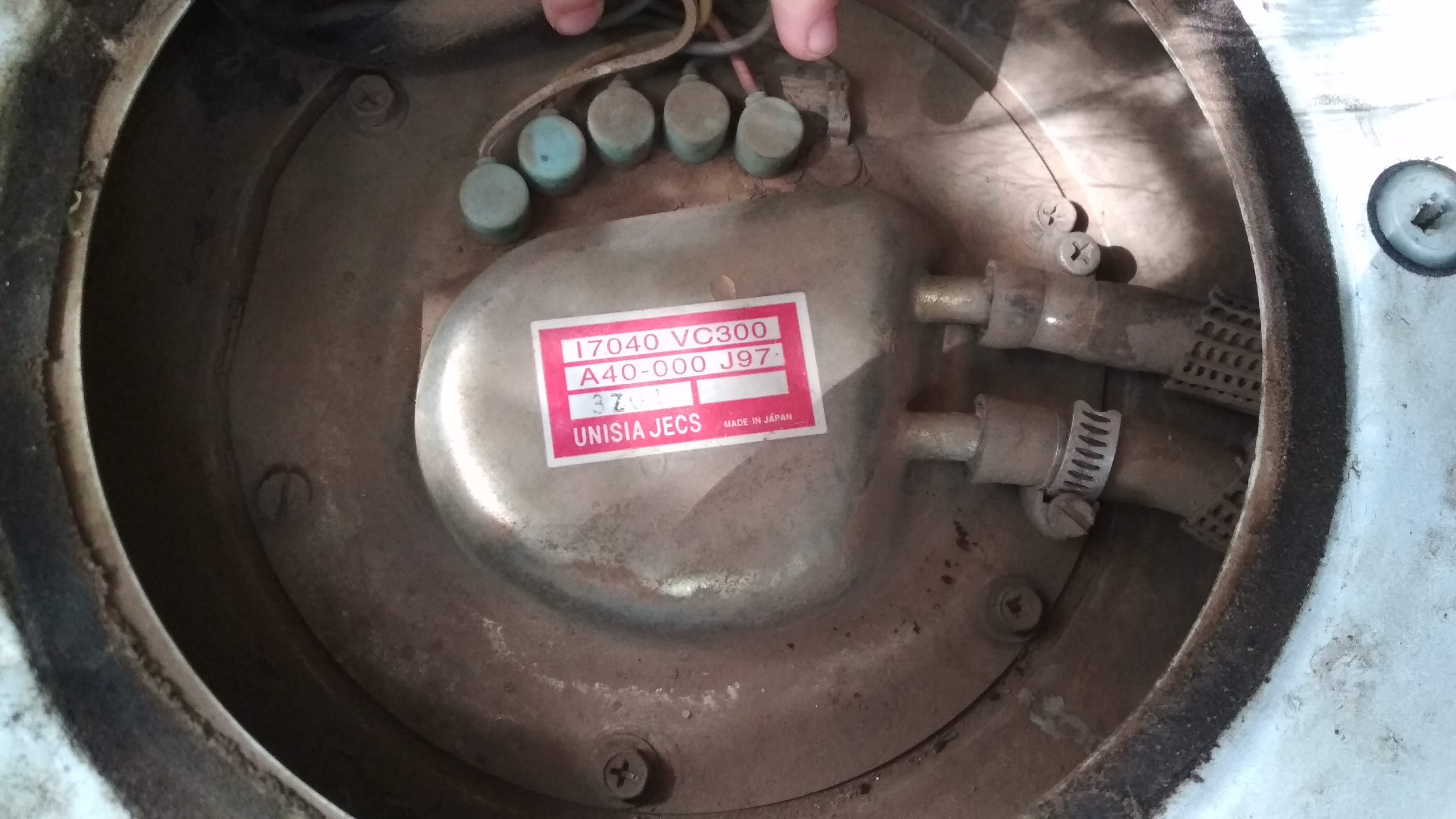

There is just one plug for the fuel pump and float. From this plug I could see the tank has been removed before. Someone struggled to disconnect it.

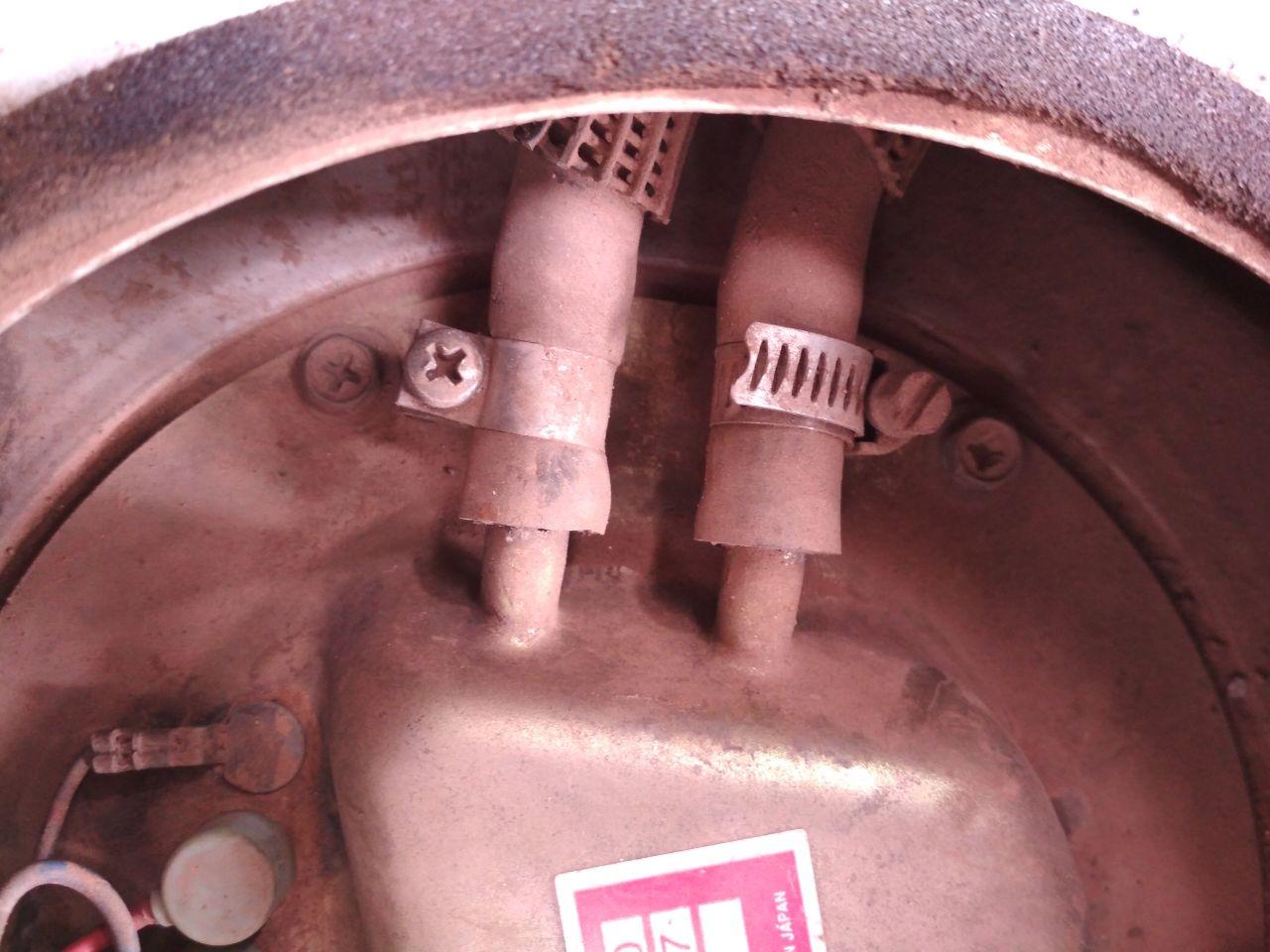

If you're going to replace your pump, do not make the same mistake and disconnect the fuel lines before undoing the screws holding the pump assembly in place. If you do, and there is any pressure in the tank your precious fuel will come pouring out in large quantities. Undo the screws, and then remove the fuel lines.

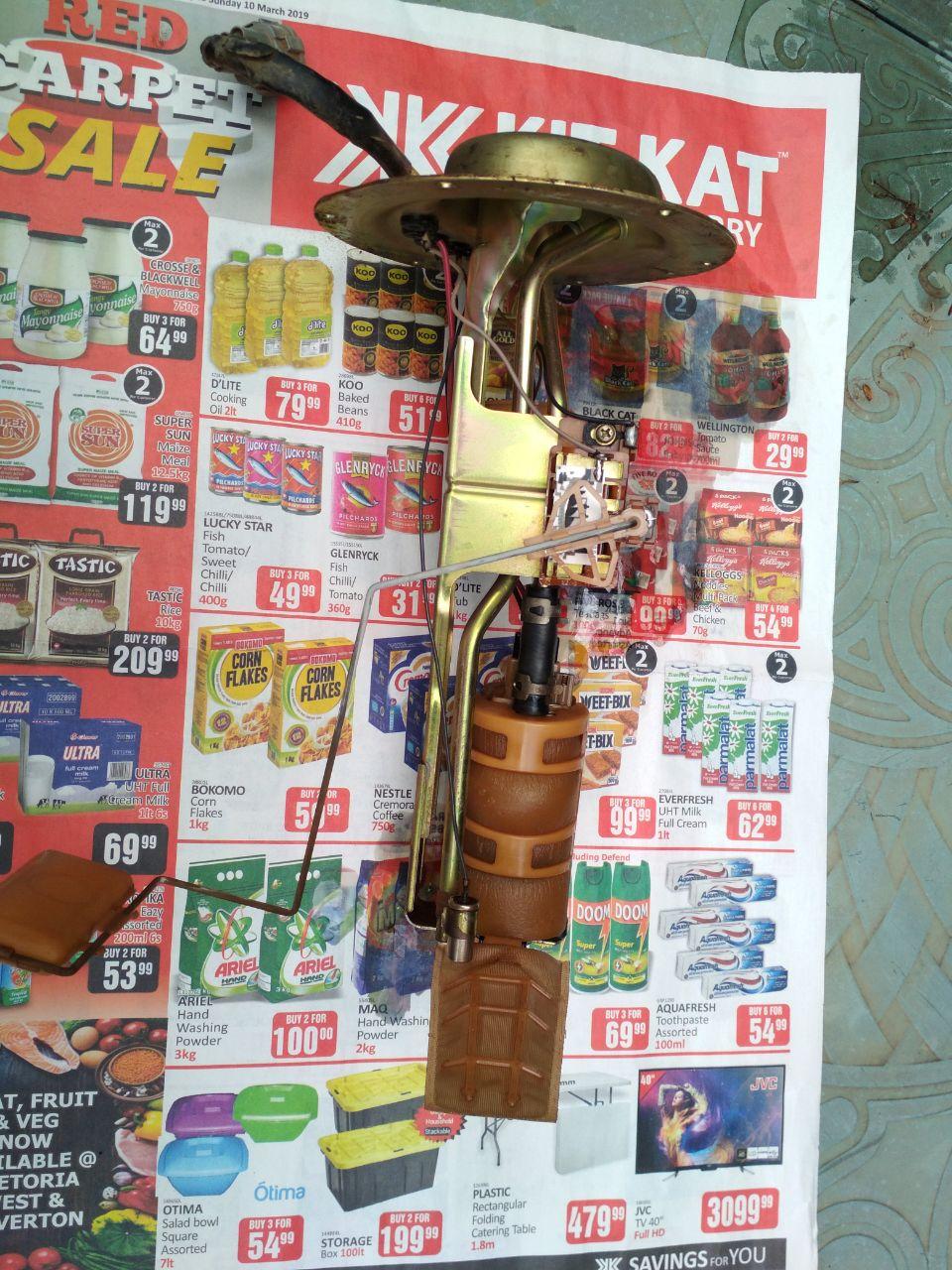

The pump assembly with pump and float.
