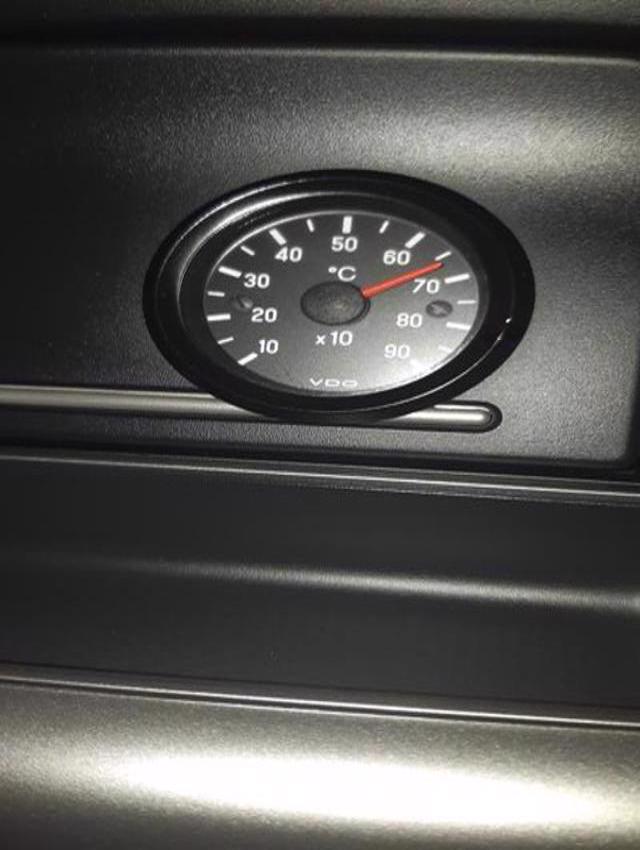

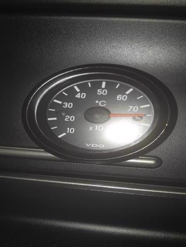

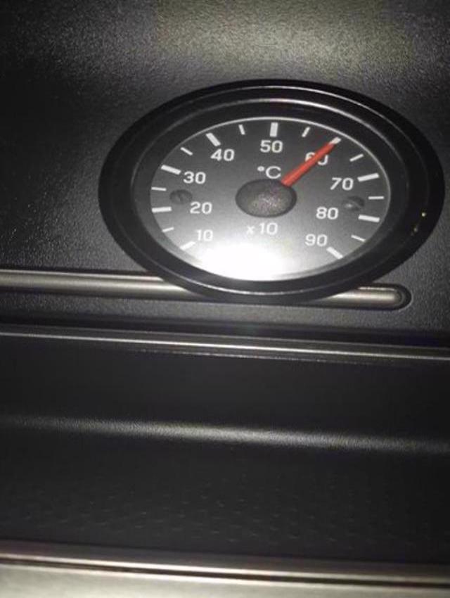

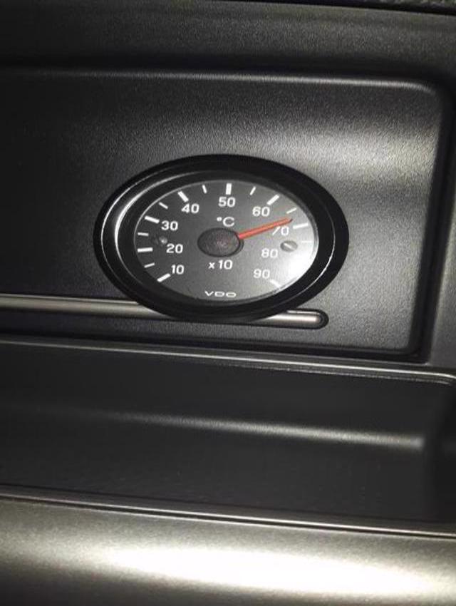

So tonight I did some testing, thinking I would drive conservatively just to see what it really looks like at various speeds
At 100 km
100 km.jpg (49.56 KiB) Viewed 5872 times
At 120 km
120 km.jpg (53.46 KiB) Viewed 5872 times
At 140 km
140 km.jpg (54.34 KiB) Viewed 5872 times
at 150 km
150 km.jpg (55.28 KiB) Viewed 5872 times
When keeping constant speed with small throttle input it fluctuates between 600 and 650.
Depends if you’re going up or down a hill..
So in light of info supplied I guess my EGT are okay within civilized operation.
