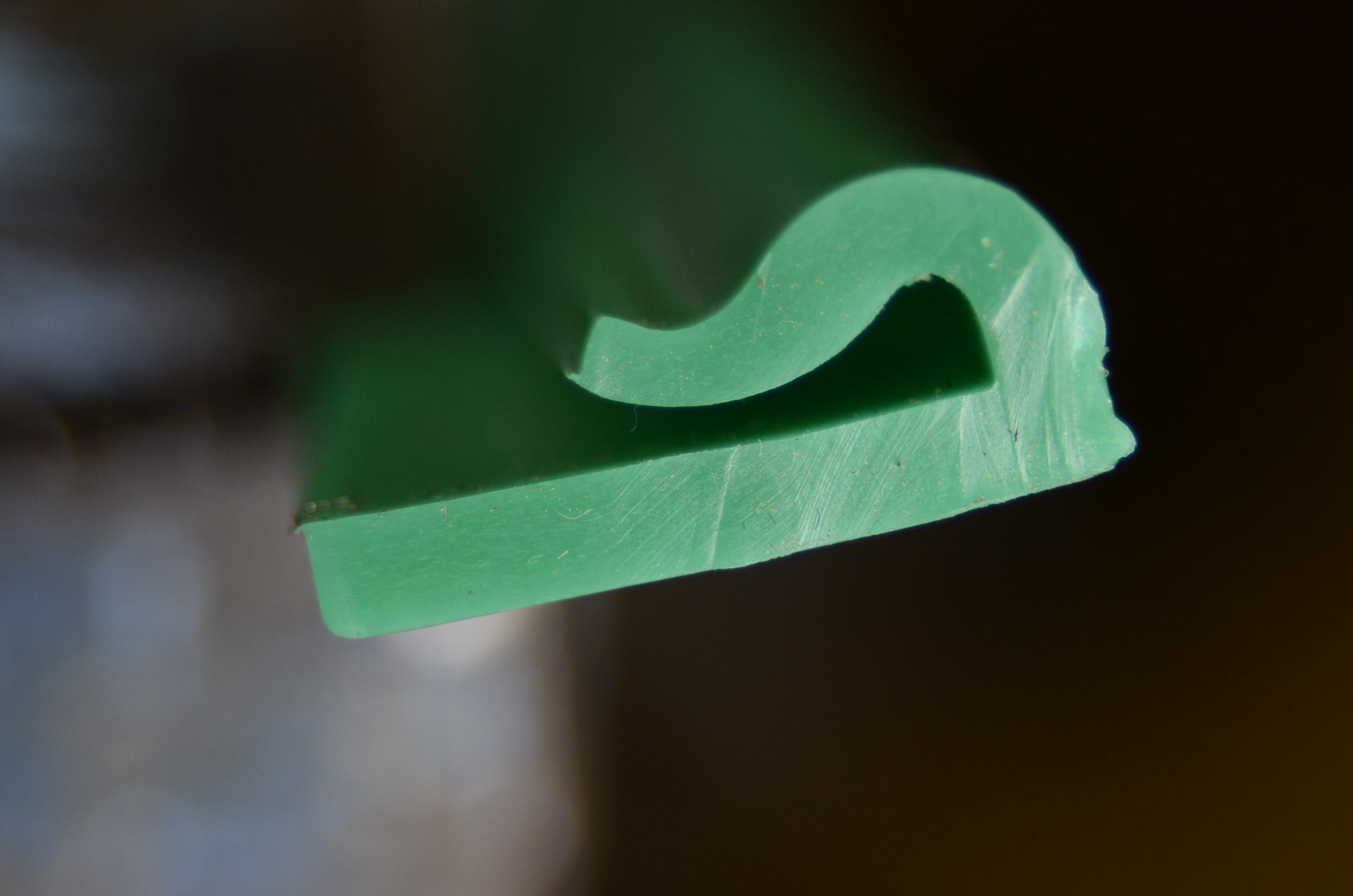

This is the teflon strip the drawers run on.
For those that are interested, it's available from Nusaf Danymic Tech, who have branches in woodmead and Belleville, at about R26/m
This stuff works unbelievably well at reducing friction>For those that are interested, it's available from Nusaf Danymic Tech, who have branches in woodmead and Belleville, at about R26/m

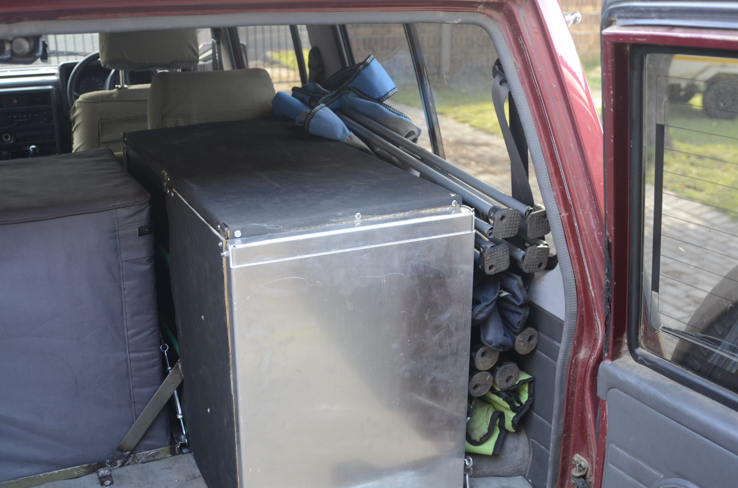

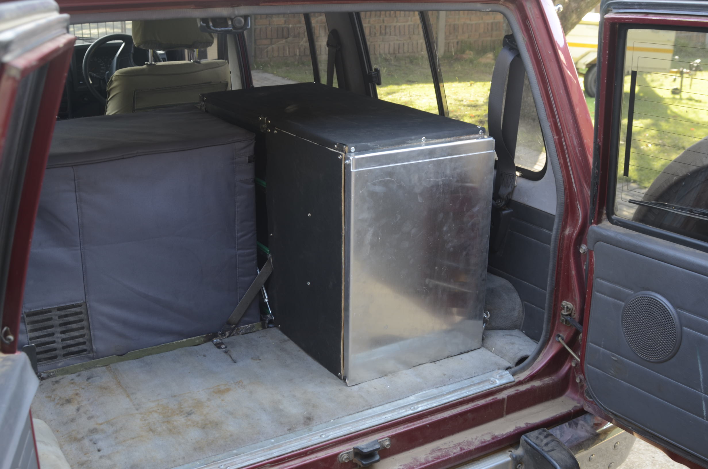

Over the weekend I covered it all up.

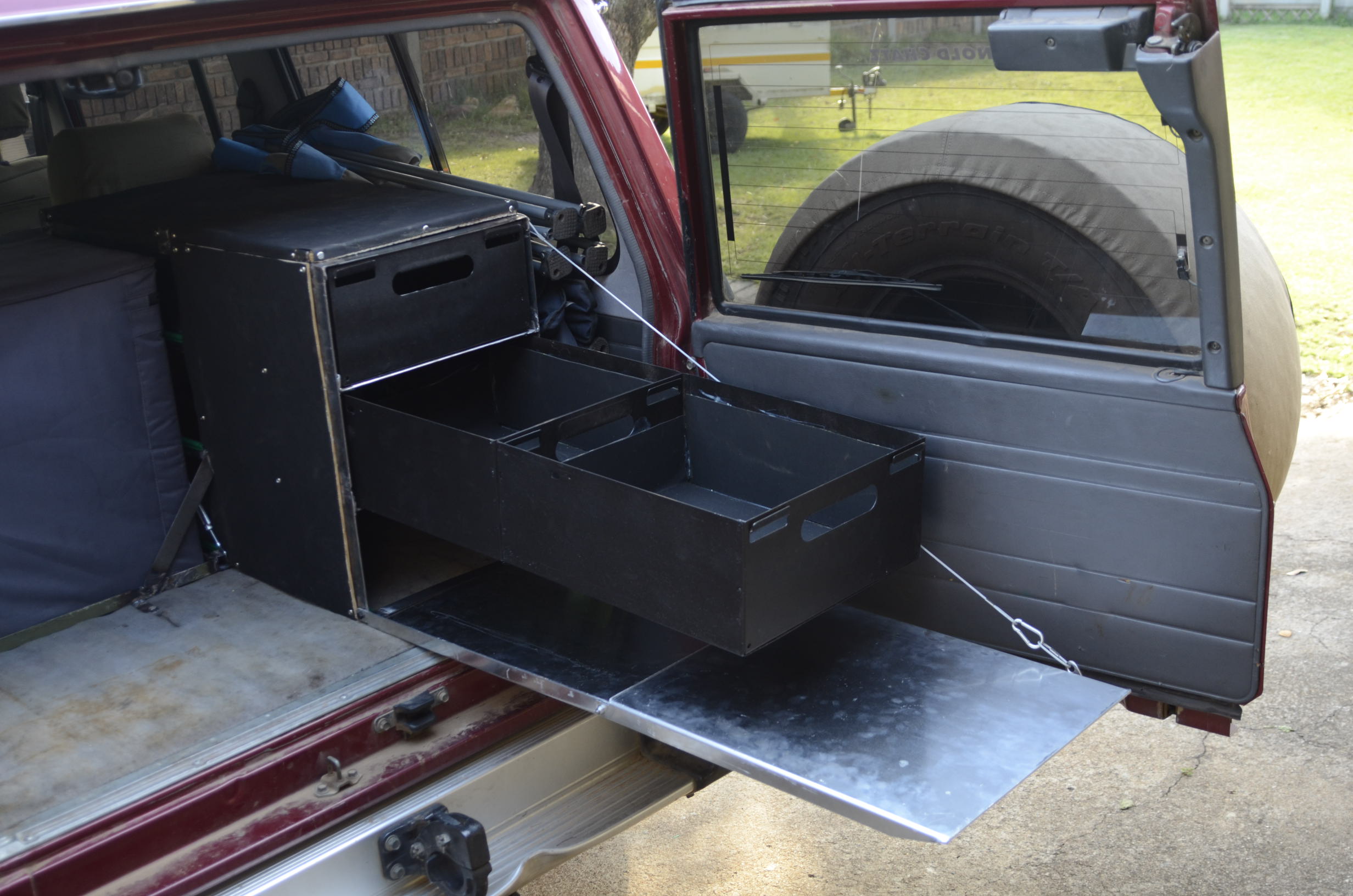

The original plan was to use galvanized sheet, but I discovered that i only had a small pice left, so I made do with what materials I had. The right hand side is galvanized sheet, covered with insertion rubber, the left hand side is covered in 4mm plywood covered in insertion rubber (I did not cover the area next to the fridge), the front (closest to the back seat) is covered in Masonite, and the top is a 15mm melamine, also covered in insertion rubber, so that things can be packed on top. It has hooks on one side and two screws on the other, so it is quick and easy to remove.
four folding chairs fit neatly next to it: Tha table is held open with a cable:

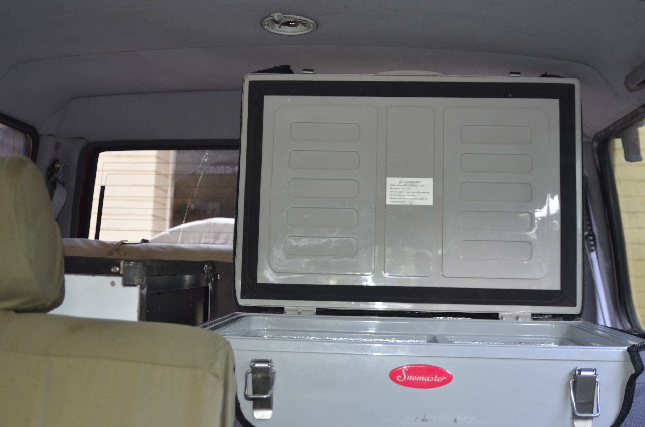

Fridge open:
Fridge open:
