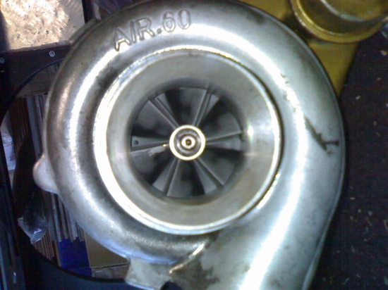

Not only send a pic of the turbo but the pump is the important one.The bigger turbo make sence to cool things down.The bigger turbo can deliver more air,so for the same amount off fuel and more air ,the egt wil cool down.

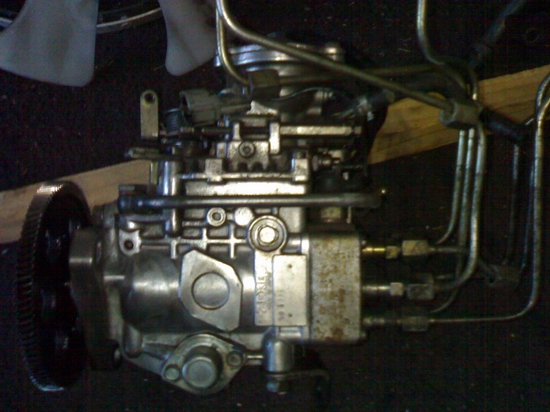

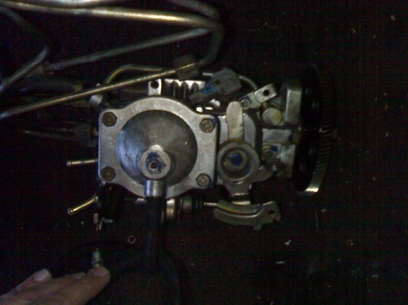

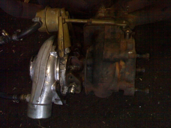

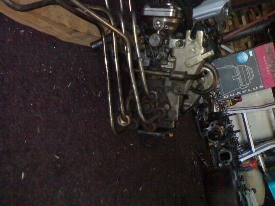

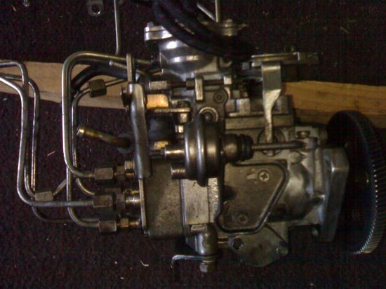

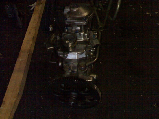

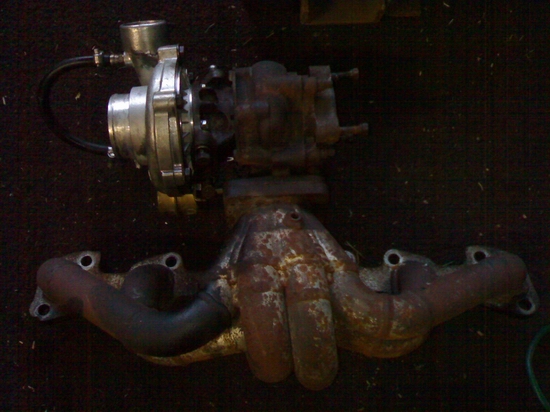

Ok...I took some pics, unfortunately Swambo came home late (had to pick up laaitjie from ouma due to the school strike.... :fire: ..)so I had to use my cell phone cam which is not as good as hers.
The pump is a ZEXEL, I couldn't see a model number, but saw this stamped on next to the name 50733. If there is anything else you need let me know please.

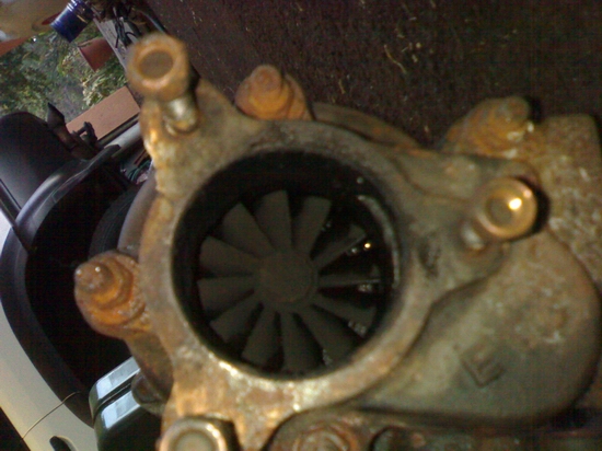

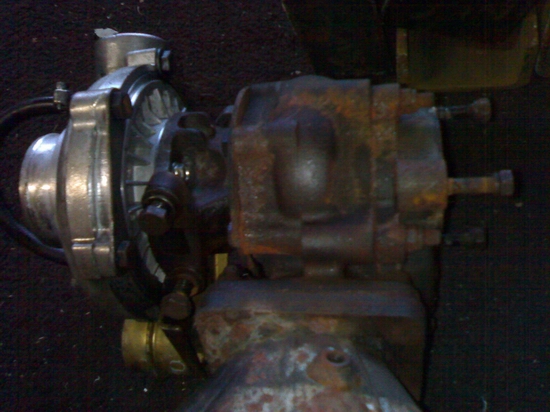

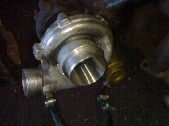

This is the turbo. Its a Wa-Line Industies. T04B.06-2

Here is one, showing the nut brazed onto the branches where the EGT probe sits
Can I run some diesel through the turbo to clean out the oil, or is that not advisable. I want to rinse out the intercooler with diesel too.

Cedric,the pump are the right one,so you can get it cheked out.Look for a number on the pump that starts with 10 or 11.It will make no diffirence it wil only tell me how good power you will make.The nr. are on a sticker on the lower end of the pump.
Clean your parts with a enjin cleaner or parrifien,all of it cooler,turbo...
Asetone sal ook werk,maar is baie sterk en moet met aandag gebruik word.Hou dit weg vanaf jou kar se bakwerk.
