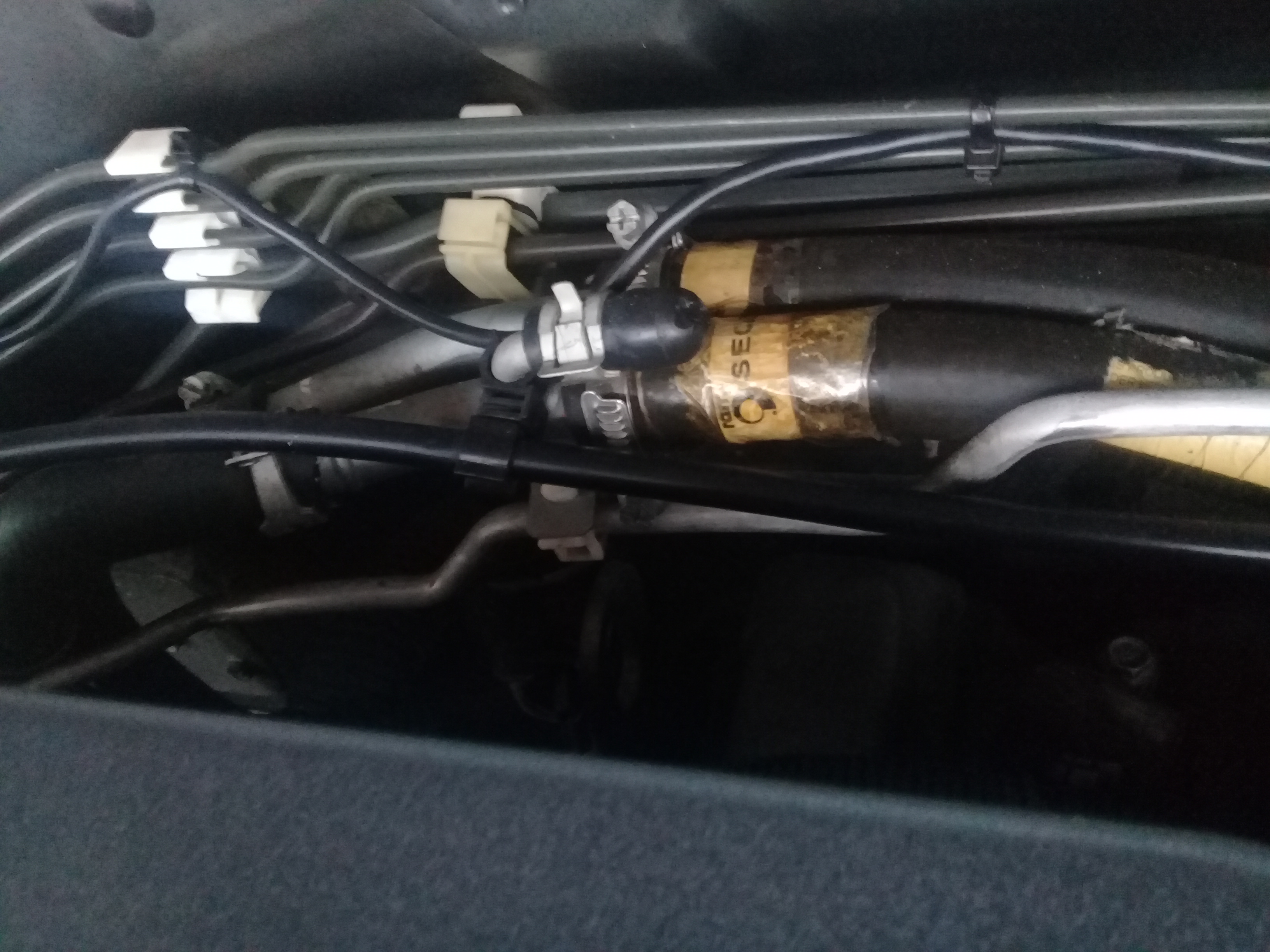

Re: Over heating problems
Right at the back against the fire wall is a bleed pipe on the 4.8. Its not a srew. Just blanked off with a cap. But its the highest point on the water system. I bled mine with it and there is no issues.
My reason for bleeding was not overheating but a pipe that needed replacement. Hence I lost water and had to refill.
