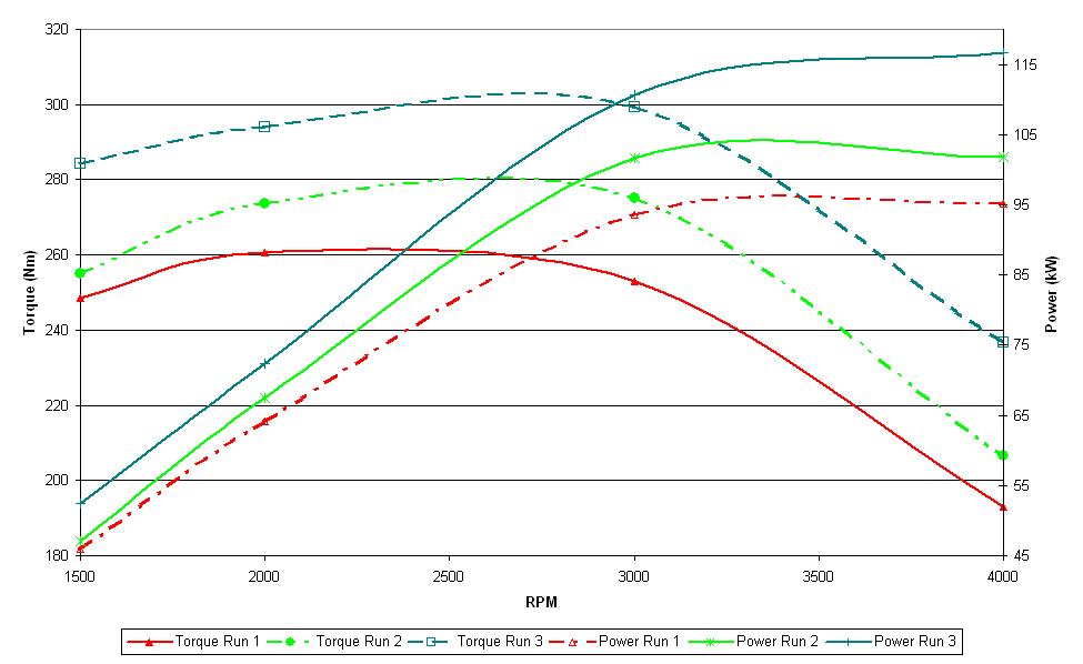

I have put together this comparison graph as an update to the previous one after making a few changes. It would be interesting to know how the numbers look like from other 4.2l petrol Patrol's that was on a dyno recently.
Run 1 = After installing the OTA air filter no tuning yet.
Run 2 = Power tuned with OTA installed.
Run 3 = Petronix electronic ignition installed and new ignition coil (Bosch).
The rotor/cap and HT leads were replaced in February so they are in good conditions.
Cheers
Rudolph
Cheers
Rudolph

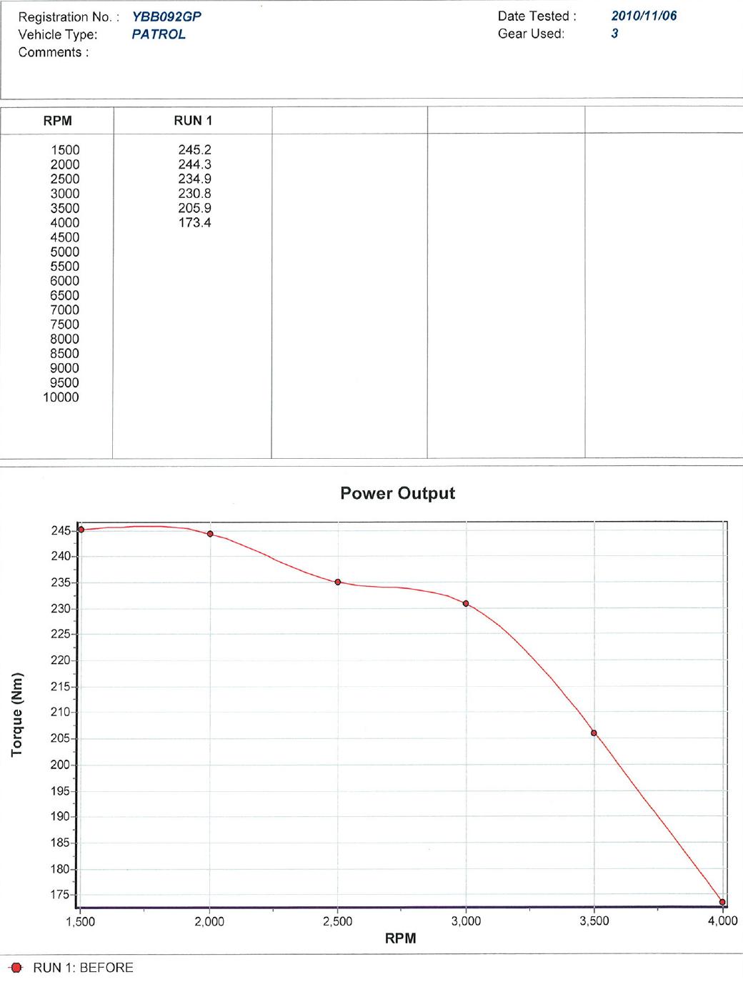

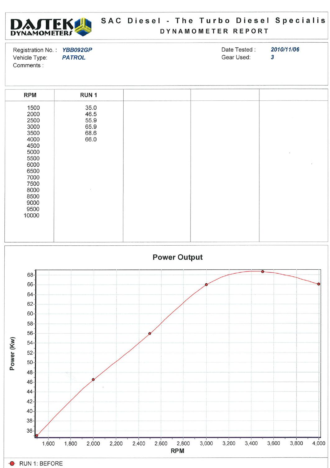

Here are the curves my car acheived at the Dyno Day arranged by Uncle Mac some time ago, at SAC in Centurion: Unfortunately I suspect these are meaningless, since these figures are at the wheel and not corrected for altitude, while I guess yours are corrected for altitude and friction.
For any meaningfull comparison these would probably have to be measured on the same dyno, on the same day and by the same operator.
Also, I beleive that at the time my vacuum advance wasn't working and this is also before the snorkel and electronic ignition.

I'm still very happy with the weber carb and trouble free from installation. Regarding the fuel consumption, average is for town/open road/off road is 4.6km/l. Keep in mind the roofrack with spots/mud tires/lifted suspension. It was just serviced last week and the latest dyno results were power 118kW@4000rpm and 302Nm@3000rpm torque, they converted the numbers to the flywheel.
