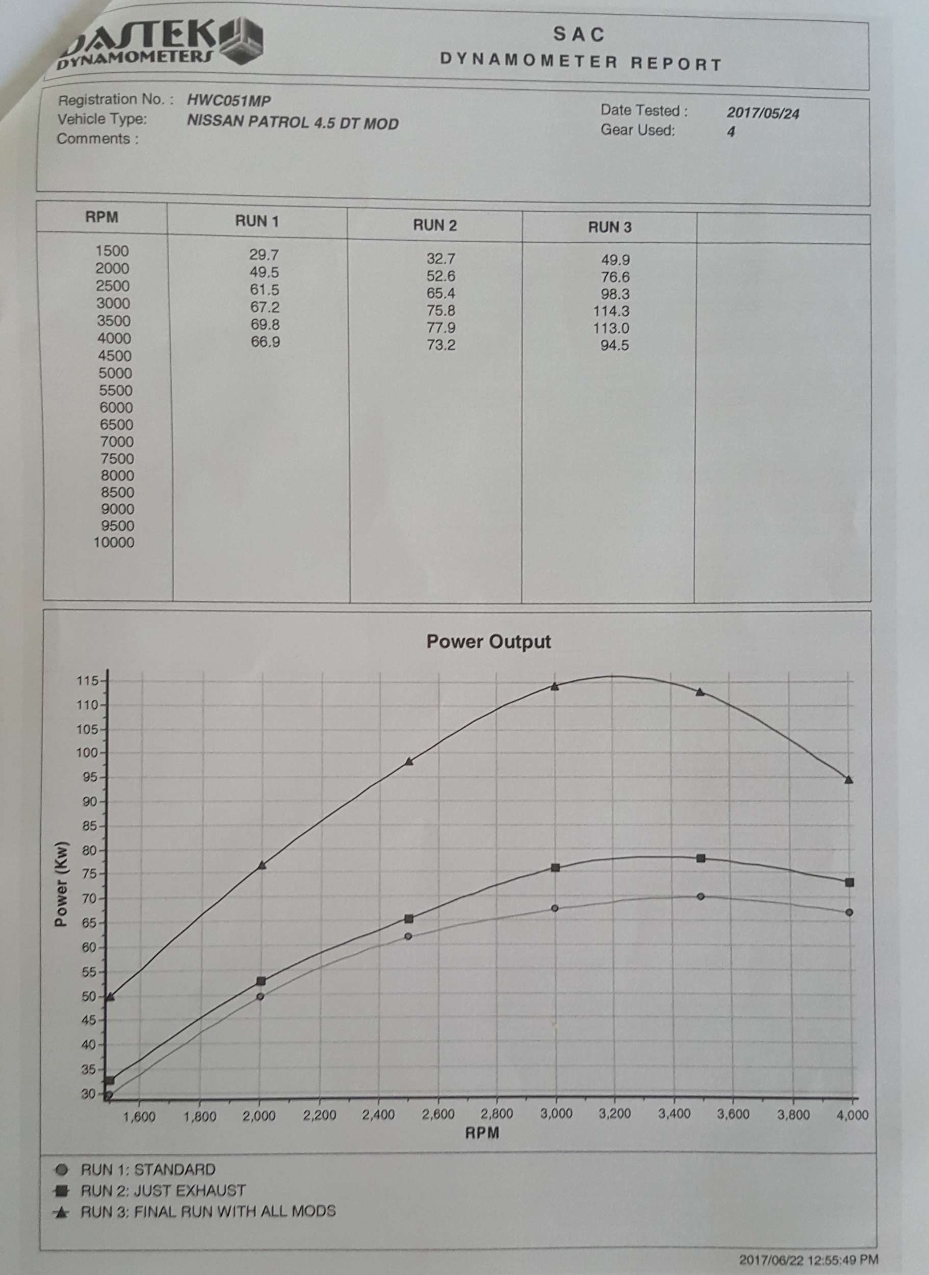

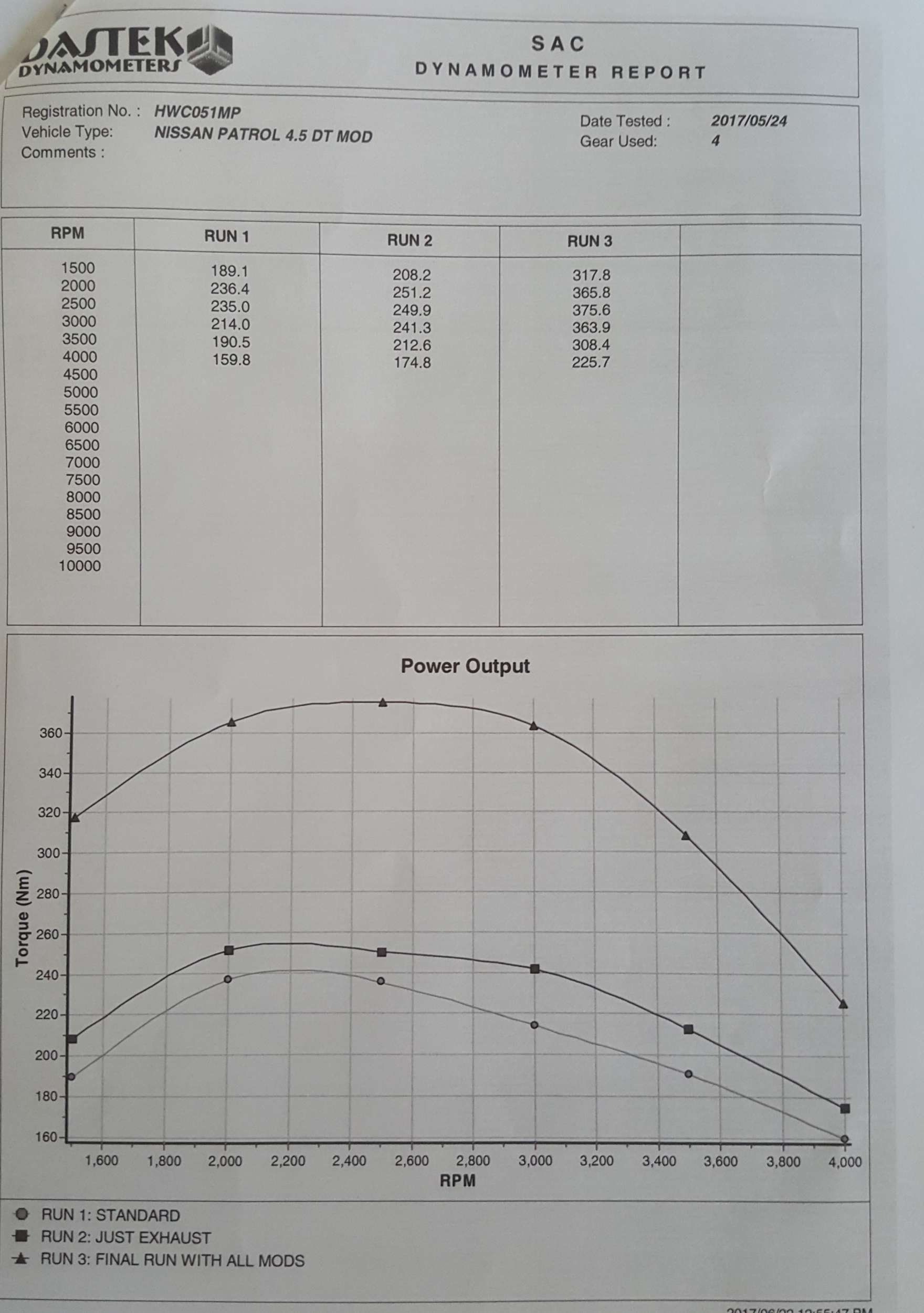

I did n dyno run on his pickup stock standard without ever being fiddled with, I then installed the famous Viper 3” exhaust and did another dyno run to see what the gains are.
In a nutshell, we gained the following results at the rear wheels. Please note that the dyno runs were done at SAC Centurion and there are not calculated figures here……its raw power on the wheels.
Standard power: 70Kw @ 3,500rpm & 236Nm @ 2,000rpm
Exhaust only: 78kw @ 3,500 & 250Nm @ 2,500 (Gained 11% Kw & 6% Torque)
Exhaust and tuning: 114Kw @ 3,000rpm & 376Nm @ 2,500rpm (Gained 63% Kw & 60% Torque)
The kw and torque curves really speak for themselves and there are other very important benefits from this.
1. The torque curve is very flat and you now have maximum torque between 2,000 and 3,000rpm where before it was only between 2,000 and 2,500rpm. This gives you a more usable torque than before. You also now have 129 torque more on 1,500rpm which is really ideal.
2. The EGT’s run very stable and very safe. The alarm is set to 680deg pre turbo but I could not even get to 650deg under extreme loads and 520deg was the highest recorded temp on the dyno.
3. Overall the drivability of the vehicle has changed completely. You can now actually enjoy driving it!
