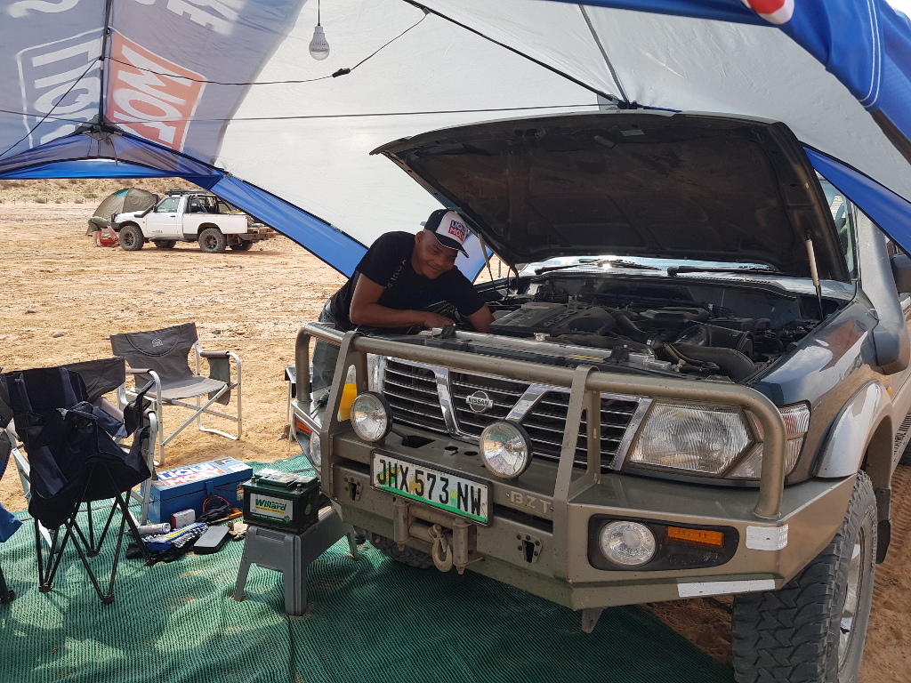

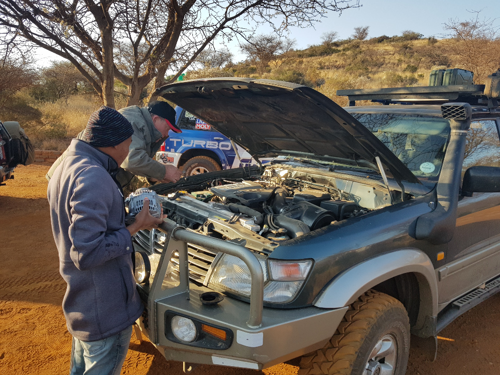

The next morning was not a fantastic start. Started the truck, and immediately heard a horrible grinding noise when the truck was running. My immediate suspicion was the alternator bearings. This was later confirmed by Graham (they had also overnighted at Redsands. Luckily, and because I have had an alternator drop me before, I had a spare with me, and Graham assisted me in getting the thing installed.

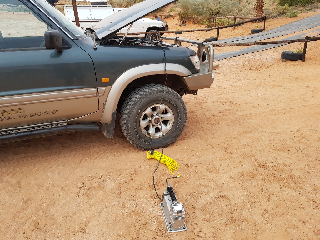

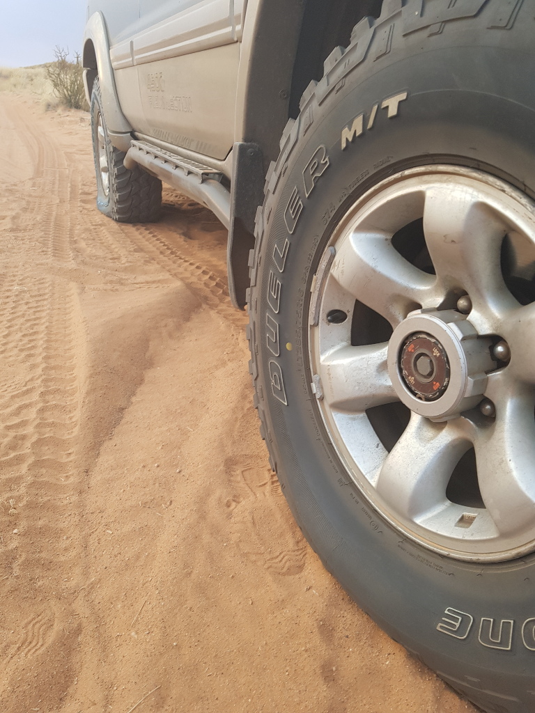

Group arrived around 13h00. We made camp on the pan, and headed out to ride some dunes. Great fun, once I had my tyre pressure sorted. Don't really have any photos of the dune drive, as I was driving. But did get some good video footage of a few other folks' Patrols hitting the dunes. Will edit and add links to a few YouTube videos once I get around to uploading them.

About 10km from Ashkam, my sub-tank and battery warning lights came on. Stopped in Ashkam, measured alternator voltage, and discovered that my spare alternator had failed. No autoelectrical people in Ashkam, so after a quick phone call to Graham at Goerapan, I heard that he had a spare alternator, and if I could get back there, we could figure it out. According to him, I'd have about 40 minutes of driving time on battery only before my ignition, fuel pumps etc started failing as the battery ran flat. I was about 75km from Goerapan at this point in time, so 40 minutes was probably about as long as it would take to get there... Arranged that if I did not pitch up at Goerapan in about 50 minutes, one of the group should head North on the Ashkam road to come and fetch me, as this would mean the truck had left me next to the road... I switched off the fridge, over-rode the smart controller for the second battery box so that I had two batteries connected in parallel, and then drove hell for leather for Goerapan. Time was of the essence, so I drove hard. I don't think I've driven the truck that fast before when it has been heavily laden, but we got there. Everyone was playing in the dunes, and I was at the camp-site with a partially dud vehicle, so I made some coffee and waited at the camp. We put in the other alternator again when Graham returned from the dunes, and I did a bit of battery maintenance with my solar panel for a bit, although the voltage did not seem to have dropped too much on the way back from Ashkam.

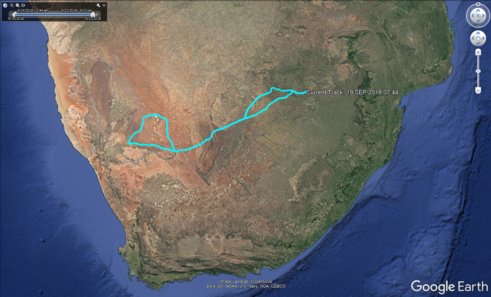

Decided then that I would continue with my Namibia trip, but that instead of heading all the way to Oranjemund (probably stupid doing that solo in a single vehicle), I'd head in at Rietfontein, head towards Aroab. Then down to Karasburg and out again at Ariamsvlei - a much shorter route. On the way, to the border, I passed Hakskeenpan, which was awesome to see.

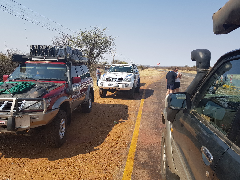

I refuelled in Karasburg, and made for the border. About 40 kilometres from the border, I ran into a couple with an overheating LandRover Discovery towing a Conqueror. I stopped to render some assistance. Their vehicle had overheated badly, and whilst replacing coolant and bleeding the system, the man had the bleed screw turned out to far. When the coolant burnt his hand, he jerked his hand away, resulting in the bleed screw being shot out somewhere in the engine bay... Carefully digging around in the engine bay, we eventually found the bleed screw. Filled up the coolant reservoirs with water and bled the motor. I opted to follow the couple to Upington to make sure they got back to civilisation safely.

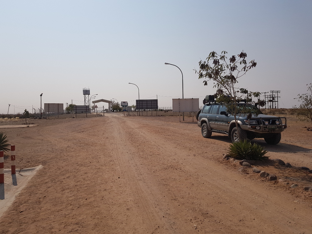

Border crossings at both Rietfontein and Ariamsvlei were quick, quiet and simple.
